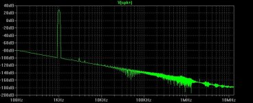

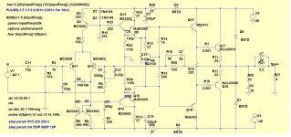

How do you think about the below circuit? Simulation shows super low THD. Is it realistic to build such an amp?
Fourier components of V(spk+)
DC component:0.0472742
Harmonic Frequency Fourier Normalized Phase Normalized
Number [Hz] Component Component [degree] Phase [deg]
1 1.000e+03 4.167e+01 1.000e+00 -0.13? 0.00?
2 2.000e+03 1.000e-05 2.400e-07 -69.14? -69.00?
3 3.000e+03 1.485e-05 3.564e-07 78.78? 78.92?
4 4.000e+03 6.596e-06 1.583e-07 177.53? 177.66?
5 5.000e+03 2.569e-06 6.165e-08 -111.33? -111.20?
6 6.000e+03 2.553e-06 6.126e-08 163.10? 163.24?
7 7.000e+03 2.560e-06 6.143e-08 171.02? 171.15?
8 8.000e+03 2.647e-06 6.351e-08 177.27? 177.40?
9 9.000e+03 1.273e-06 3.054e-08 -148.23? -148.10?
Total Harmonic Distortion: 0.000048%

I really doubt that circuit is up to it in the real world
then there is the learning curve on physical implementation, layout, supply/gnd routing, bypassing
don't expect to get there in one try

VCE max. of BC550C is 45V and you use +-48V power supply.

Bimo, VAS is Yamaha style, if I'm seeing correctly, so it's the larger transistors setting the higher voltages,

I mean LTP transistors Q11 and Q12. These transistor will see almost 48V.
And VAS transistor is better use low Cob to get low THD20.

On the contrary, they will see much less than 48 volts. 😉
Vas is a baxandall pair, Cob here doesnt contribute significantly to high frequency THD.
Did you simulated the schematic? What the value of collector - emitter voltage of LTP when no signal?
No I didnt simulate, but experience tells me it will at least be 6 or 7 volts below Vcc.
Even if it is 7 volt below 48 volt, it close to the limit of VCE max.
I sim it, it not working. It seem the CCS of VAS is too high.
I sim it...
Don't even need to sim it, you are correct unless the VAS is so bad that the circuit wouldn't work anyway.
Just by inspection the Vce of the LTP will be about 1 V less than Vcc, close to 47 V. The LTP current source is also close to this, about a Vbe less, say 46 V.
The circuit is a poor copy of a "blameless", Mr Self deserves better.

To put things in perspective here
10uA glowing through 0.1 Ohm is 1uV
1uV of 2nd harmonic on a ground return is -120 dB ref 1V signal = 1ppm (0.0001%).
10's of uA flowing through sub 1 Ohm resistances on ground tracks is a common occurence in amplifiers.
So, better to spend much effort on thinking about the practicalities of building a sub ppm amplifier - the realities are that it is extrmely difficult and its not the circuit topology thats the limiting factor in most cases, but the implementation.
