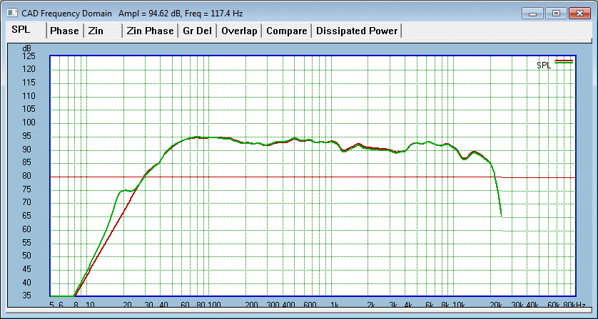

Here we have it simulated in SoundEasy.
Red is voltage and Green is current.
I can assure you it translates perfectly into the real world with my actual 40 Watt transconductance amplifier, 100mV in and 0.25A out, with output Z = 270 Ohm.
Note that Thevenin's Thereom is applied here - when the Z is equalised, the response will follow - and that raises a lot of questions as to what happens to Q - including Qe being eroded by Re+X, where X is the Z that is seen looking backwards - even DC resistance in large series chokes can be tuned out - if desired, so this has legs.
