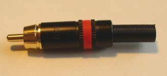

One of the materials that we can use is the enameled copper wire
Usually in sufficiently high quality copper (5N) in a variety of diameters, its an excellent conductor of acoustic frequencies,
its insulated and do not require other dielectric material. All it takes then is to cut the length of desired wire,
make sure the ends are clean and attach rca connectors of your choice
You can use neutrick rsa connectors known to the most of us.
There are other connectors which have clamps and can implement the enameled wire without soldering
You can start with a geometry of two parallel conductors.
Two pieces of the measure wire with a diameter of 0,6 mm, one for the signal and one for the ground for each channel .

For everything you need to know about selecting cable is quickly covered in these two BlueJeans Cable papers:
Subwoofer Cables from Blue Jeans Cable
LC-1 Audio Cable Design Notes -- Blue Jeans Cable
Other experts (Henry W. Ott, Bill Whitlock, Bruno Putzeys) write the same thing but use more words.
Even more quickly:
1] Low end to end resistance of the return (shield) wire.
2] Good shielding.
3] Low capacitance (for longer cables).

By skipping my first to items, the noise and/or interference can be much, much more audible. But then I have read that some audiophiles enjoy a little bit of noise or interference as it seems to add to the sound detail.
i would recommend you to twist the copper wire.
also, the tightness of the twist depends on your taste.
there's also good cheap cable to try.it's belden cat5e.i've been used them and they sounds good imo 🙂

It baffles me why people want to make their own cables. It is simply impossible for a DIYer to make a better cable than a factory, but surprisingly easy to make a significantly inferior cable. Poor shielding, poor balance etc. invite in hum and RF interference. Some people even carefully choose materials to maximise cable microphony!
I would find it hard to think of a worse cable for audio interconnects than a hand-twisted pair of enamelled copper. Maybe an untwisted pair?
