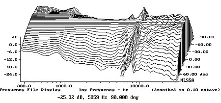

Jean-Michel, I don't think anyone said that. Of course your horn will have "less pattern flip", ie control vertical directivity lower than a smith horn (which is something like 5cm high, and uses almost only diffraction in the vertical plan...), but this is not much more than a pure geometrical problem and any horn with similar dimensions to yours will have the same vertical directivity "cutoff".
There is nothing wrong about it: "pattern flip" is just the symptom of a horn used lower than its "vertical cutoff" (lets call it that way...). Some system actually put this symptom to good use, like the JBL Array 1400 for example with a *very* smooth woofer/horn directivity transition.
The horn on the JBL 1400 is about 20cm wide.
1700hz is 20cm wide.
Based on that, I would expect the beamwidth of the horn to broaden as we approach 1700hz, and get wider in the octave below that.
Here's the polar response of the 1400; see how the directivity broadens at 900hz then dips again at 600hz?
That's due to the transition at the crossover point. Basically the horn has a broader beamwidth than the woofer, so there's a bit of a mismatch at the crossover frequency.
I believe that an argument could be made for turning that horn on it's side, which might make for a smoother transition from woofer to tweeter.
Then again, the transition is still quite smooth, and the tall vertical horn looks good.

Here is a comparison of the "Tool curves" from JBL engineering sheets for the Array1400 and S9800, both using (almost) the same horn, vertically for the array1400 and horizontally for the S9800.
The array1400 crosses the 14" woofer at 750Hz whereas the S9800 crosses the 15" woofer at 800Hz (with shallower slopes).
Array1400:
S9800:
The slow gain in directivity on that horn in the vertical plan matches the behavior of the direct radiator really well, which makes for a seamlessly transition ("listening window curves", second ones after the on-axis, are averaged on 30° horizontal and 15° vertical spans)
The little dip in the power response at the crossover point visible for both speakers is typical of acoustical LR crossovers.
Array1400:
S9800:

Jean-Michel, of course I know this is a point you take into account. I am certainly not trying to dismiss your approach here, and I really appreciate your work. I just want to highlight that "pattern-flip" is not some sort of misbehavior that can be fixed with specific profile: it is purely geometrical (and can be described using Webster equations quite accurately). It is something that has to be taken into account (and possibly put to good us as in the array 1400) by either choosing a high enough crossover frequency (as in your example with the E-JMLC 1000) or using round horns as you just explained.
Yes but this would be chosen first and this puts the pattern change out of band. Isn't this like crossing a tweeter at 200Hz and declaring it broken because it doesn't have enough excursion?by either choosing a high enough crossover frequency
Hello Pos,
I don't think that Webster equation is able to do that...
Best regards from Paris, France
Jean-Michel Le Cléac'h
yes of course, my point exactly: nothing inherently wrong with "pattern flip" behaviorYes but this would be chosen first and this puts the pattern change out of band. Isn't this like crossing a tweeter at 200Hz and declaring it broken because it doesn't have enough excursion?
I think the approximation is close enough in this particular case. What alternative model would you use?I don't think that Webster equation is able to do that...
Hello Pos,
IMHO Webster's equation cannot be used to predict directivity...
But may be I didn't understand the way you want to use the Webster's equation...
