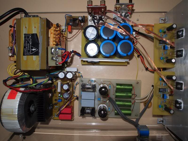

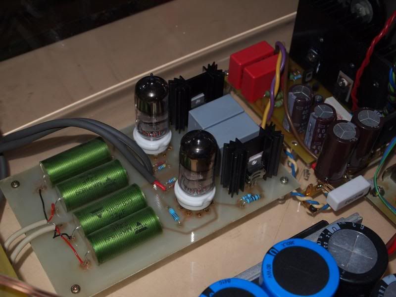

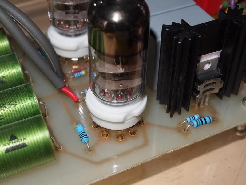

This is my first hybrid amplifier and the first power amplifier with tubes. (currently not in the output stage, but someday will)
For voltage amplifier I put 6S4P with cascoded DN2540 pair, the output stage is 2SK1058/SJ162 with simple circuitry for adjusting quiescent current and offset, the amplifier was made without negative feedback.Amplifier still waiting for accommodation in the right box.
