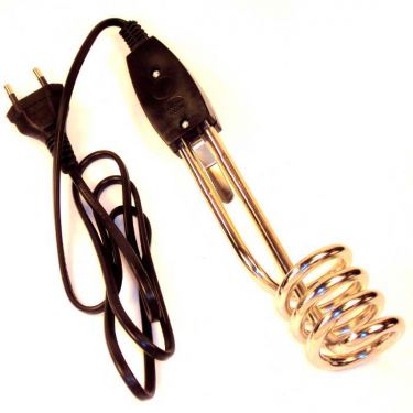

These are very inexpensive heaters intend for water.
If they are intended for water then they might not work too well on small pieces of nickel. Or they might work far too well!
ERRATA: I mean say heat the tube getter by induction, not the cathode.If they are intended for water then they might not work too well on small pieces of nickel. Or they might work far too well!
I already test this device in dry conditions and the metal resistor becomes very red instantly.
A better try could be a 220V model linked in a 120 outlet.
I wonder how much time the 6C33/GM70 getter needs to be heated with this device to activate the getter??
The issue with the induction heater is radiated noise. Since it would be used intermittently it might not be an issue, but It would probably cause interference in the HF band.
Immersion heaters often explode if allowed to run dry. Don't risk that with a mains powered device!
Really?? I would use it to interfere with the hi SPL boombox from my neighbor's spinster...rs rs rsThe issue with the induction heater is radiated noise. Since it would be used intermittently it might not be an issue, but It would probably cause interference in the HF band.
I will buy a 220V heater and use it in 60V for safe. ThanksImmersion heaters often explode if allowed to run dry. Don't risk that with a mains powered device!

At 3 to 10 dollars it is unlikely to be an inductive heater. There is no point anyway, as a resistive heater is perfectly good for heating water.
I don't understand your remark about 'expensive Pro heaters'. Those on here who bake their valves do them in a domestic oven. Inductive heating is for the initial getter firing which has already been done in the factory.

I am actually beginning to believe that you are serious about this venture.
Well, for that, then this reply is serious.
Those pictures you posted are NOT induction heaters. They are water heaters working at 50 or 60 Hz depending on the country you are in. They are used to heat water. Not much of an inductive field produced even if you step it down to 60 V with a variac or transformer.
Induction heaters produce minimum frequencies in the kHz (kHz = thousands of Hertz) range for their "inductive" heating using a rapidly changing magnetic field. You can read up about this. Even with a suitable coil, capacitors, heavy copper, transformers, components, and a manic departure from all safely concerns, even I won't be dreaming of doing this any time soon.
You mention commercial equipment? The closest I have ever come is my mother in-law's single element induction cooktop for portable table cooking. I wouldn't even do it there (expensive piece of kitchen equipment I would not want to break or replace).
You want to see some links from us? Probably not going to happen. You can do a google search yourself on induction heater and look at the images from other diy people. You can read their successful and unsuccessful stories and their incidents/accidents (like wearing a ring while too close to a heater -- this is near instant heat). I would not recommend any attempt at this because of the crazy high voltage/current/temperature produced. You have been warned.
Nothing with respect to vacuum tubes is perfect (not the perfect envelope, not the perfect material, not the purest of metals) and to spend the time, effort, and money chasing this is a dangerous folly to you and others.
What is so wrong with the tubes that you have in inventory? Be happy with the tubes you have, those are very replaceable.

Seems my idea was reject for being too inexpensive and dont had a nice looking hardware.
Other idea I would try is a incandecent filament lamp under the tube, it is even more inexpensive than the water boiler, but the heat capability is small.
I will avoid these inductive heaters as they seems heat the tube glass too fast.
My tubes are new NOS from 1980s, as never used tubes they need some conditioning or some heat on the getter to clean a possible gass inside.
FullRangeMan, what is used in a tube factory does not put out any HEAT!
It is an RF induction heater, probably in the Kilowatt range. It does usually use a coil, but the coil is big and fat to acommodate the very large RF CURRENT. Not 50/60 Hz. AC mains voltage. Not high voltage AC. Not high voltage DC. Radio Frequency. It's a big big big RF amplifier with a suitable coil to transfer the energy to the load. The load is the metal in the tube.
Think of it as "wireless spot welding". Ok?
_-_-
For indirectly heated tubes, there is nothing you can or should do to them other than run the heaters for say 24 hrs, and bring up the B+ slowly. For DHTs run the heaters for 24 hours and bring up the voltage slowly. Nothing else. Baking the tubes in your oven risks cracking the glass due to stress from temperature differences. Don't do it.
_-_-
