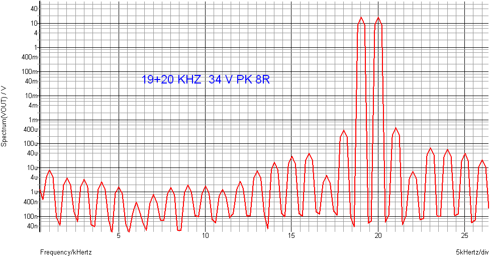

Why do we need to have any 1kHz? That is second-order. The 18 and 21kHz are third-order. You can have one without the other. The apparent absence of 1kHz second-order IMD says precisely nothing about the presence of third-order IMD at 18 and 21kHz.wahab said:To assert the presence of 1KHZ residual there should be peaks
comparable to the 18 and 21KHZ ones , that is the peaks have two clear bars
with a minimum of width between them.
If there were any 1kHz, it would be a single peak - not two peaks with a gap between.
This is a linear scale so a peak at 1KHZ if there was one should
appear in the graph with the same shape as the mentionned third
order products.
That said i generaly have relatively high 1khz products in simulations
wich invalidate the claims that simulators are linearity friendly...

And it is there, compressed in width due to the use of linear scale.
So, please note:
1) There is a 1KHz at around -70dB (~0.03%) in the Plot
2) If 2nd hd was very much lower it would not show up at all
Ciao T

Yes, one peak. You appeared to be asking for two peaks.wahab said:This is a linear scale so a peak at 1KHZ if there was one should

First, my name is Thorsten. It is actually quite clear.
Second, there is a peak at 1KHz. It is above the noisefloor.
On what basis do you claim that the 3rd order products "are high for a so called high end amplifier".
Can you present evidence that suggests audible problems being introduced by around 0.03% 3rd HD/IMD at 7V output (that would be a peak SPL of around 92dB in room for a stereop pair of "average" Speakers per JA's research).
And do you have evidence for Loudspeakers that have less than 0.03% 3rd HD or 3rd order IMD when having 7V RMS applied?
Ciao T

A sufficiently ham-fisted design will also show high levels of non-linearity even in a simulator.
However, taking your previous simulator example in post 1286 that you attempted to pass as actual performance measurements:
I so no particular evidence of significant levels of 1KHz IMD products contrary to your claim.
And I note that at a claimed 34V Peak (that is around 10dB higher level or 10 times the power of the Stereophile measurement and incidentally 72W into 8 ohm) shows the 3rd order products at around -100dB (around 0.001% IMD), which is around 30dB better than real measured performance of a suitably similar amplifier at 10dB lower level as shown by stereophile.
So, in this case I would suggest that the performance from the simulator will be hard to replicate using real devices, but I will be convinced otherwise if you can actually show real measurements.
Ciao T
Or could be that your designs have relatively high levels of second-order distortion, even with ideal perfectly-matched devices?
One peak that has width as the visible ones at high frequency.
It s when simulating any amp , not only the one i design myself.
Generaly i noticed that the first stage linearity and gain
are instrumental in reducing IMD and a current mirror
as the input differentials load is mandatory to have
top of the barrel IMD performances.

The 1KHZ peak is quite non significative , i think you ll be agree
on this point.
As for the 0.03% ratio i agree that it s surely below audibility
but since IMD is nastier than THD and that current technology
allow for a magnitude better numbers , why not ?...
High distorsion of speakers should not be an incentive
to neglect amplifiers parameters that seems to largely
surpass the speaker s possibilities.

This is an unadequate exemple since this design is among
the best i managed to bring from simulation to building while
keeping a good stability and reproducibility despite a 16 transistors
front end , but generaly numbers are not as good when using
simpler designs , wich i prefer , though.....

I agree the 1KHz peak measured for the Goldmund Mimesis 8 Amplifier is low in level, but it is at the level I would expect from the THD Measurements.
But why? I fail to see any merit to doing so.
Sure, we can make it better than this, but what do we expect to gain for making it better? And what price do we need to pay to attain such an improvement?
As for IMD being nastier, IMD is simply a different angle on HD, if the underlying non linearity is simple and consistent. If the non-linearity causing the HD and IMD is inaudible then it is inaudible, no matter if you measure HD or IMD.
But what is the benefit?
The Speaker will limit the system performance, an amplifier with much lower 3rd HD than the speakers will not benefit the system.
Yet in post #1286 you presented the graph like this:
So what you claimed to be an "average 100W amplifier" has suddenly become "this design is among the best i managed"?
So, what you showed not only was a simulation and not actual measurement when you criticised another amplifier designs actual measured performance which was worse than your simulation.
In addition, when you claimed to show an "average" design's results you actually did not show an "average" design, but one the of best you did.
Interesting.
Sorry, I do not understand, what preview?
Ciao T

Improving an amp linearity will improve all parameters , IMD among others.
There s no contradiction , it s one of my best but it is average
compared to many famed and highly regarded amps.

This one :
Goldmund Mimesis 8 power amplifier Measurements | Stereophile.com
When you did display their IMD measurement i was surprised
by the difference with simulations , but i had a doubt about
the sample that was sent to stereophile so i made some sims
and approached accurately the measurement results by increasing
the two 4.7pF Cdom to 47pF.
Then reading stereophile review of the Mimesis , i noticed this sentence :
the risetime, judging from the 10kHz squarewave shown in fig.7, was significantly higher than expected at 4.4µs vs 0.7µs.
Well , Goldmund did send a sample that was way more compensated,
surely to tame down the worst thing that can be said of an amplifier
in a review ,far ahead of other parameters as THD/IMD/DF ect
, i.e, instability...
Below are the sims of IMD and rise time of the Mimesis 8.
We clearly see that the rise time given in the review correlate
with the increased compensation....
