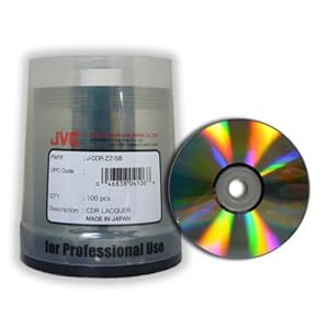

I've read about cd reflection and that makes sense, that's one of the reason why people recommends Taiyo Yuden Cd's. Which to what I've seen in Photos reflect more light.
As seen here
Compared to an Aluminium based cd (not the blue one)
I've read as well that apparently cd players struggle a bit reading cd-r's due to the lack of being reflected. If so, do you guys think that a "silver cd" (like the TDK's) would shorten the laser's life, compared to a gold one? as the Taiyo Yuden?
As a side note, I tried a cd that a friend of mine burned for me on 1998 (my first burned cd hehe) it's a blue one and it played without problems!
I'm starting to think there's something to do with the amount of light reflected rather than speed, as I don't think he went to the trouble of burning at 4x or less when he did it.
