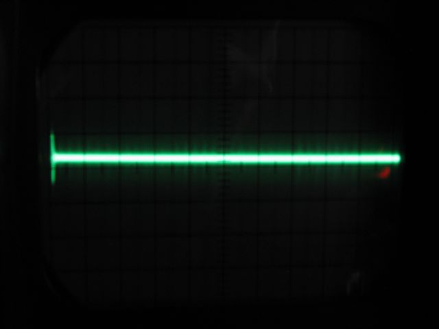

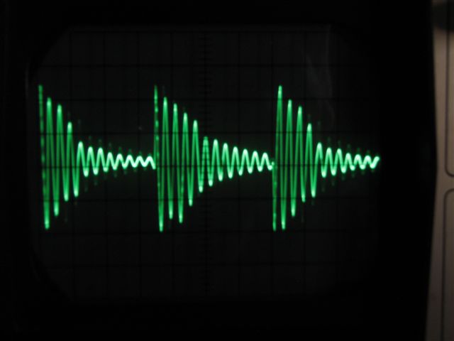

Well, here:
I thought I share this with you:
Mean Well S145-24 with some 10mF and a 0.39 Ohm resistor in series with floating COM, picture taken at 20mV/div and 5us/div compared to COM tied to GND, at 5mV/div and 5us/div.
And I can hear this with a B1 buffer in front of the amp.

Okay, an almost 50mV ripple at almost 60Khz, that's just not right! I wonder what he chose as voltage reference for the probe ground of the scope??
If that means you have to earth the output V- this is a poorly designed power supply!! Or not designed for audio....
The problem is when you earth the output you will definitely run in to ground loop problems with earthed sources..... Not very desirable.... Not really a 'solution'.....
Please remember that this meanwell that was tested is not the meanwell most people use.
If you have a meanwell, I hereby kindly request you to hook it up to a scope 🙂
