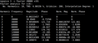

clipping the CFA
Here is the clipping behaviour of the CFA. (150% nominal input)
Pix 1: Note that the input stage (VAS input) never cut off (pink and green traces), and the cascodes saturates (dark red and yellow traces) limiting the excursion of OPS voltage to rail (red and blue traces) - 2.6V, so OPS never cut off, and leaves a Vce of 2.6V guard to avoid OPS instability. The output is the violet trace.
Pix 2: Show the symmetry 0.002 DC OFFSET and all distortion are due odd harmonics, leaving the clipping state is free from transients, clipping at 400KHZ or above shows a little (not oscillating) transient when re entering the linear region.
Cheers
Arturo
Cheers
Arturo
