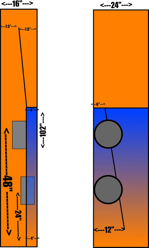

Here's the plans for a 15hz tapped horn that I'm building.
There are a number of plans on the forums for tapped horns, but this is a bit different. Here's why:
All in all, this tapped horn may be a good candidate for your home theater.
I spent most of the time optimizing the volumes in Akabak, so the plans themselves are kind of rough. (I'll post the Akabak sims later.) The outside dimensions are 102" tall, 24" wide, and 16" deep. That's twenty three cubic feet(!)
Sims coming soon...
- I've built a few tapped horns, and I've found that the use of multiple drivers smooths out the response. This one uses two drivers, but it's spaced as if there's three. This offers the benefits of multiple drivers, while maintaining an easy load on the amp.
- Conventional horns and bandpass subs roll off the highs. The low-pass filter effect of the horn reduces 2nd and 3rd harmonic distortion. Tapped horns don't really work the same way, particularly if the woofers are mounted close to the mouth. In my experiments, I've found that cheap drivers can sound good in a conventional front loaded horn, but tapped horns like a driver with lots of xmax and low distortion. To this end, I've selected a pair of twelves with 24mm of xmax, and shorting rings.
- To further reduce distortion, I'm using push-pull mounting to lower the 2nd harmonic.
- I'm using an extraordinarily large box to raise efficiency and smooth out response.
Sims coming soon...
Whatever you do, don't ... don't ... don't believe the hype. Build it and see! =]

This illustration makes it easier to follow what the path is in the horn. While it wasn't intentional, this layout is very similar to The Tower of Power. I didn't even notice until I was reviewing the patent today.
Where is the mouth, at the bottom (24 x 12) ?
You can put it anywhere on the bottom; it's 1558 sq cm. (241 square inches.) I haven't decided where to put it yet, because I haven't decided if I'm going to mount it from my wall, or simply put it in the corner.
Here's the Akabak model. Note that this is a "true" dual driver model. Hornresp can't do this - it models multiple woofers as if they're radiating from the same point in space. The use of multiple woofers can extend the bandwidth of a tapped horn, and you need Akabak to model that.
Here's the predicted response. This is with 49 volts. It basically has a bandwidth of three octaves, from 16hz to 128hz. That top octave is a bit rough; I intend to roll it off at 80hz.
And the predicted excursion. The driver has 25mm of excursion - we can get down to 15hz or so at house-shaking levels.

Accounting for only Xmax of each the TH would produce 120dB at 17Hz according to AkAbak.
Put that into this calculator.
Piston Excursion calculator
Unless I typed something wrong you would need 11 drivers to keep up.
And THAT'S why sealed is not being considered 😉
Sure, lets go sealed.
Unless my understanding of the laws of physics are faulty or we are not talking apples-to-apples as the baseline, you'll need to explain that to me.
