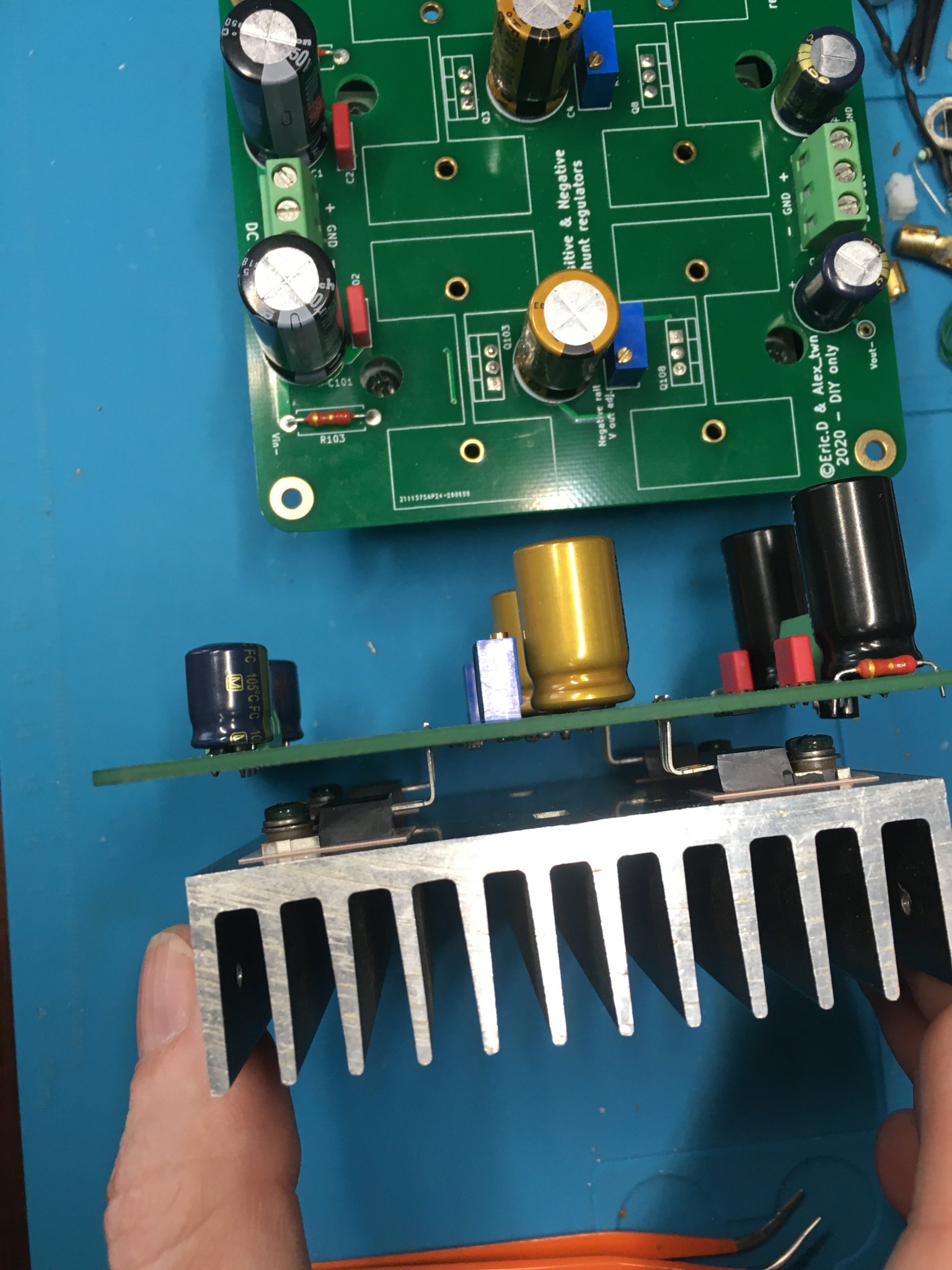

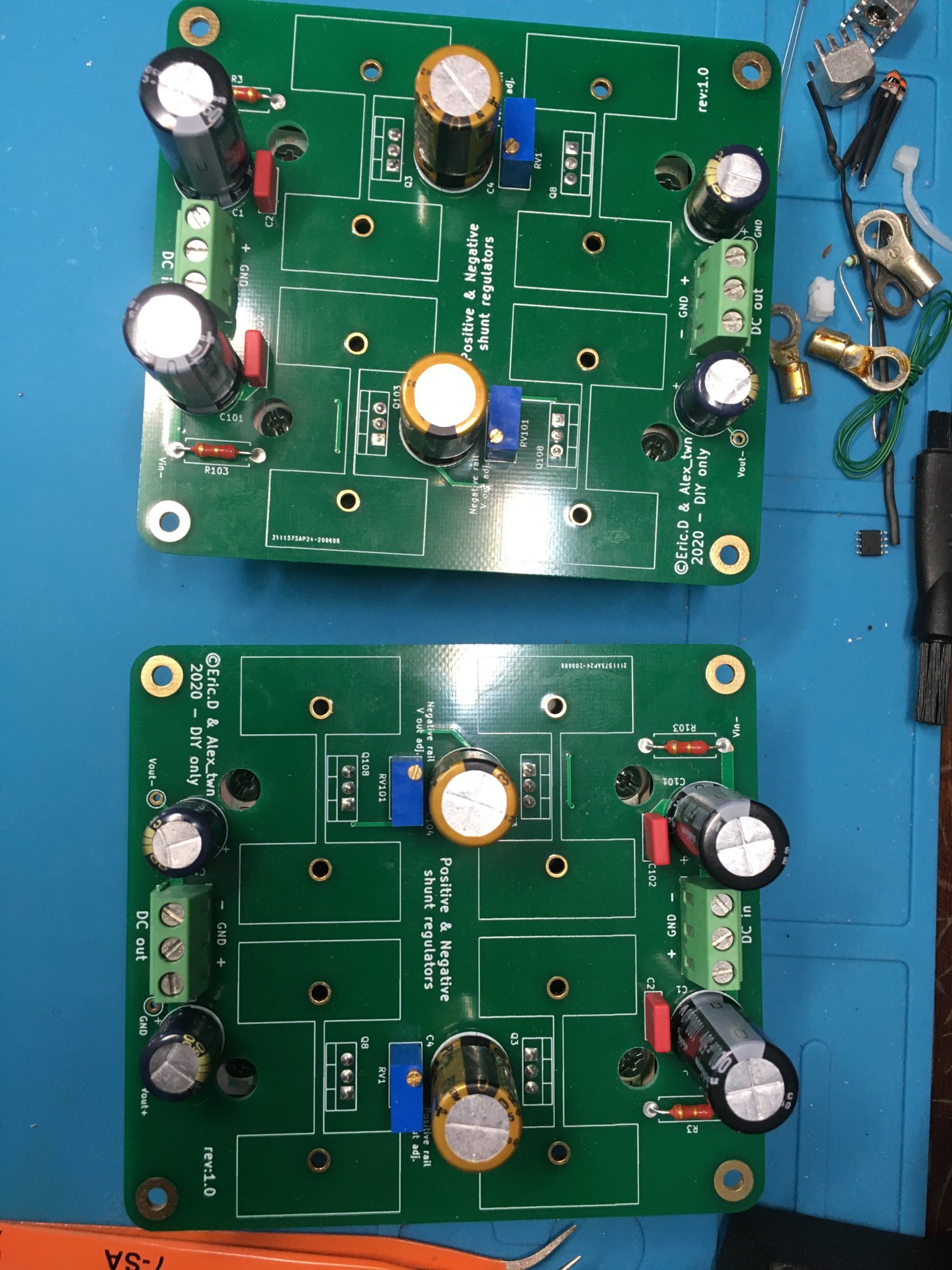

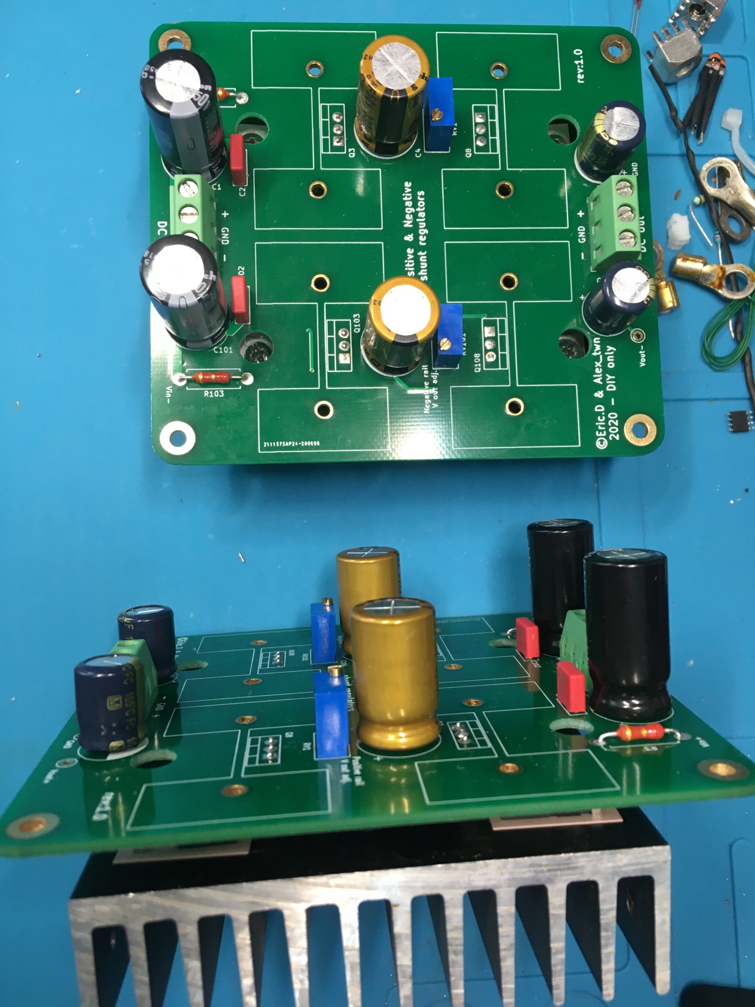

Hello,
I have for sale my Salas Ultra BIB V1.3.
The pcbs were drawn by Eric06(from the ugs muse group buy) and assembled by me.
Each pcb hosts a positive and a negative shunt regulator
The ccs is set for 260ma, I powered them up with 35v and set for 28v on the output.
They worked like this a year in my ugs preamp.
I sell them because I drawn the same design on an aluminum pcb, fully smd, which I can connect thermally directly to the enclosure, saving on the heatsinks.

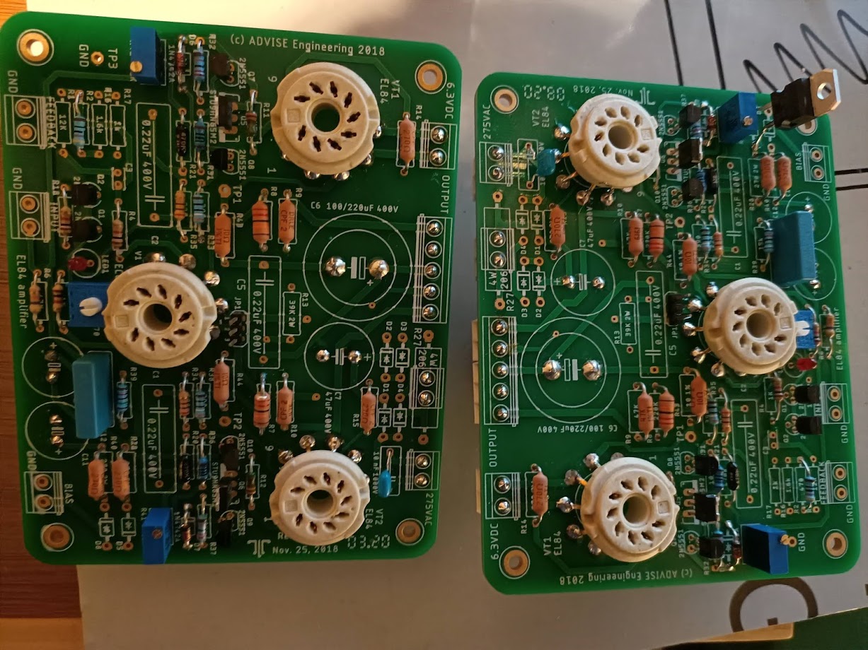

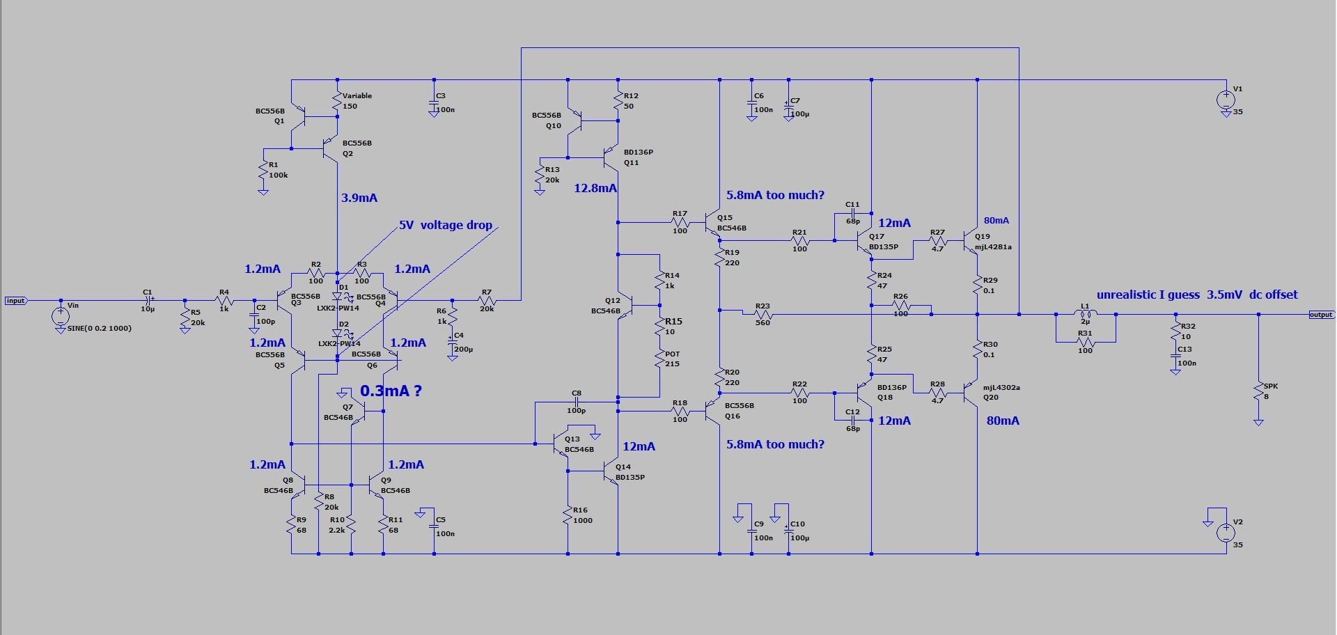

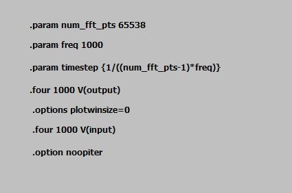

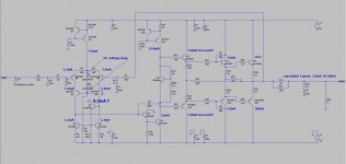

Hello everyone, if you have a little bit of time come take a look at this amp I recently build ( only in simulation so far ) and maybe tell me your toughts, improvements , what you think.
Also attached the .asc, if someone wants to simulate it, also for THD , im not sure I did it correctly.
BD135-136 are gonna be 140/139 in reality.

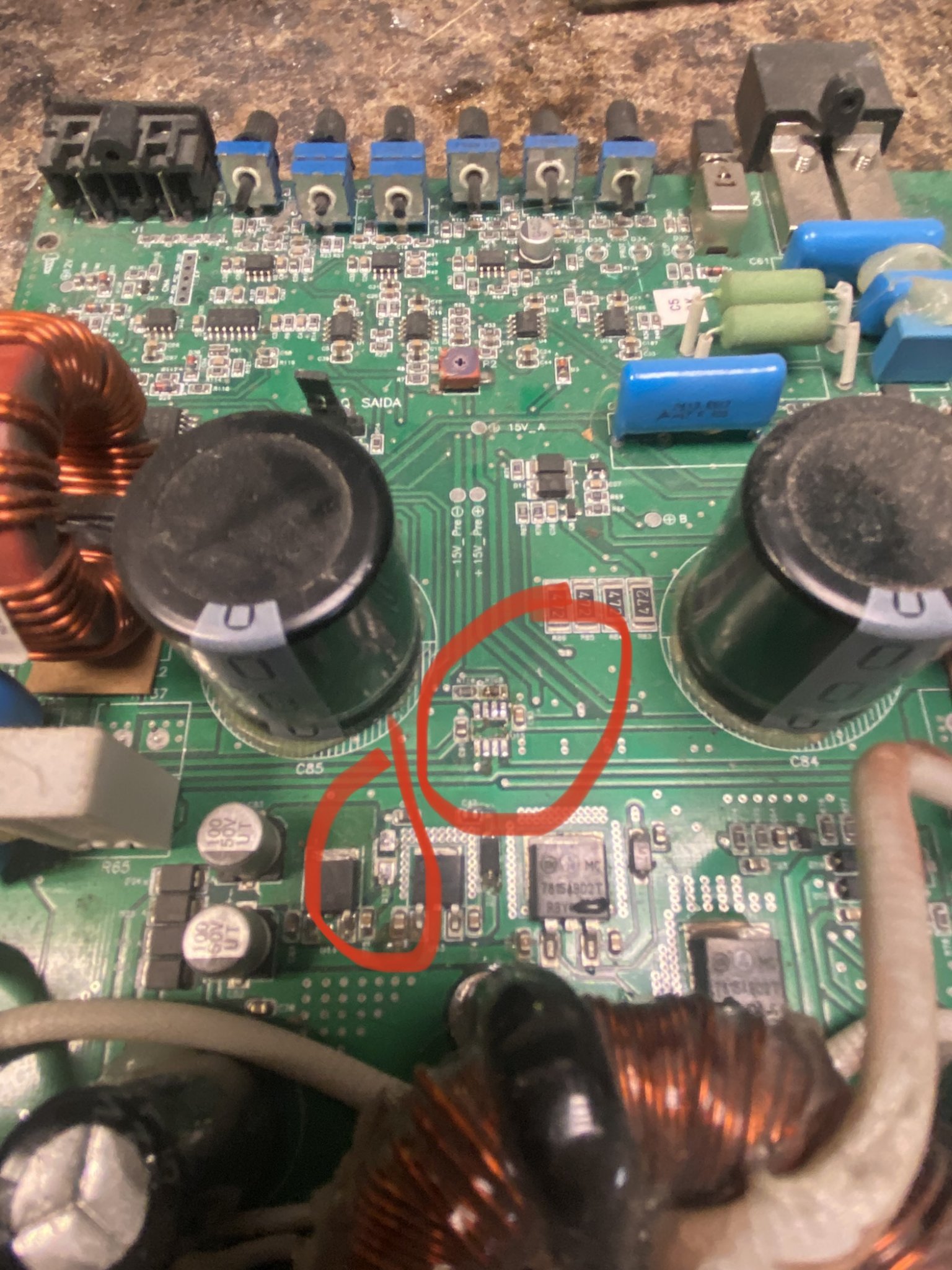

ASUS ADP-65DW C PROBLEM
Hi. My notebook adapter is working but once my wife put it in the wall socket ,it caused spark and it turned off the main fuse at home. Last night i put it to another wall 3 way socket and it caused big spark and it turned off the main fuse in apartments electric room which was closed and its keys were at site administrators office.I could get the key and turned on the fuse. Why it happens? Does my adapter have issues? Because the adapter is very expensive here (about 40usd ) Is it good idea to connect serial inrush current limiter ( like SCK10103LIY501 10R 10mm 3A or SCK205R0MSBY 5R 20mm 7,5A. I do not know how many amperes is enough, i think 3A may be enough but not sure ) Thanks

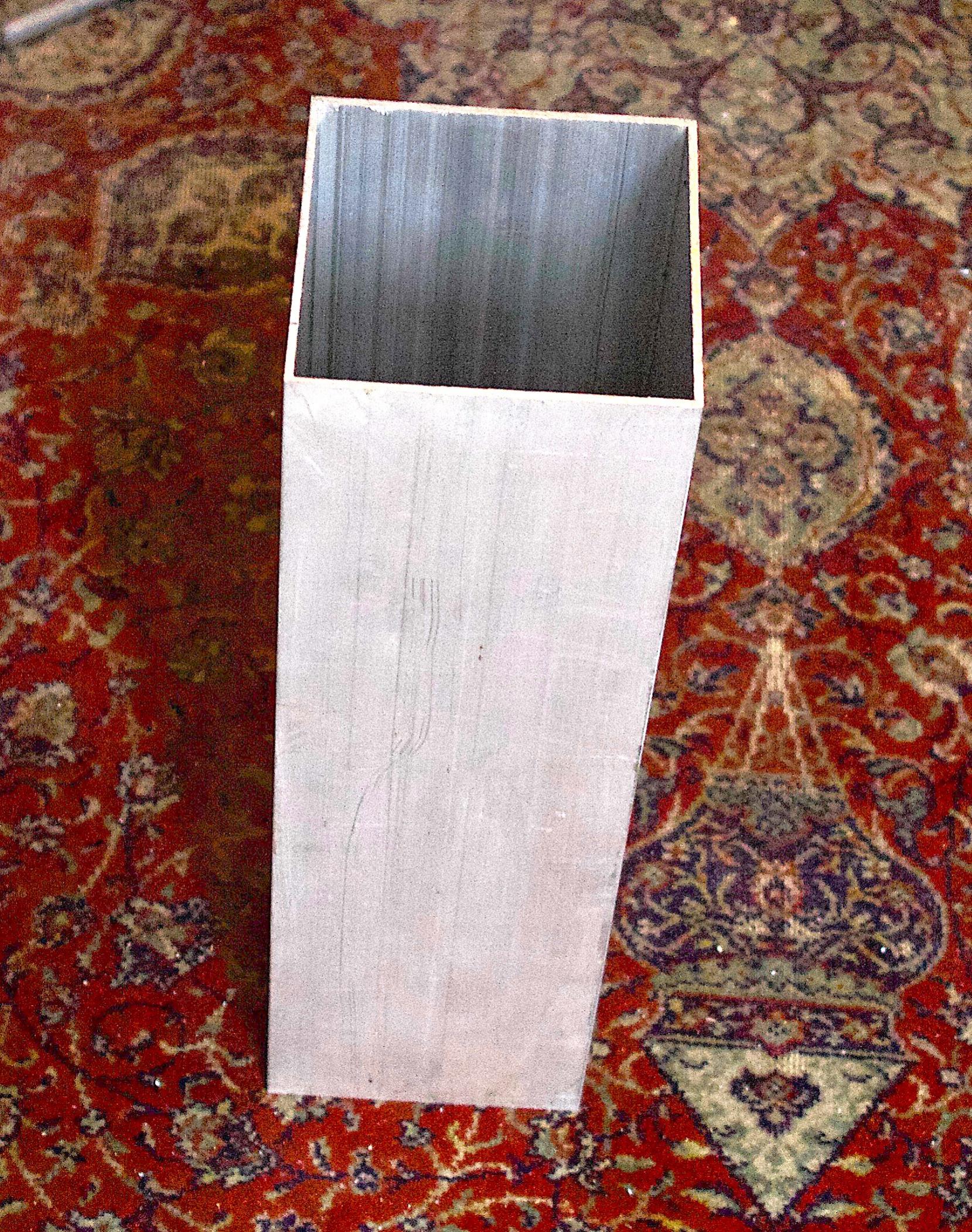

What do you guys think of aluminium as a cabinet material? Interested in all kinds of views and actual experiences.
Here's an example of a cabinet that could be used for a bookshelf 2-way. It's 150mm square OD, 142mm ID, 505mm high. Volume 10.2 litres. Walls are 4mm. It resonates to F above middle C, 350hz as it is.
The walls could be damped internally, and an outer layer could be added very easily on the sides, e.g. plywood or MDF or whatever.
A top and bottom would have to be added, so I'm also interested in how that would be attached. We're talking metalwork here so solutions may vary from wood - more bolts. The speaker units would be bolted on for example. I'd expect the top and bottom to be removable.
The treble unit could be either in the cabinet or above and set back to align with the mid bass.
Views?

Rushed F5
attachment.php
I am experimenting to transform the single front-end into push pull. I came upon this type of circuit. Note that the power mosfets can be VAS stage. The lower current of the Rush is inverted by current mirror subtracting a fixed CCS which adjusts the bias current 1.48A. As the same current of the rush subtracts itself , the distortion goes very low 0.0002% @1khz 1W , in worst case 0.09% @10khz 40W. The power mosfets work in square law bias they are thermally stabilized by LM334 mounted upon . This circuit is designed in less than an hour, To morrow , I 'll post with Single Floating Supply to take care of the offset.
Hayk

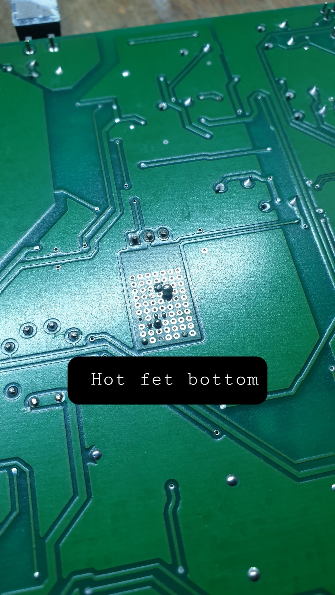

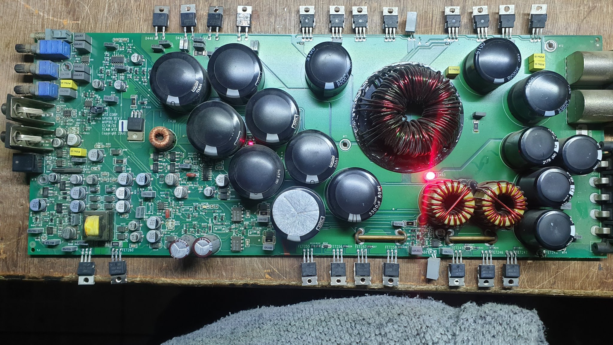

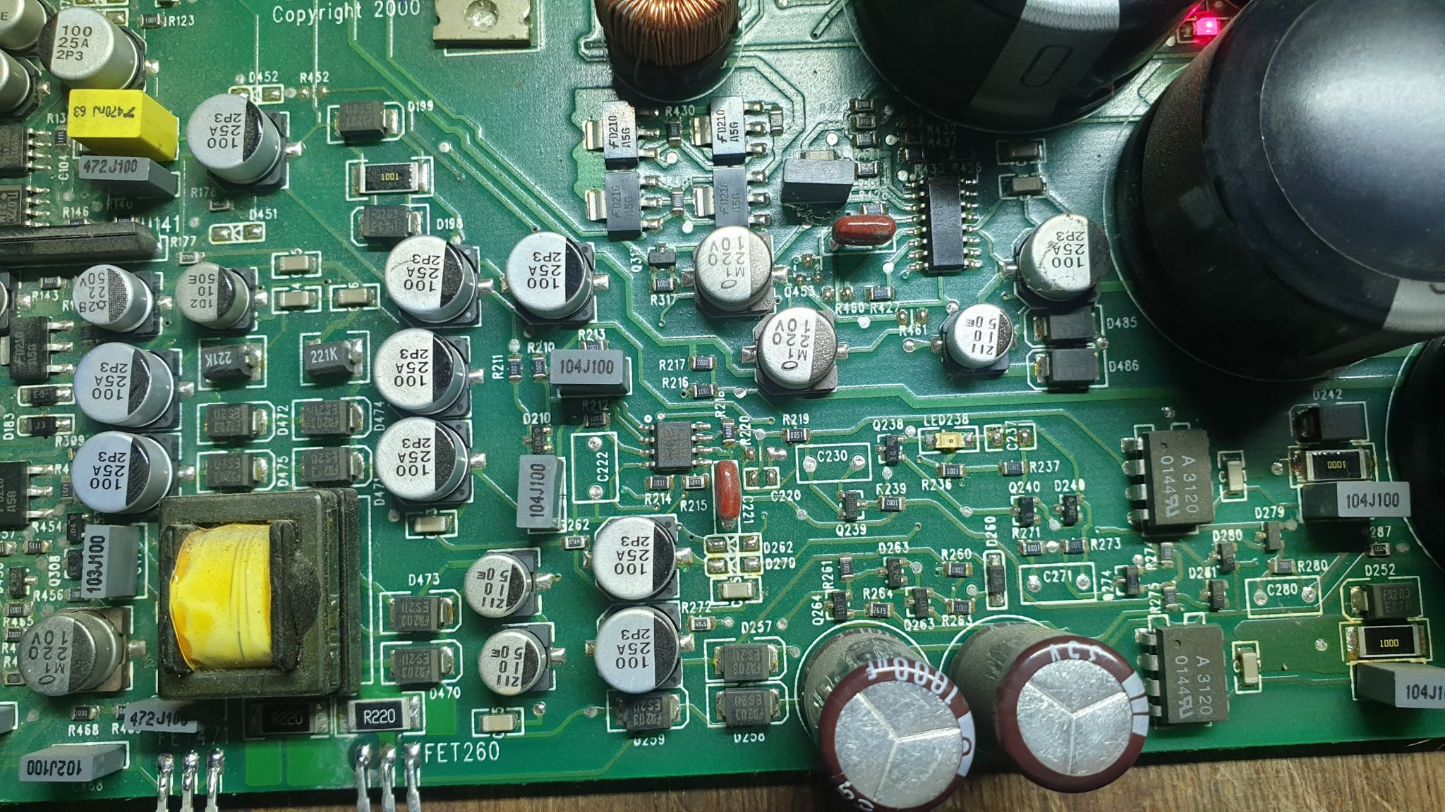

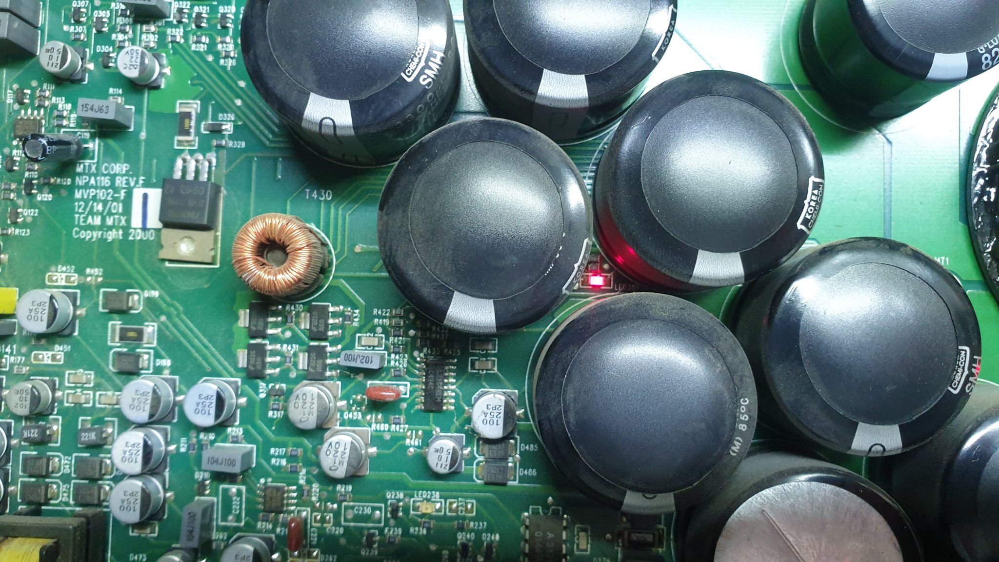

Deafbounce aab 4900.1d clip light fully on
Hii im reparing deafbounce aab 4900.1 amplifier i have repaired it's ps and output section but clipping light is fully on with blue light i have checked all output Ic's pwn ic, driving ics with its buffer ics all are ok. Can someone help me please

Fosi Audio buzzing noise problem
Hey, I know there are some threads about noise problems here but I couldn't find the right answer.
I am building an amp out of an Fosi Audio ZK-502T Bluetooth 5.0 Amplifier Board (TPA3116D2 Chip).
...and I have some Issues with noise. Please hear this video for demonstration.
Login to view embedded media
For some context:
The 1 khz Sinus sound you hear is on purpose, I needed some input signal because otherwise there is a noise gate turning on. So ignore this one.
First there is this white noise like sound in the background, might be normal is not that wild. Only audible at very high volume.
But then there is also this incredible loud buzzing sound. When I touch somewhere on the circuit (ground) it gets way more silent and when I come near the cables it gets louder, even before touching.
I am connected over bluetooth, so no input device is connected.
This is the board.
I modified it a bit to build it into my casing.
I desoldered all 3 potentiometers.
The volume poti also works as an on/off switch, so I bridged these two paths to have it always on. (Red small wire)
The other connectors I wired back to the potis to have them somewhere else in the case.
Before I desoldered the potis I think there was no problem of this sort. Only tested it shortly once before so not 100% sure. My guess would be some problem with the cables or the ON/OFF shorting.
Can you please help me figure out where my problem is?
Thank you!
