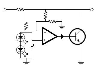

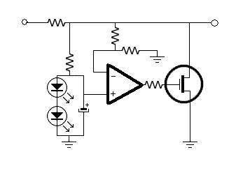

For the 7th installment, lets see if we can make out voltage reference better.
How about Using LED instead of the zener, which are quieter and more colorful.
We can make even the LEDs better by replacing the resistor with a jfet wired as a CCS.
I am only showing 2 LED, 7 Red LED or 5 Blue LED might be required for the 14V reference needed for an 18V supply
I favor discrete regulators rather than op amp based regulators, but this is a simple one that would be worth a try.
More feedback gives a lower output Z. However, specs may not be everything.
This is the bipolar equivalent. The diode is there to allow the op amp to use the raw supply.
