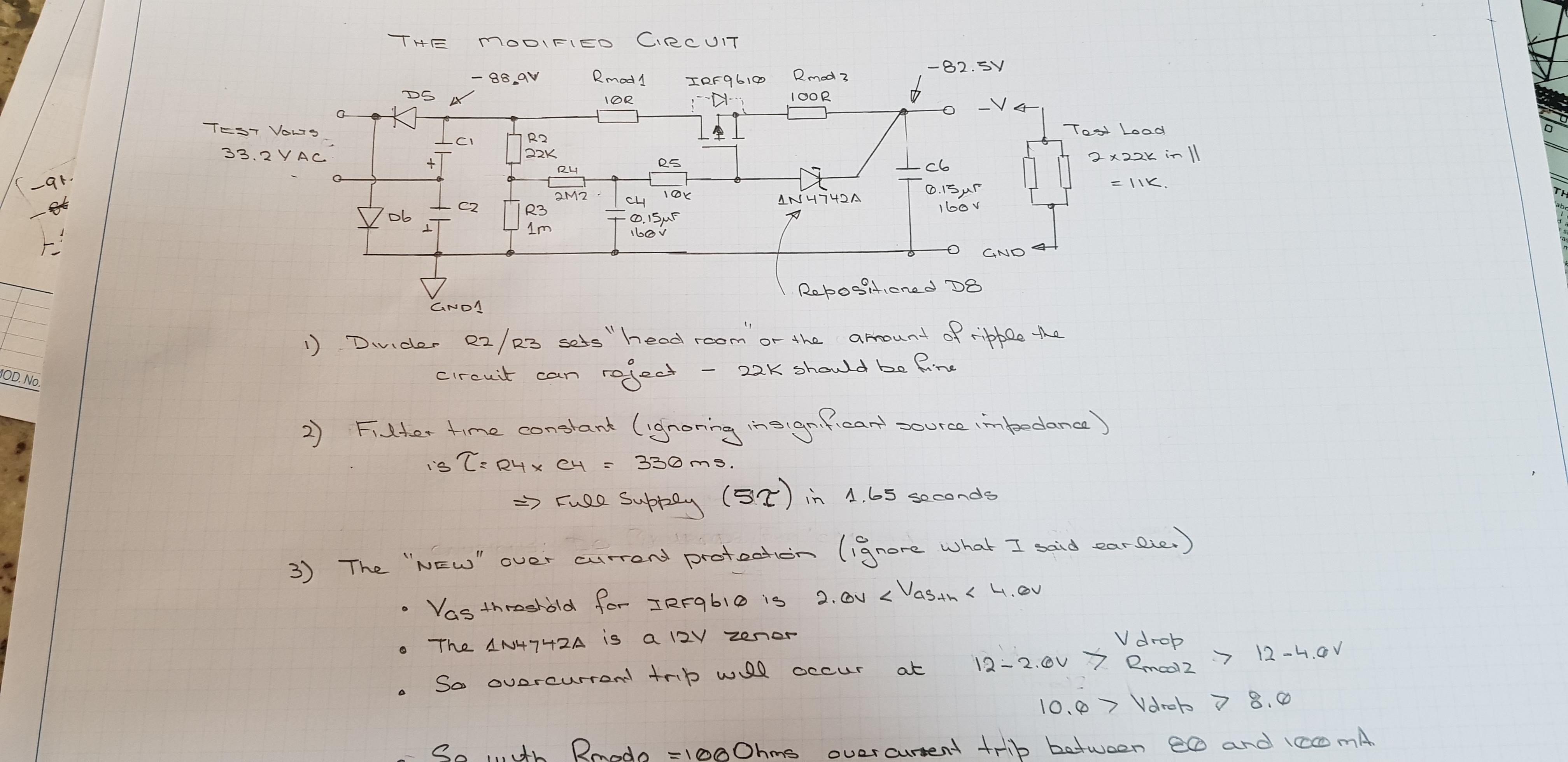

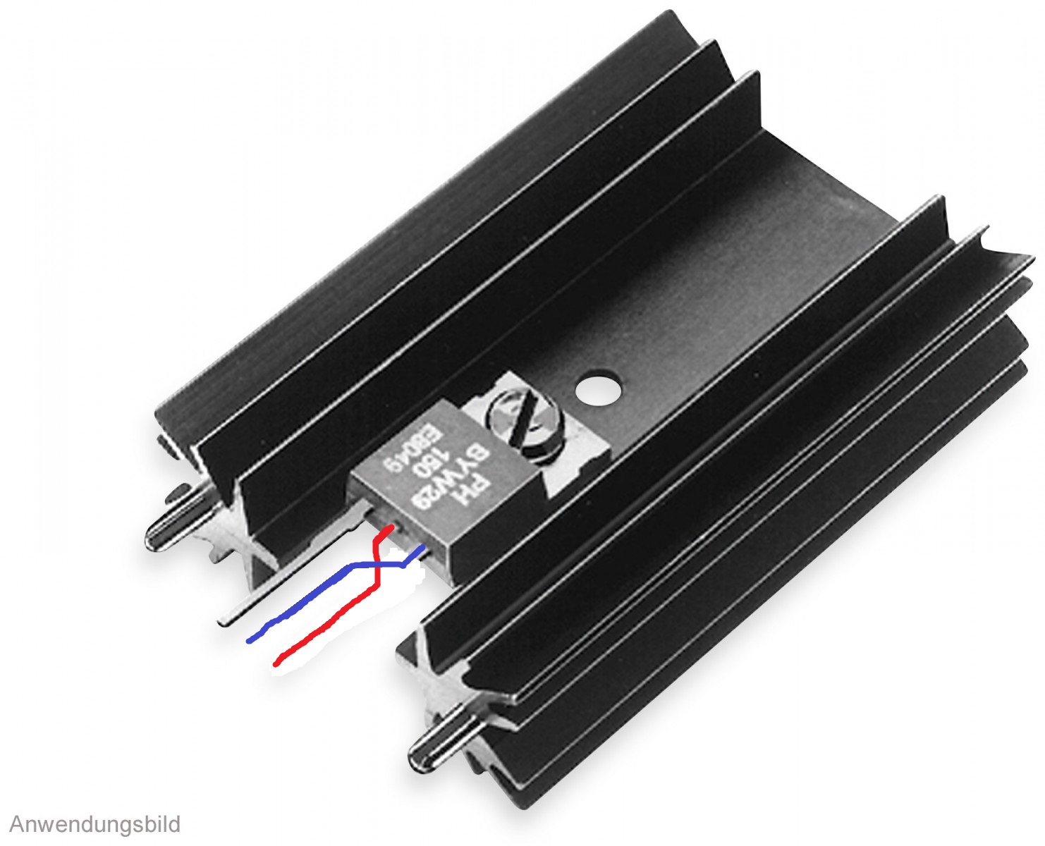

Error in the old power supply board version 1:
the connections of the mosfet drain and surce are interchanged in the layout and must be rotated!
https://www.diyaudio.com/forums/atta...nik-sk-104-jpg
a mod for the power supply for a better output voltage (from Gingertube)
https://www.diyaudio.com/forums/atta...405_160239-jpg
https://www.diyaudio.com/forums/tube...st6148566.html
