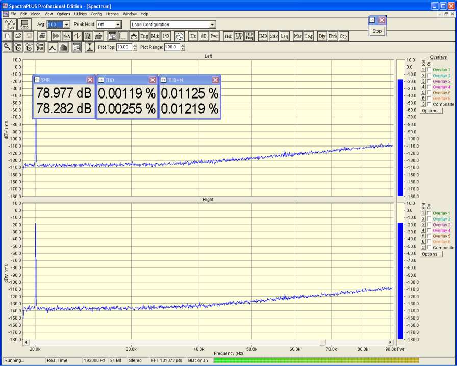

--Cold bias starts at about 3.6A total for the amp.
--The bias increases over about the first twenty or thirty minutes (this will depend in part on thermal conditions) to approximately 4.5A, which is in close accordance with what you'd calculate from the schematic. .5V/.22 ohms= 2.27A per side or 4.54A draw for the entire amp.
--Output increases as the amp warms up, but it will swing on the order of 17.5Vrms across 8 ohms. This works out to a little over 38Wrms.
--The efficiency, in terms of current in/current out approaches 50%.
--Gross clipping, meaning overdriving the amp until the output resembles a square wave, only increased the AC on the rail by something like 5 or 10mV.
