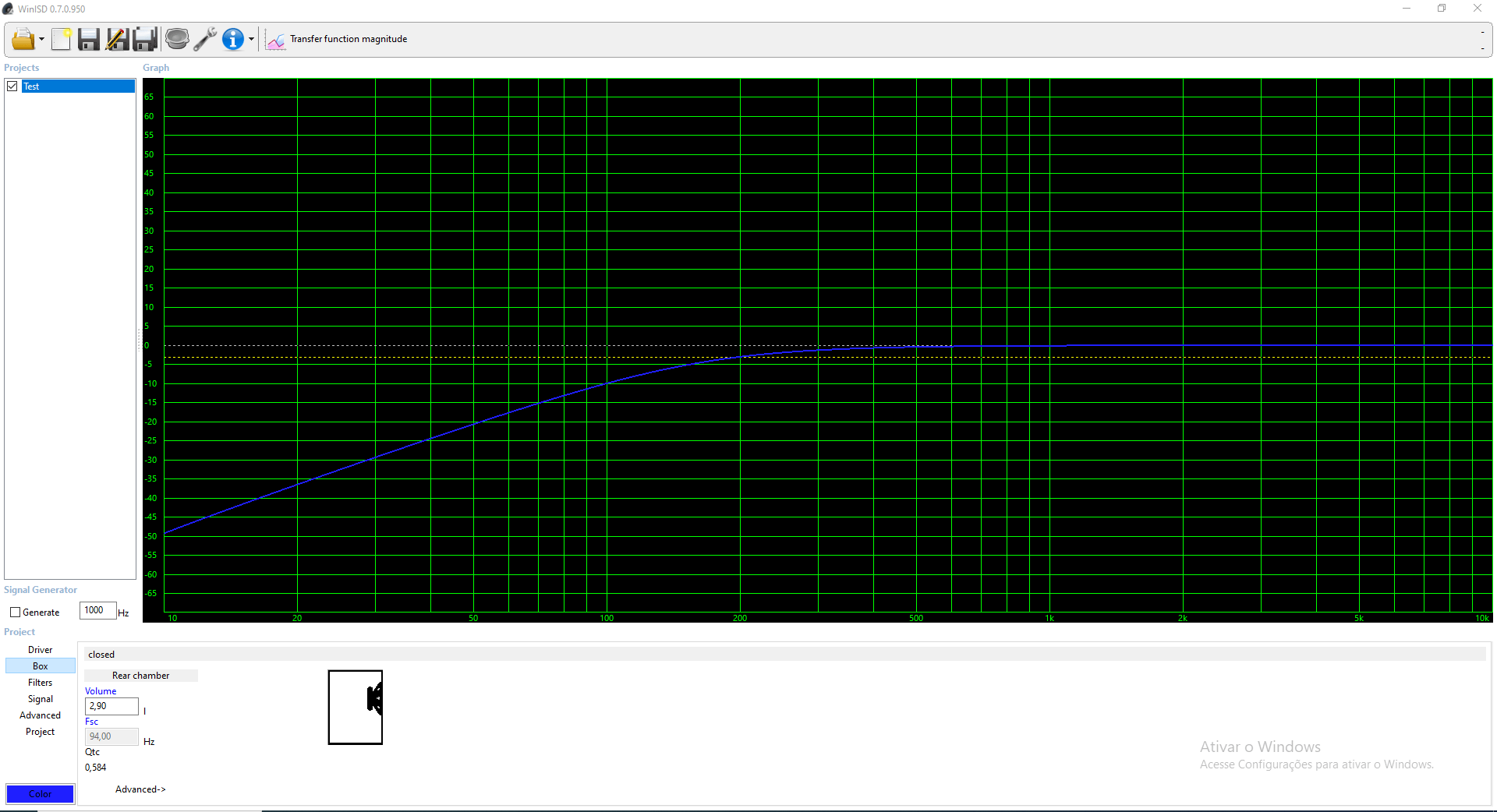

It was very recently that I started studying speakers and the hi-fi scene. I read in an article recently that when it comes to a sealed midrange box, the QTC has to be between 0.5 and 0.7. So far so good, but when I put any example midrange in winISD the internal volume of the box is very low... around 3 liters and I've seen examples on this forum of boxes with a volume of 7 liters. Midrange 4"
The article is incorrect. As mentioned above a midrange driver does not normally want to use a cabinet resonance to extend the low frequency response given the low frequency is normally then reduced in the crossover to the woofer. There is a price to pay in terms of a degraded transient response which is best avoided. A midrange enclosure is normally designed to be reasonably large and adequately stuffed so that the rear sound radiation is as fully absorbed as possible.

I found graphs on the internet to help me study... From the graphs I have and from what I read, it would cross with the crossover at 350hz
Do you have any articles I can read more about your theory?
It's not my theory or even really a theory but normal practise/understanding and I would expect it to be mentioned/assumed in most competent DIY speaker textbooks. Given the cabinet loading is effectively irrelevant I doubt you will find articles on the topic. What you may find are various studies looking at the effectiveness of various midrange stuffing strategies and possibly a bit on cavity shape. Unfortunately home audio is full of nonsense articles claiming all sorts of nonsensical things and so you are almost certainly going to come across a fair few of these as well.
An up to date reliable text on speaker DIY is a good question and I am not sure I have an answer. Anyone? The 50-60 year old basic texts I used have many relevant omissions due to how designing and manufacturing speakers has evolved.
The good news is that a midrange cabinet is not critical to performance. So long as it is big enough and contains a reasonable amount of stuffing it should be fine. Issues may arise if there isn't enough space behind the midrange driver but this tends to be rare given 3+ way speakers tend to be large.
A 4" midrange crossed around 350 Hz is a common configuration and so a quick look at good quality commercial and DIY designs using something like this should give you a good idea of what tends to be done in practise. Again, be aware that there is a lot of nonsense and marketing out there so take care with unusual designs.
