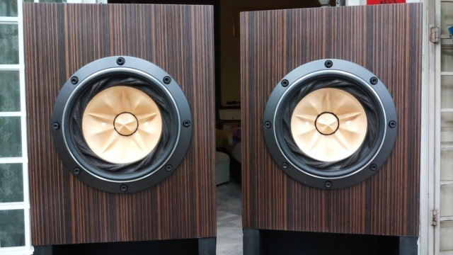

I have Fostex FE168EZ Sigmas, EnABLed and in ML-TQWT driven by No-feedback amps like DIY M2, F7 and others. In room response is upto 30Hz. Compared to a host of high end speakers I have heard, including smaller MA drivers in recommended cabinets, these are more real in their presentation of all genres of music.

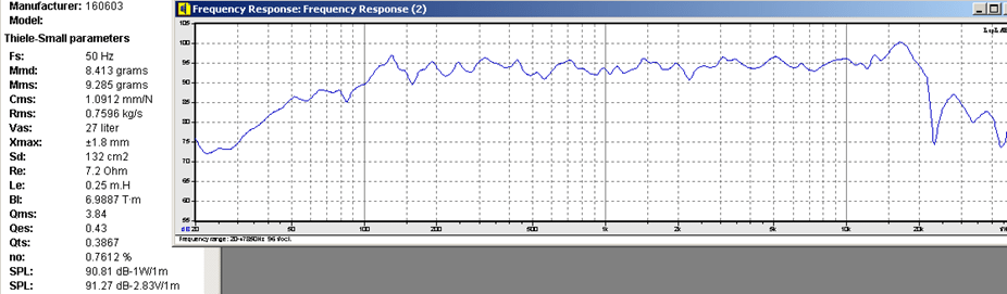

I could only find sfr175 but is it swr175?
If yes,do you have frequency response for swr175?
This graph I got from Istvan in 2016. It is for SWR175A (alnico)

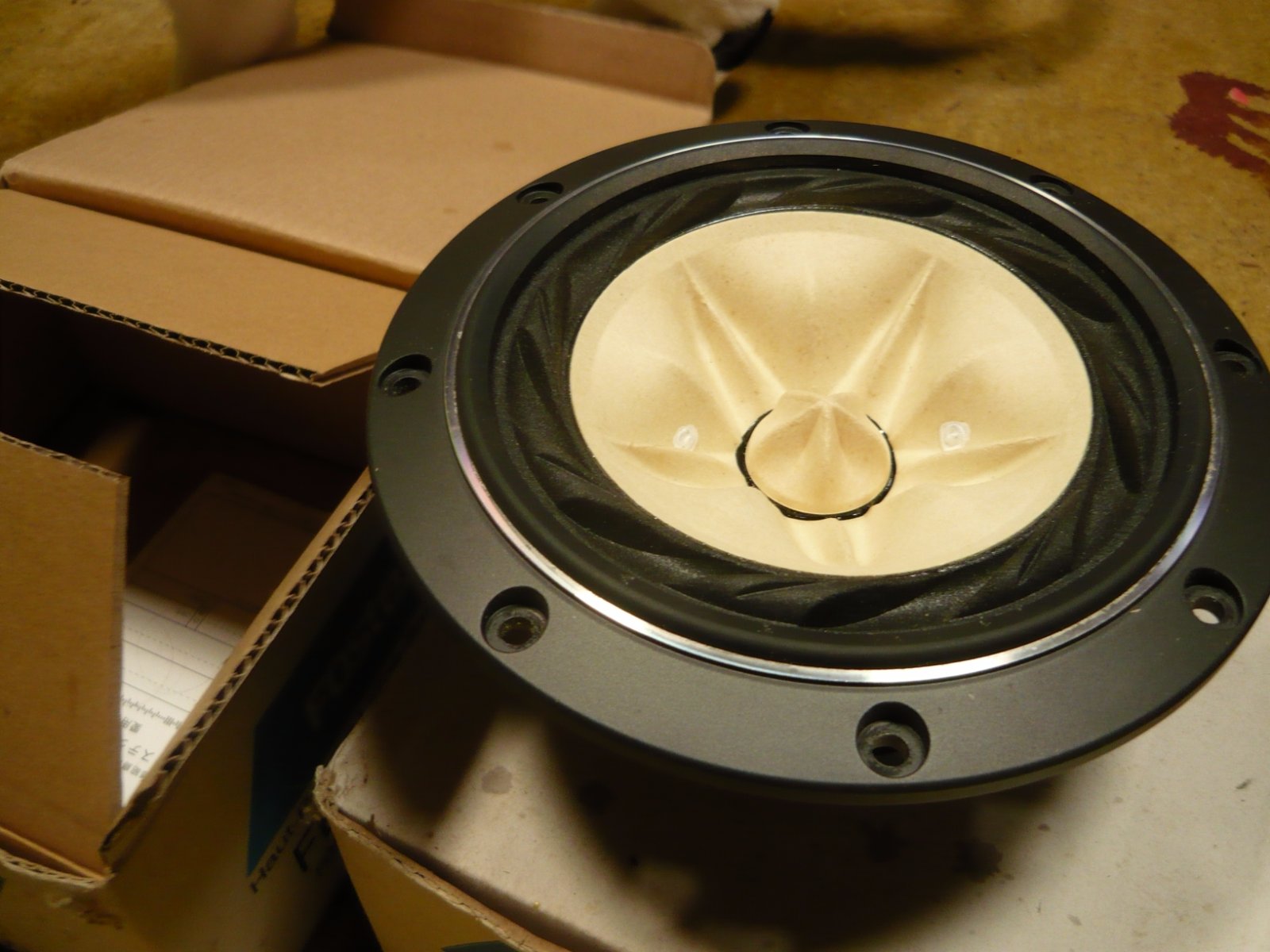

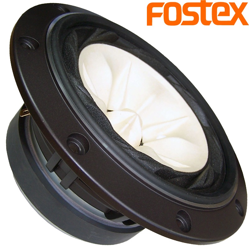

Different statements regarding the perceived sonic performance could arise not only from the known different boundary conditions ( different rooms and places, different cabinets and amps etc), but also from the fact that each batch could have a different frequency response and TSP than the previous one.
Because of the complex surface structure of the cone (diaphragm) and surround, I think the probability of this is quite high in opposite to usual constructions - go to the attached images.
Under
https://www.superbestaudiofriends.org/index.php?threads/set-and-fostex-blh-speakers.1358/page-3
there is described differences to the FE166EN
