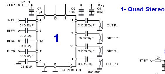

Thing is that amp should be inside the speaker box and it should have DC female connector. I dont have anything to do with power supply. (Its smps crap and I cant do nothing about it.)
And thats end of the story, all I can do is inside of that box to make it sound better.
If this Juma can work with this smps crap thats great.
But I thought maybe its better to try from begining and use it on better chip like tda7379(if it is better). I dont understand why nobody has tried it.
I will order some tda7379 and sta540. I dont have other option. Im going with 4 channel stereo output (if each channel can have its own volume knob, that would be great). Which hifi components should I use so I can order that too.

Hello . sorry I'm new, I see you guys discuss about modifying the circuits but I haven't seen any circuits diagram .
Can someone help me with the circuit diagram? I only have the separate chip. I can make the circuits available on the internet because it show the values of the component, resistors and capacitors. But for mod version, I doesnt know
