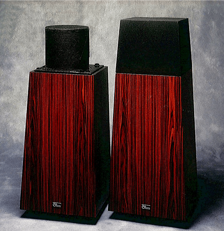

Ohm Walsh did a few omni directional.
Fontana from Visaton was always interesting.
plus one with satellites
Its essentially a speaker on its back.
So its better to understand center to center mounting.
and what frequency a piston size comes directional.

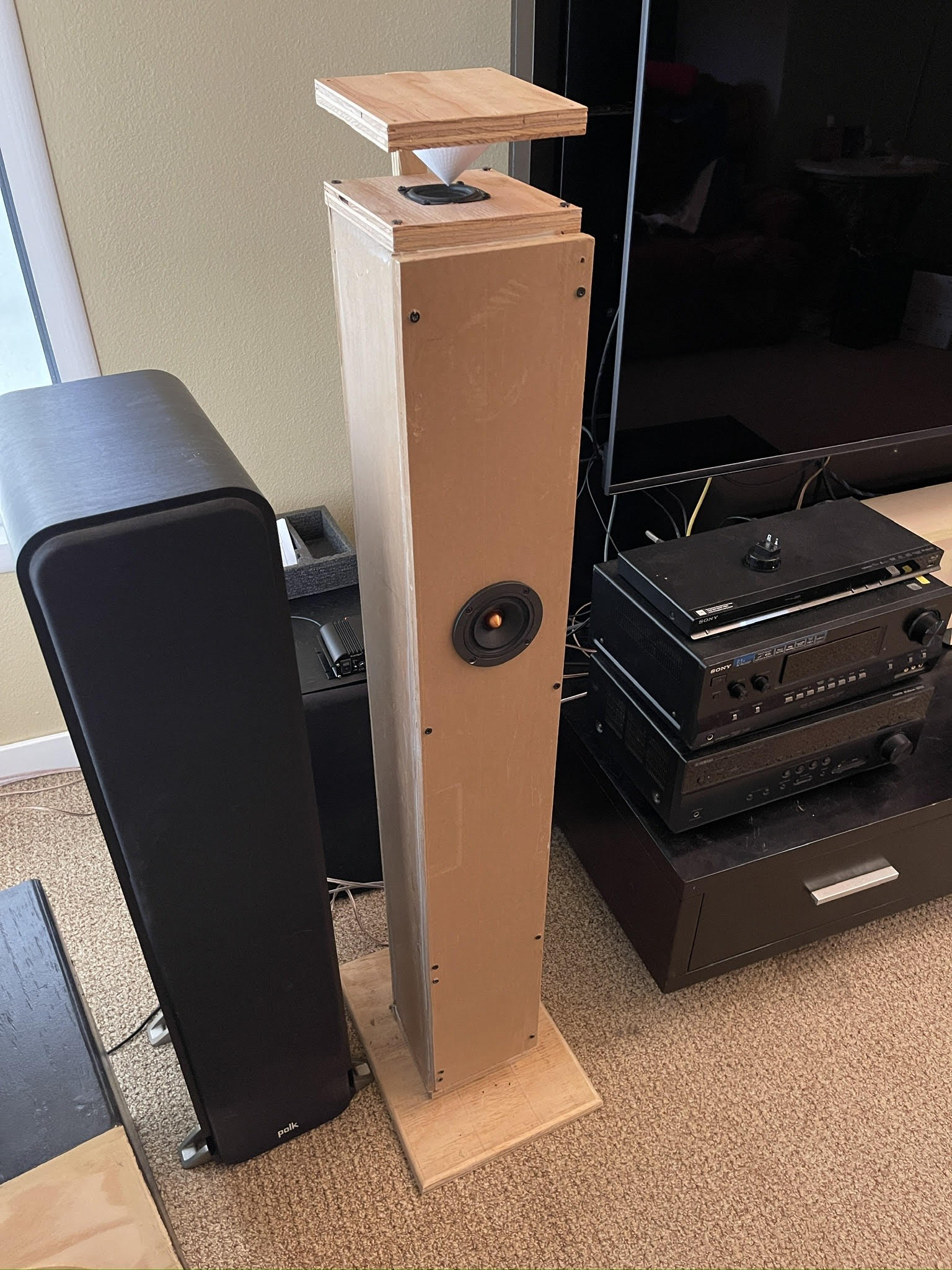

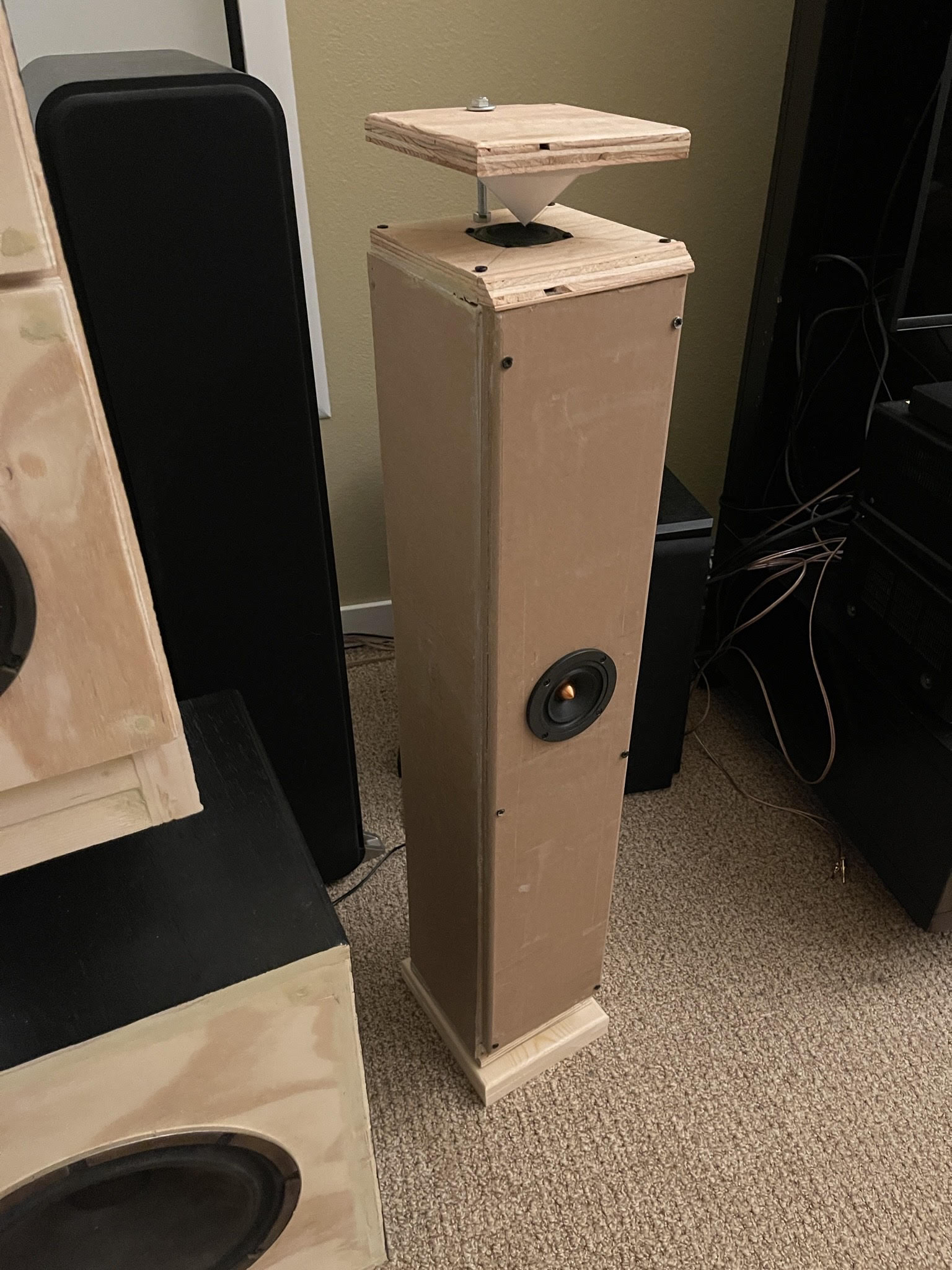

** Update**
I got some free brown MDF that I thought looked mostly usable until I got home and started working with it. Basically all the sheets were split or coming apart down the middle parallel with the wood. I had to glue most of it back together.
I finished the first rough prototype a couple of days ago. The sounded okay. The bass was lacking a lot, until I realized there was a couple large air gaps because of the bad wood quality. Sealing those gaps helped out a good amount. (The black Polks are about 41 inches high to use as a reference)
Upon more casual listening I decided that the Omni portion of the speaker was too tall. So today I chopped off the bottom portion of the speaker and made some more refinements. My goals today were to see how much of the bass response was affected with the decrease in height./ altering of the internal fold. After some critical listening, the bass is less and there is some combing occurring. The next iteration I plan on moving the front facing FR up closer to the top. I currently have a partition separating the two drivers so that they each have their own air chamber. Is this necessary? or can I omit the partition and place the drivers next to each other?
Is there a crossover?
Hence why center to center spacing was mentioned.
If both drivers are covering same bandwidth
and they are that far apart.
Yes be a generous amount of combing /cancelation.
Forward facing fullrange not needed.
Just add a woofer for bass.
Crossover is just at the baffle step.
looks like fun either way.
nice to see prototype.
woodworking is a fun learning process.
can show some neat tricks to make the top plate
less of a challenge to get it flush.
been there its frustrating.
