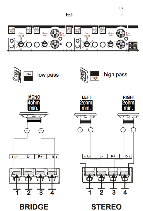

Yes.Can the amp twister f4 560 power the sub and 2 speakers by bridging maybe,if so how?
Like this:
https://www.samodelka.ru/pictures/data/f4.pdf
Consult the poorly written manual for details.
