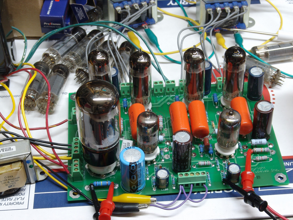

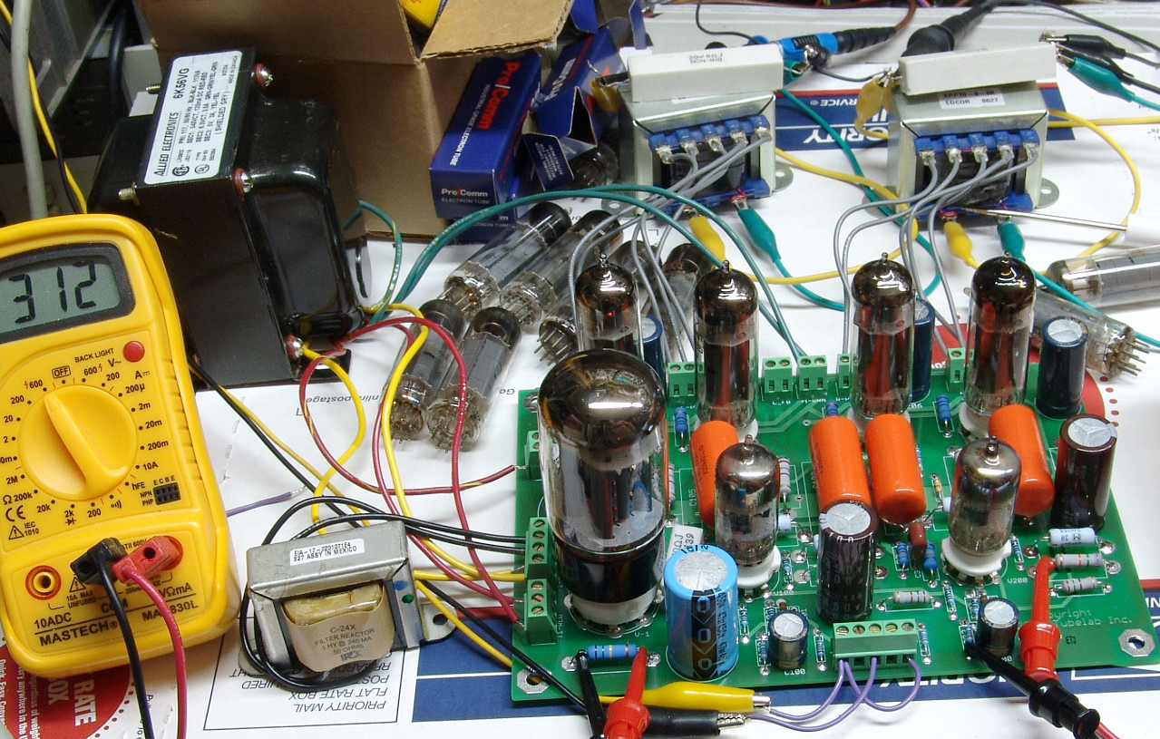

Well, Sherri got back into town yesterday after being gone 3 weeks. We had lots of stuff to do, but I still managed to "light one up". I can see several configurations for this amp, and like the Simple SE, I expect that most people will want the biggest power transformer to get the most output power. There have been several requests for a minimalist configuration, the best amp for the absolute least money. Since that was the first set of transformers that I came up with when I started scrounging, that is what I built.
I have an Allied 6K56VG power transformer and two Edcor XPP10-8-8K OPT's. The output tubes are some Russian 6P14P tubes that were $3.50 each on Ebay including shipping from the Ukraine. I have not had any time to optimize anything, so the board is as built. I am getting 10 WPC in UL mode at 3% distortion. Triode or pentode have not been tested yet. I am drawing a bit too much B+ current from the transformer, but it has been running at full power for 2 hours. The power transformer is cooler than the one in my Simple SE and the hot smell turned out to be the dummy load resistors. I found that many 8BQ5's work just fine since Hammond transformers supply nearly 7 volts on their filaments. These can often be found cheap.
I plan to do some more testing with different tube / transformer combinations. I don't think that these tubes can deal with high voltages, but I have some 7189A's to try. I will also test 6CW5's, they run at much lower voltages, but can be made to crank out some power too.

What's the driver tube on these guys? 12AT7? Is the schematic up on your site?
I'm intrigued that you opted to use a choke in the power supply on these. I'd assume that given the "absolute least money" directive, it would be the first thing to go. Sure, on a single ended amp it makes a big difference, but in push/pull doesn't a lot of the residual PSU hum tend to cancel out in the finals?
The schematic, or any new information related to the Simple P-P has not been posted yet. For now all that I have is the Eagle schematic which only shows the board mounted components. The driver tube is a 12AT7.
There is a resistor on the board with the two terminals to use a choke if you want. When I saw that a 150 ohm resistor was costing me 30 volts, I dug up a cheap choke with a 50 ohm DCR. I picked up 1 watt of power.
I wired it up in pentode mode, and applied about 5db of feedback. power was 12 WPC. Distortion at 1W is 0.17%. Power output below 50Hz was limited by transformer saturation.
I connected a CD player and speakers. It sounds very good, some saturation was heard on Money for Nothing, but if you stayed away from the saturation, the bass wag pretty good.
The sound quality was good, and easy to listen to. It will not strike fear ino the 75WPC all triode monster that I have been working on.
