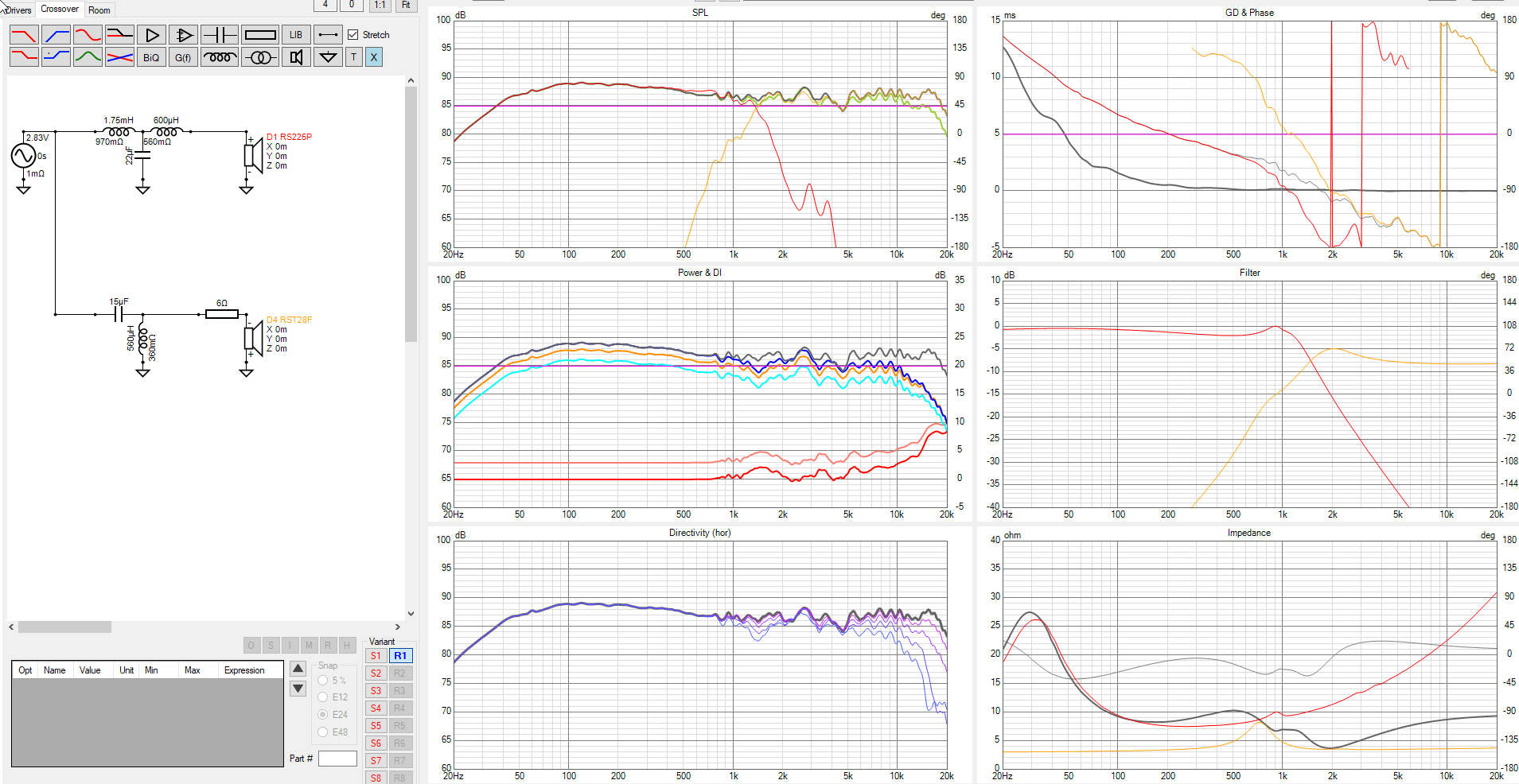

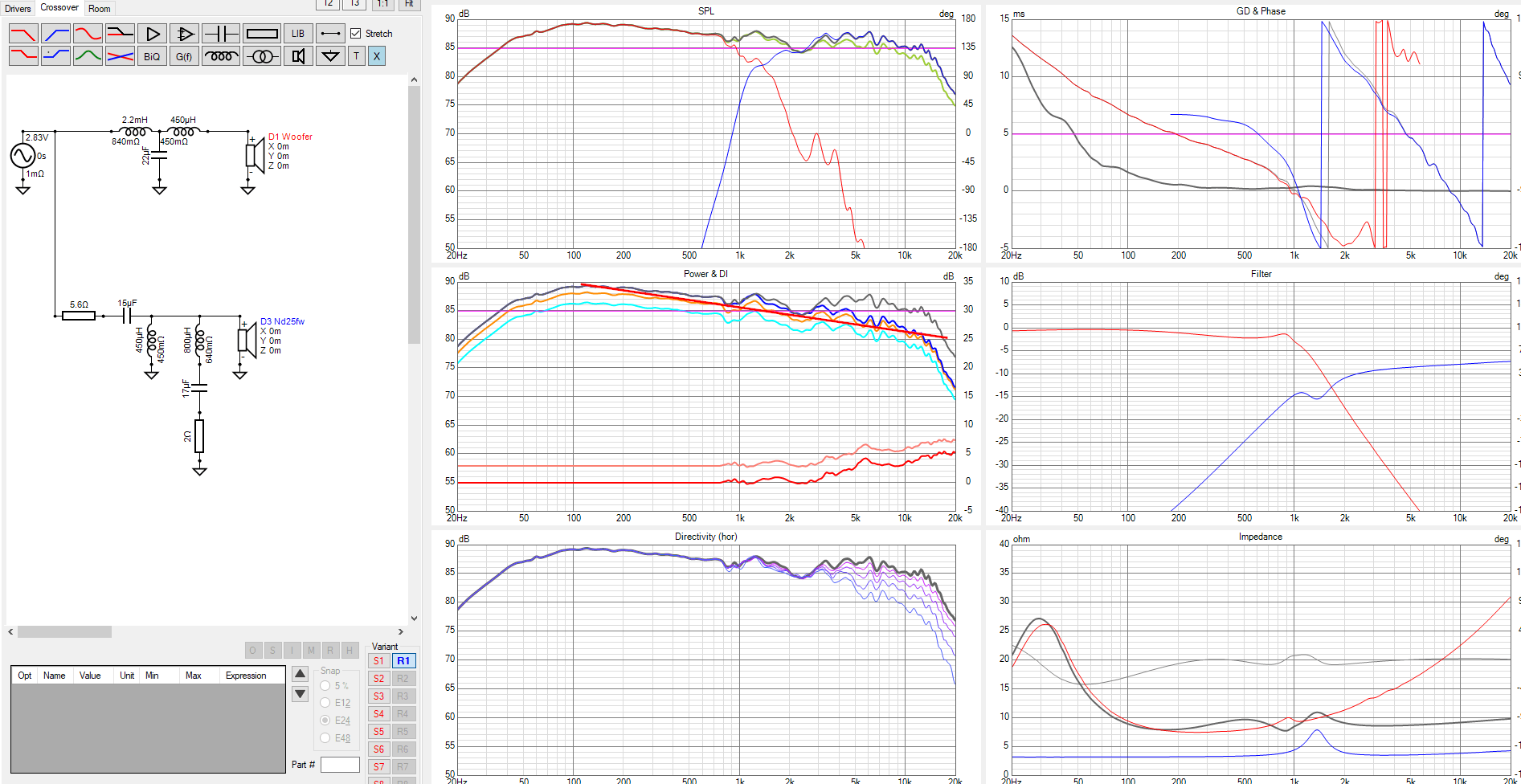

I am a complete beginner - so feel free to consider all of the below with sceptisism.
- As already mentioned transitioning from an 8" woofer to a tweeter you are going to have directivty mismatch problems. To help compensate for that consider using a tweeter with a waveguide - such as Dayton Audio ND25FW. The tweeter you selected has a spec sheet FR graph that doesn't match what's in the FRD files, it's rather uneven - choose something else.
- As for box size - PartsExpress recommends the following: Sealed Volume 0.55ft³ | Sealed F3 74Hz - I'm sure that's a reasonable suggestion
- The crossover - will need to be custom and I can't see how it doesn't get a bit complicated - so here's one I quickly sketched up (using RS225P-8A and ND25FW). Is it reasonable - I have no idea - I'm a complete novice. Still - I think this is a more likely to succeed than a random prebuilt Xover.
