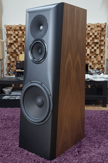

I have designed and built four pairs of active 3-ways using Hypex amps. The FA123 or FA253 are a very good product.
Your selection of drivers is a good starting point, but there is so much more to a successful design then just selecting the drivers. The layout of the baffle will define much of the performance. Baffle layout encompasses the size and shape of the baffle, the driver position and spacing, and the configuration of the edge. Once the baffle shape is set, much of the sound power and directivity performance become fixed.
I recommend that you get comfortable with VituixCad simulation software. Invest in a reasonably good measurement system, including a 2-channel audio interface and a decent measurement microphone with mic stand. To take full advantage of the simulation software, you will need to feed it some real driver data from a real cabinet. Be prepared to make a prototype cabinet to collect some measurement data, and then use that data in simulation to refine the baffle layout before making the final cabinets. Realistically, this is the best way to get a high quality design on the first attempt.

With the DSP capability of the Hypex amps, it is possible to get very deep high performance bass from the SB34NRXL driver in small sealed box cabinet.
The SB34NRXL-8 is a very capable bass driver. It is a wide driver, and needs a wide baffle just due to its size. However, in order to optimize the directivity performance of the speaker using a non-waveguide tweeter, the baffle area around the tweeter will need to be small, with a large chamfer or radius. Combining a 340 cm diameter driver with a small narrow baffle around the tweeter will require some complex cabinet shapes, probably some sort of trapezoidal shape for the midrange and tweeter, or pyramidal shape for the whole box... One possibility is to make the bass cabinet separate from the mid/tweeter cabinet.
A waveguide is another way to manage the directivity of the tweeter. Here is an elegant way of combining a 12" woofer, 6" mid, and waveguide into a good looking high performance cabinet. This is @PKAudio 's project https://www.diyaudio.com/community/...iesma-t34b-in-wg-18we-32w.365836/post-6777874

I think you will have to decide on the waveguide / non-waveguide question fairly early in the design process, as this drives a lot of other baffle design parameters. To achieve good directivity performance through the crossover region, a non-waveguide tweeter needs a very different baffle shape than does a waveguide tweeter. Baffle shape affects all other aspects of speaker design, both structurally and aesthetically.
I have a thread where I went through the learning process of simulating ideal piston drivers in a variety of baffle shapes. I made a lot of mistakes and tried a lot of configurations which led nowhere. But there is a lot of good information there…
https://www.diyaudio.com/community/...ations-with-ideal-drivers.380658/post-6880731
In the LCCAM thread, I knew what I was doing, and I was more successful in designing the baffle with simulation.
https://www.diyaudio.com/community/threads/compact-low-cost-active-3-way-speaker.402812/post-7440893
I am enthusiastic about your project. You have a realistic budget, and you seem to have some good woodworking tools. I don’t have a CNC router but I would like to get one some day.
j.
A man with his own CNC router will eventually feel the pull of designing a Translam cabinet. How big is your router table?I've made a few things on it but mainly signs and things like that. I've built a few sets of speakers over the years but figure its time to go all in lol.
What better way to learn.
This process may get me hooked. So there is a chance in the future i'll experiment with more elaborate designs.
The cnc can do 1200mmx900mm.
I think i will run with the non waveguide version, i like the look better. I can then experiment with baffle designs, roundovers, etc. I'll be experimenting quite a bit with designs on the CNC using offcuts.
I think while im going i might as well just lash out and get the Beryllium tweeter - TW29BN-B
In regards to Impedance, both come in 4 and 8 ohms, with a few db difference in sensitivity.
Is there a preference here when running the Hypex?
Thanks again!

I don't think it makes much difference.In regards to Impedance, both come in 4 and 8 ohms, with a few db difference in sensitivity.
In the case of the MW16TX-4 and MW16TX-8, there is a 3 dB difference in sensitivity. The hypex FA253 is rated at 250 W into 4 Ohm, and 150 W into 8 Ohm. In theory, the maximum SPL of the MW16TX-4 (250W) will be 2 dB higher than the MW16TX-8 (150W). But this is a small difference.
In my case, I chose the 4 Ohm version because there was no other difference in performance, price, or aesthetics. If there was any sort of advantage to an 8 Ohm driver, I would choose it with no hesitation.
Combining measured data from prototypes with VituixCad simulations is an excellent way to achieve high performance.

Thanks again Hifijim.
Some drivers are out of stock, so i'll get whichever impedance i can.
Another question to throw in the mix, I'm going to build a passive 3 way center channel, do i need to go to the same high end extreme with the drivers for the centre, i know they say to match drivers for voicing etc. The main speakers are high end for 2 channel music, so does the center have to keep up or its not as important as its just for movies. I could easily build a centre with the likes of drivers from your earlier build, SB17CAC35-4, SBA SB26CDC-C000-4, and a 5" mid or something along those line.
Thoughts?
