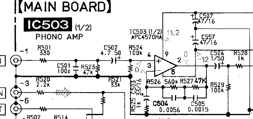

I do have this Sony GX69Es integrated amplifier that i like a lot, mated to a Technics Sl2000 turntable on a fresh needle setup.
i always found its sound to be "dry" no matter what.
i was wondering if any experienced electronics guru would dare to look at the schematic of the riaa preamp itself and pinpoints potential "improvements" to give more hump to this set-up.
yes i am thinking about altering the riaa curve or whatever that could improve its sound rendering.

Yes. We are modifying the values of the RIAA equalization components.
In this case, by increasing from 560k to 680k, you increase the low frequencies and decrease the average lows a bit, which are what give the sensation of "dry blow".

so you mean by changing the 560k to a 680k makes a difference in the low end response ?
A better value for C505 seems to be 1.57nF, so add a parallel 68pF across it.
All the other component values (including R526) are close enough as-is.
I have simulated replacing the capacitor C505 with value of 1.57nF.
It is closer to a flat response. But what you want is to decrease the "dry" sound and give more warmth to the low frequencies.

Increase R523 to 82 kohm; assuming an ideal op-amp, right now the input shunt resistance at audio frequencies is (R523 // R524) + R501 ~= 32.3 kohm, while all normal MM cartridges are designed for 47 kohm. This makes a difference for the treble, not for the bass.

You said it. It sounds "dry." This is a result of the fact that the frequencies between 150 and 350 Hz are stronger.
If you want it to sound with a serious less "dry", more pleasant you have to decrease those frequencies slightly and accentuate the frequencies from 20 to 50 hz.
With regard to the RIAA curve "perfectly flat" is debatable, since the recording engineers themselves alter it. Listen to a record of a same disc and the label of another label and you will notice the differences in sound. It also depends on the charge of the cartridge, which in an integrated amplifier can not be varied (load impedance and capacitance).
The important thing is that you agree and that you like what you hear.
There are famous brands such as Rotel, Marantz that slightly emphasize the frequencies between 20 and 50 hours, as well as DIY kits that also do it (Rod Elliott Kit, VSPS400).

i have a 10 bands equalizer to make me agree to what i listen too (!), but overall i am disapointed of my turntable set-up.
so i will try the mods today but rather than juste stick with the given values i will try some combinations with potentiometers and switches to listen before/after mods.

i would like to revive this thread as i builded on a veroboard the SONY version (first schematic) with the suggested modifications. Any other concerns i should look for about this particular schematic ? i want to build "around" this method. thanks for any suggestions and helps.
do you think it will increase the treble or decrease it ?
i dont masterise yet the effect of the load on MM cartridge.
thanks.
You should get more treble with 47 kohm than with 32.3 kohm.
thanks
i made my prototype with dip switches so i can change the load on the fly, the cap load also with 3x 100pf steps
change is very subtle i would say. overall is sounds less dry with 300pf load and "real" 47k. feels more warmth
