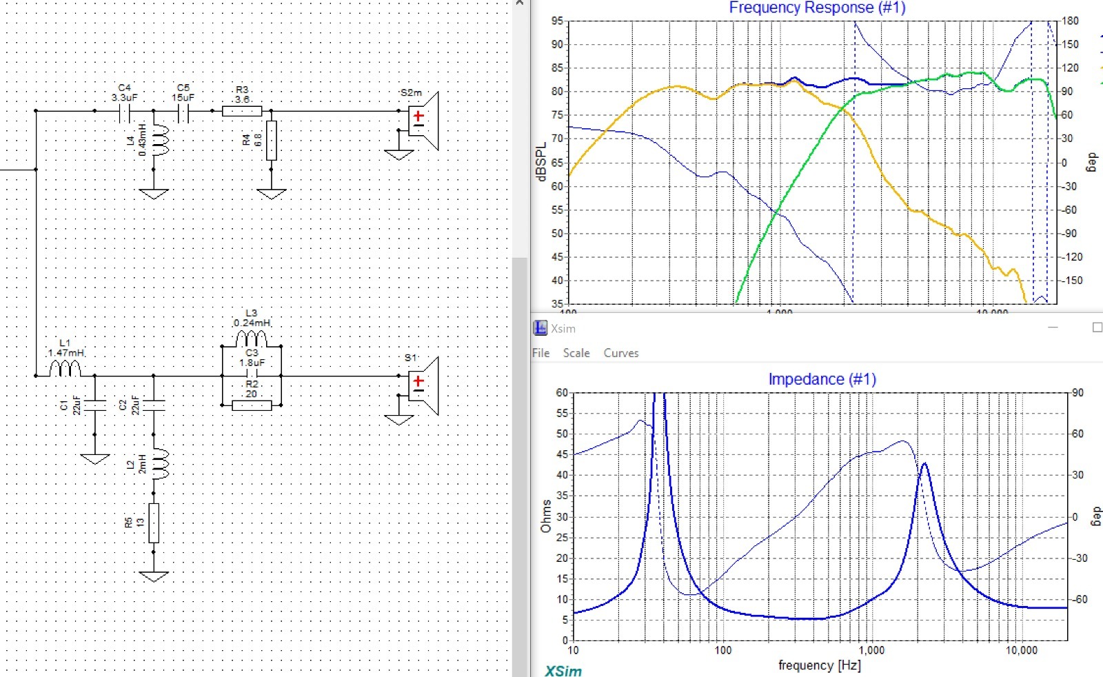

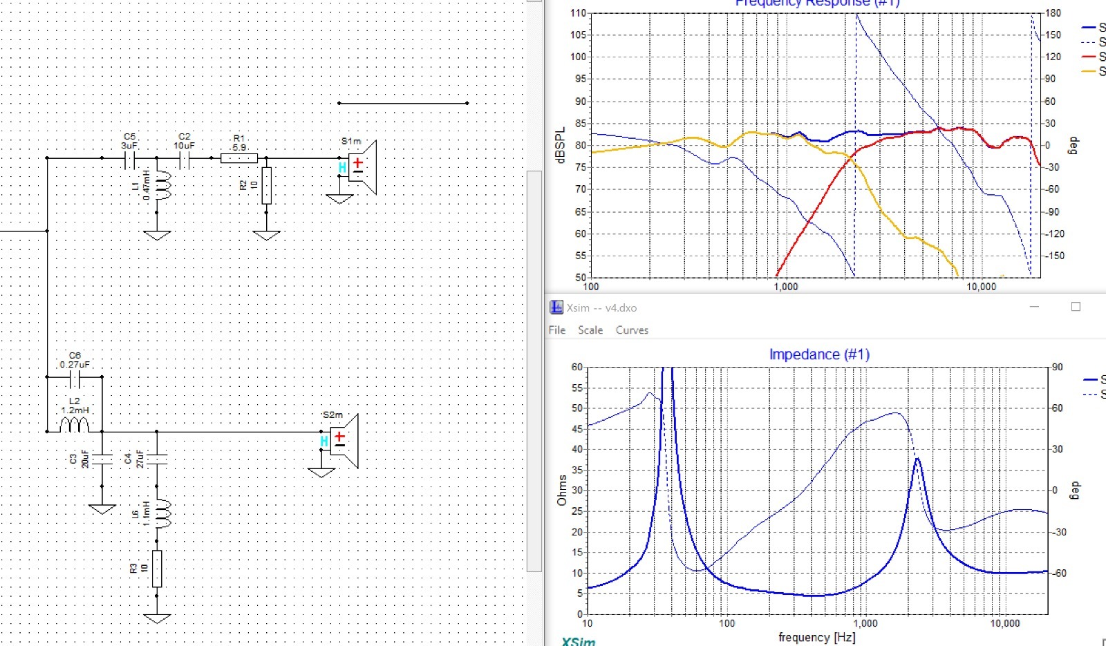

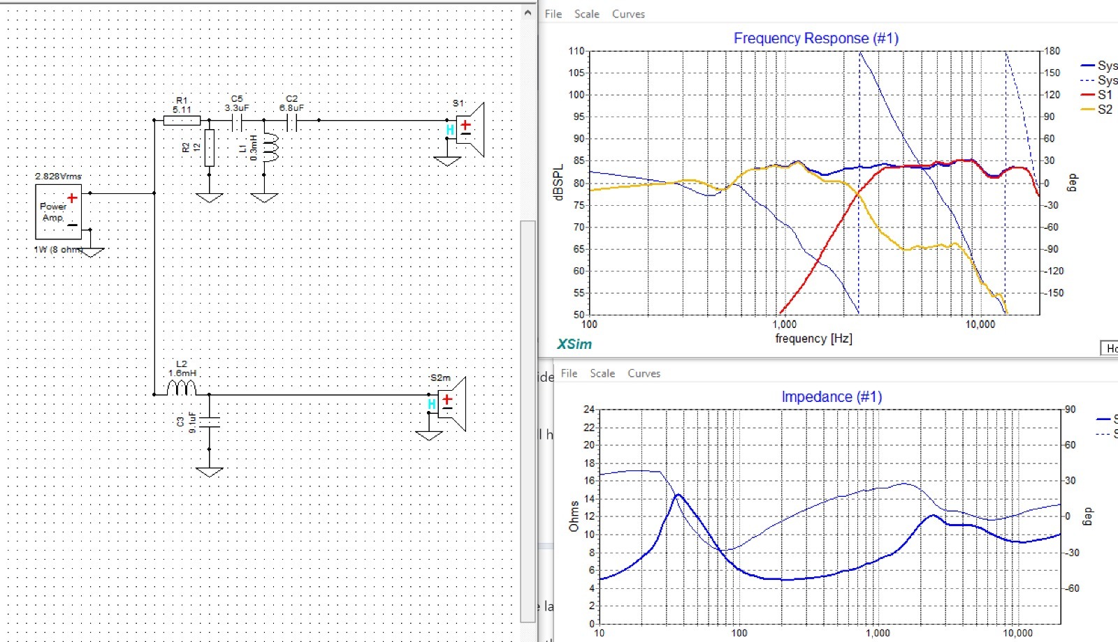

From what I understand about your woofers upper frequency response > a R/C Zobel network should be considered essential.Here is a crossover design I put together:
View attachment 1312123 .

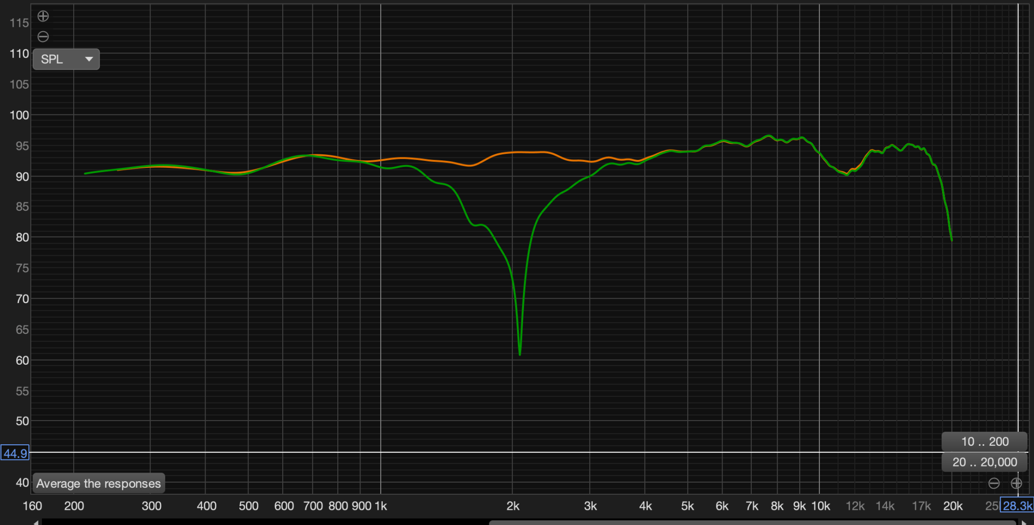

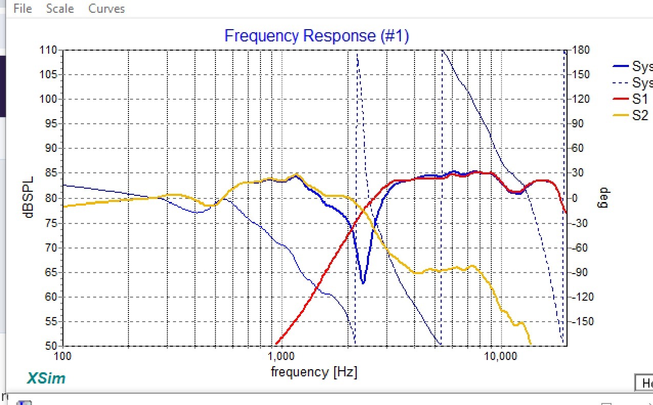

I am getting quite a null in reverse polarity (should it be better?)
The overall response looks kind of satisfying, but I am concerned about the woofer's persistent break up. I was able to knock it down with a 3rd order filter but then I had trouble getting the reverse null. Do you think it's fine if I leave it like this or is it going to be audible?
Along with tweeter 'polarity wiring', the listening height of the speakers can make huge differences to CO frequency nulls.
The difference between tweeters below ear level compared to tweeters above ear level can even remove a null.
You need to place those LPAD resistors AFTER the xover. They are across the input and will get hot.
Thank you for pointing that out, I knew something was sketchy about it. At first I've placed them to the tweeter side but in that case the impedance curve was off the charts (literally)
I am not very good at interpreting the impedance charts but I don't think this looks good does it? Can anybody explain what is happening here?

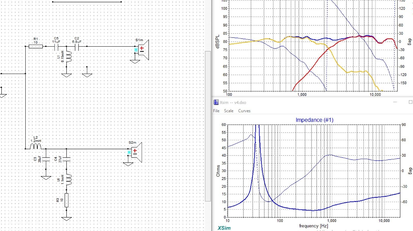

I gave it a try but the tweeter side doesn't really work for me since my tweeter is in a waveguide. However that paralel CLR on the woofer helped a lot in knocking down the energy around 700-1.5k.
Are you most definitely certain that the break up frequencies gonna be a problem at -20db's? I am asking because I am finding it really difficult to keep my parts count at a moderate level. I am already at 4 caps 3 resistors and 3 inductors without the zobel network.
By the way I am attaching the .frd and .zma files in case anybody is interested...
I seem to be loosing track of which circuit diagram is your current/new/final version.I gave it a try but the tweeter side doesn't really work for me since my tweeter is in a waveguide. However that paralel CLR on the woofer helped a lot in knocking down the energy around 700-1.5k.
The circuit just above includes a CLR network across the woofer, which is effectively what I was referring to re. woofers impedance & response.

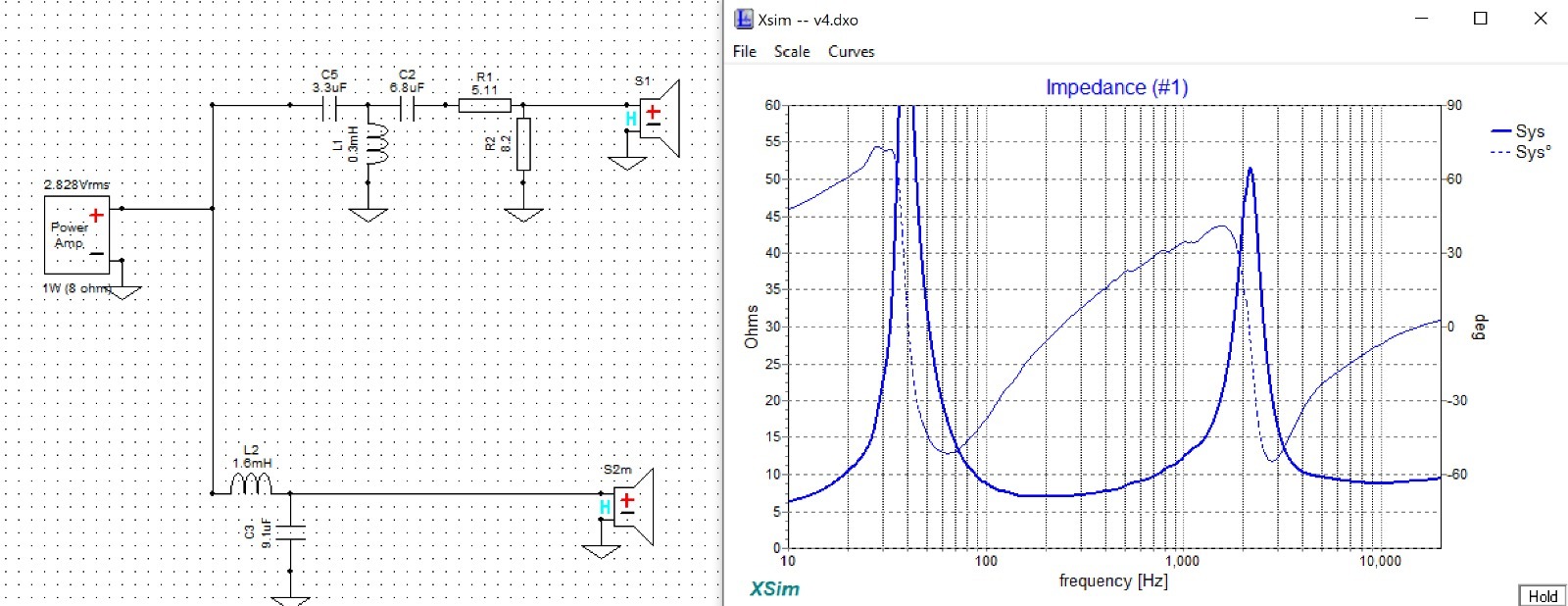

Nope, didn't help.You can try the series resistor before the xover, and the parallel resistor after and see if that improves things. The parallel resistor before the xover is what creates the previous issue.
That CLR you are referring is for taming the area roughly around 700-1.5k. I needed to add another CLR network to knock down the cone breakup as you can see on the graphs below.
before:
after:
My question was if I must include this additional network for the higher frequencies. Is that breakup going to be a problem when it is -20db's lower than the overall response. (bare in mind this is a paper woofer not aluminum or something like that)

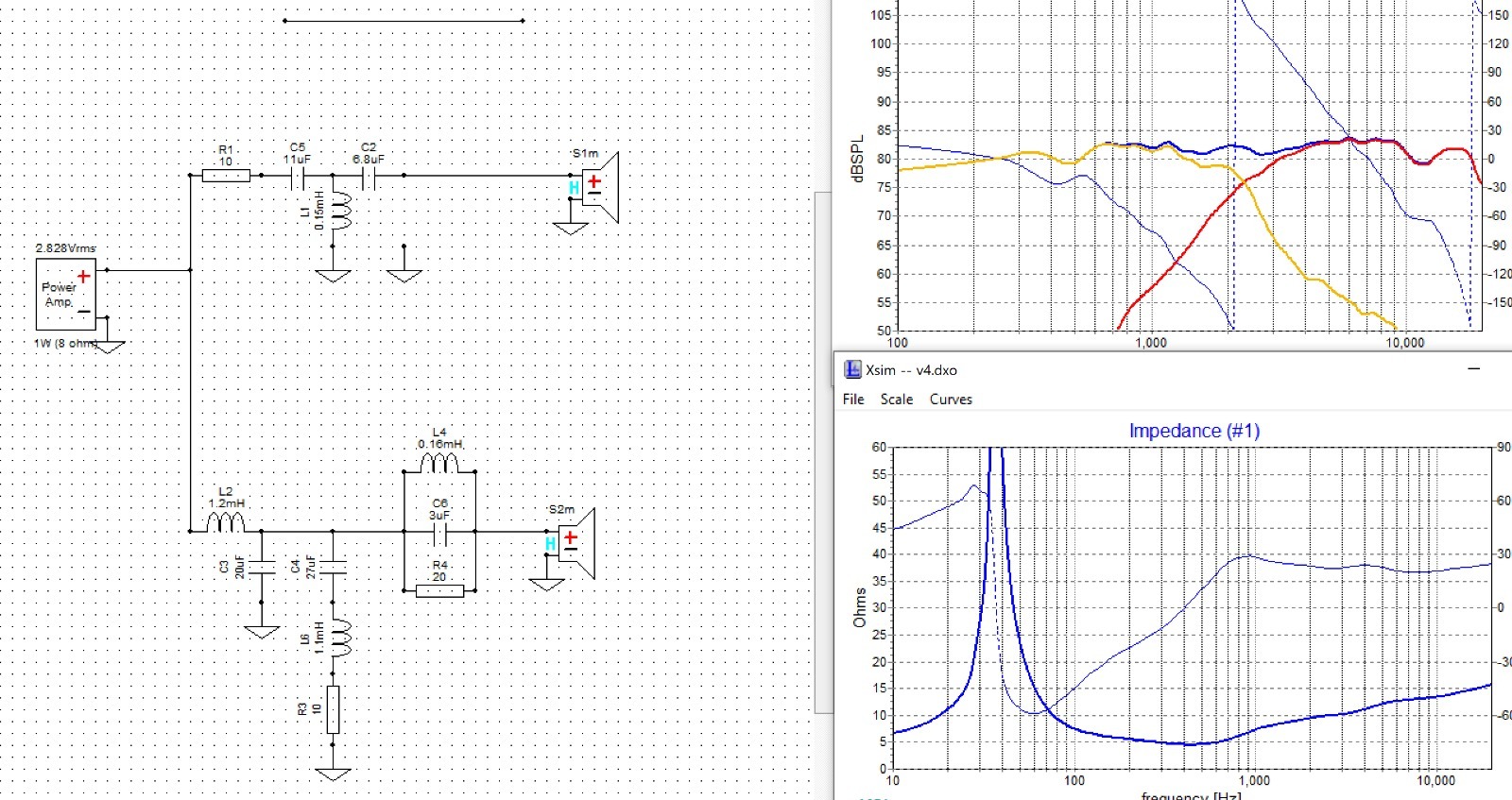

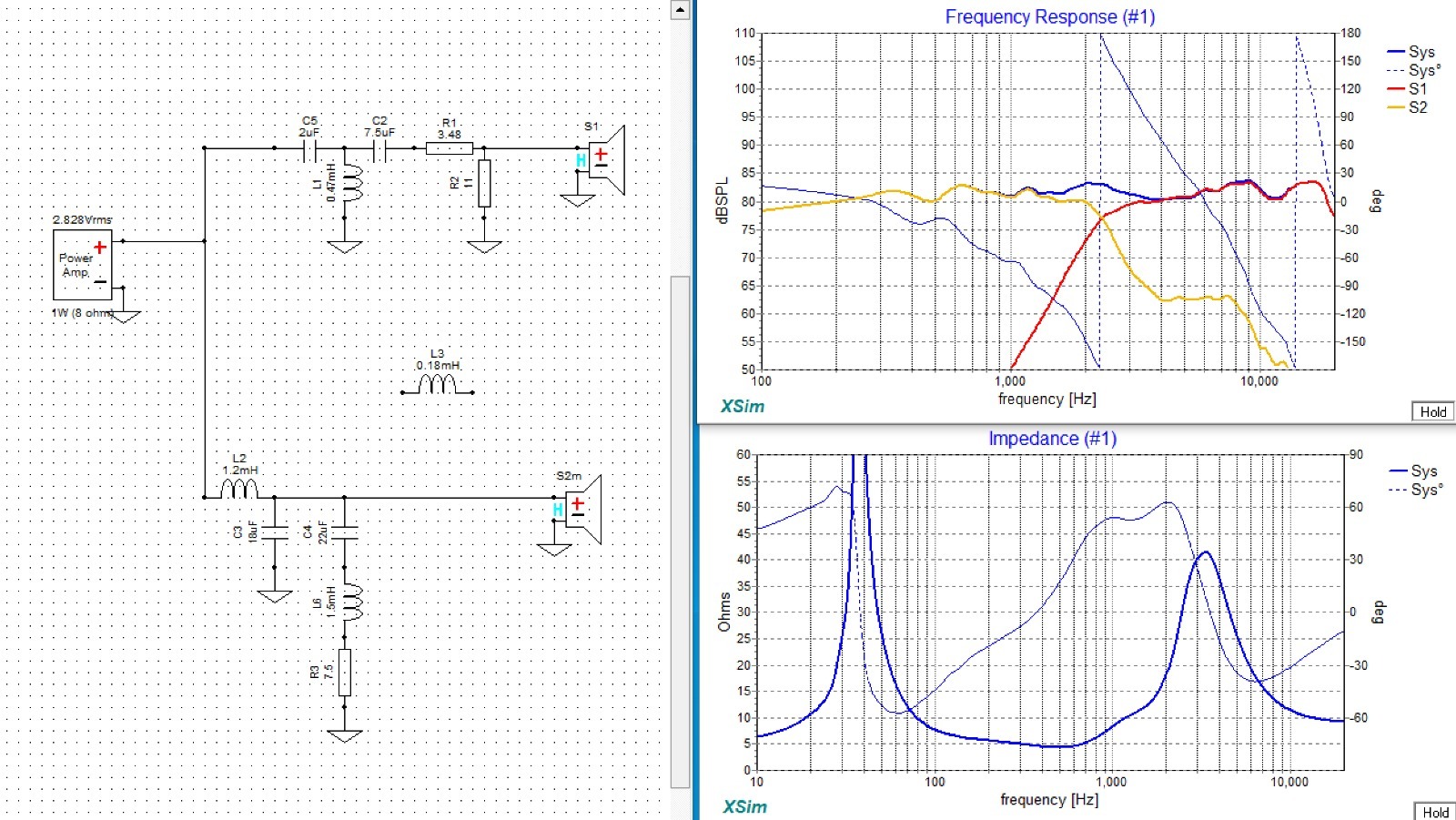

I have given it a try, doesn't really work in my case

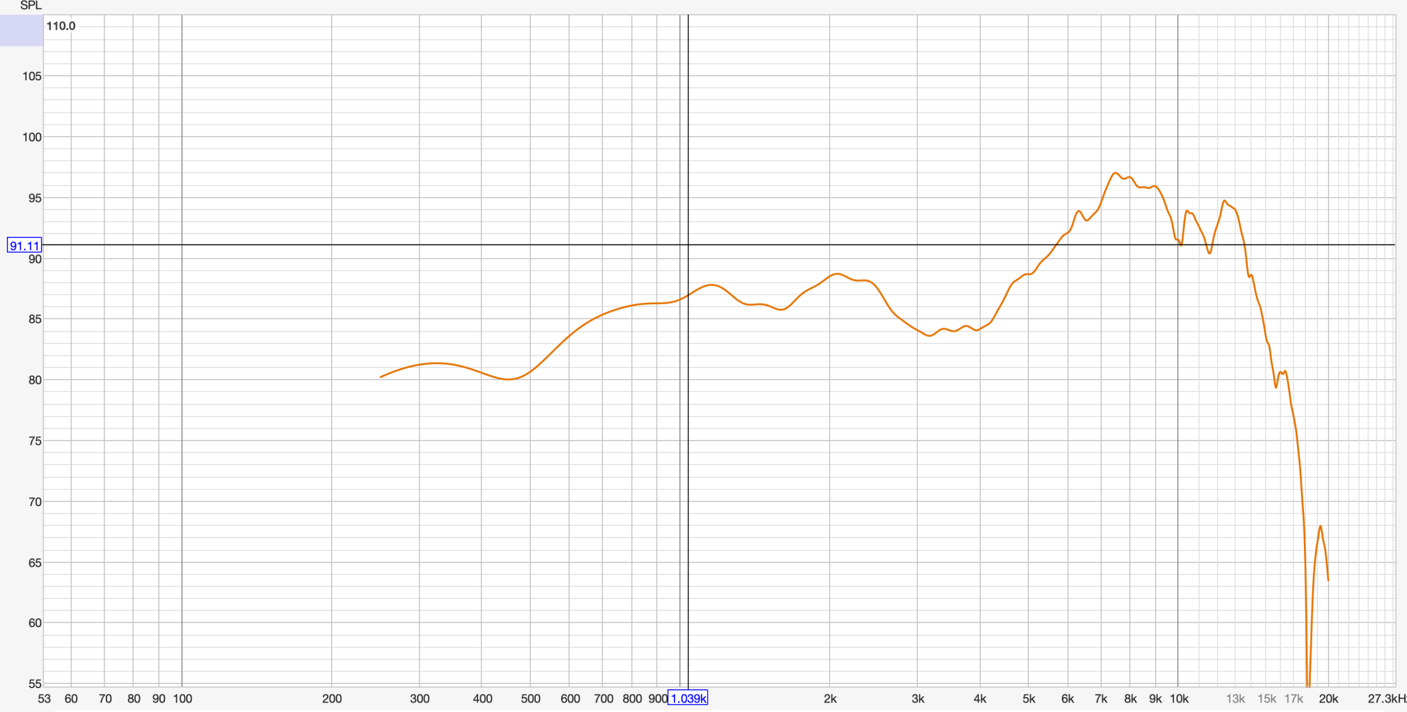

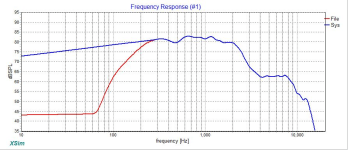

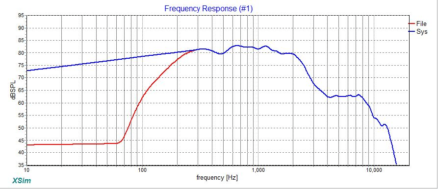

Does this sound light in the bass?
Two reasons. Your chosen crossed sensitivity level may challenge the lower hundreds. You say this is baffle step but it may be anomolous data from your gating.
Secondly, you have used the tails capability in the Xsim Hilbert function to modify that region.
My gated measurements are from 250hz on, below that is filled in xsim using the hilbert bode function. My concern was the difference between the 250-500hz region compared to 1k onwards.
this final crossover design I made flattens that out but yeah lots of sensitivity is sacrificed... I don' know what's gonna happen around 100hz but I believe I should be fine given that area is almost always all over the place (in room), and I always find my self applying some eq for room correction at that region (100hz and below)

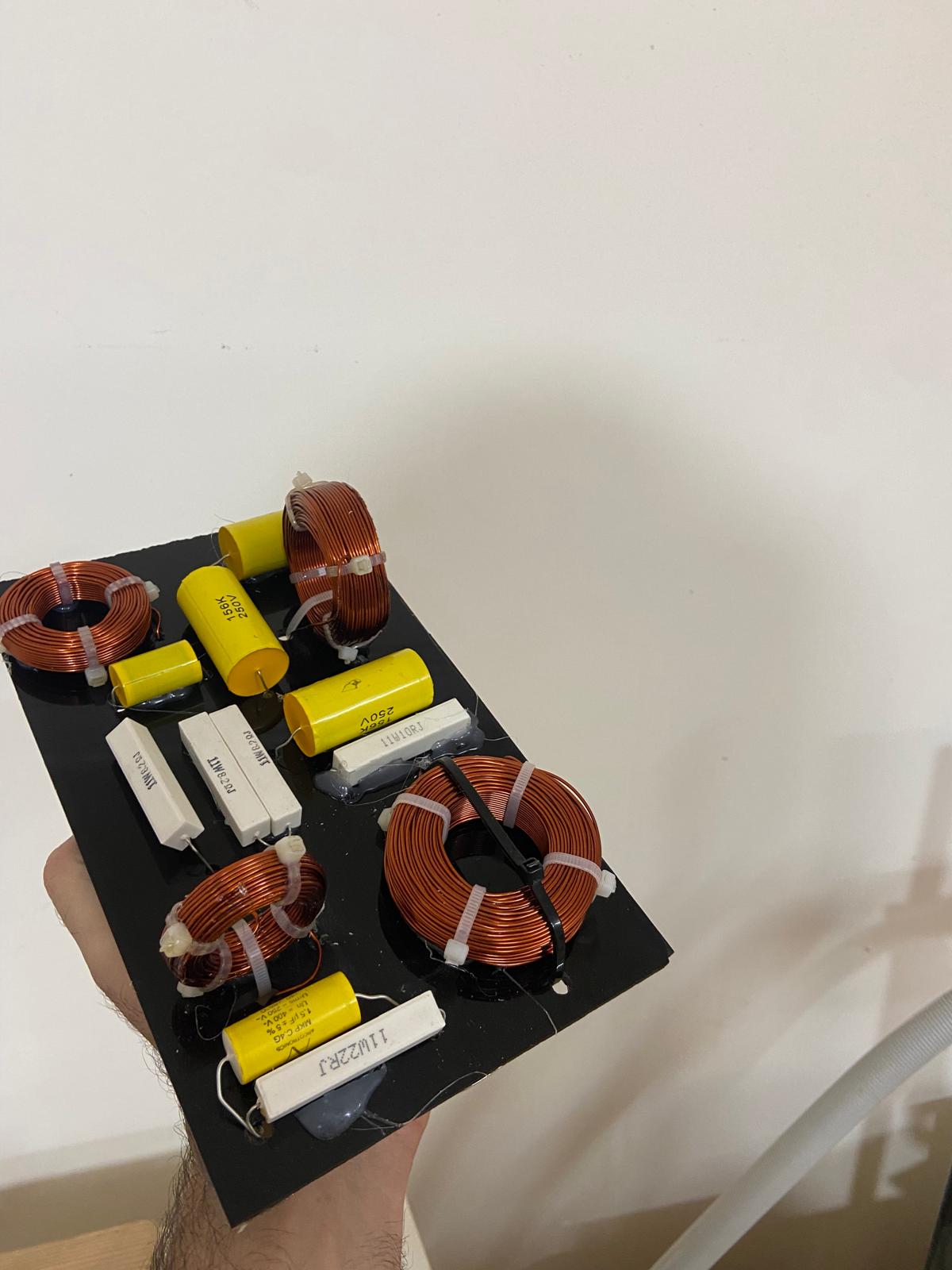

I think you will find the treble hot. If you increase the 3.3uF(C4) a smidge the tweeter response will flatten out. Then you can pad it a little more and have flat response. If the top end and dip still bothers you, try a cap across R3, likely 1-3uF. This will lift the top octave and maybe the dip too. The average person 40+ will not care if there is a small rise above 10k. Be careful not to increase 6-10K though, as that is the sibilance range.
- Restoring an awful DIY speaker
