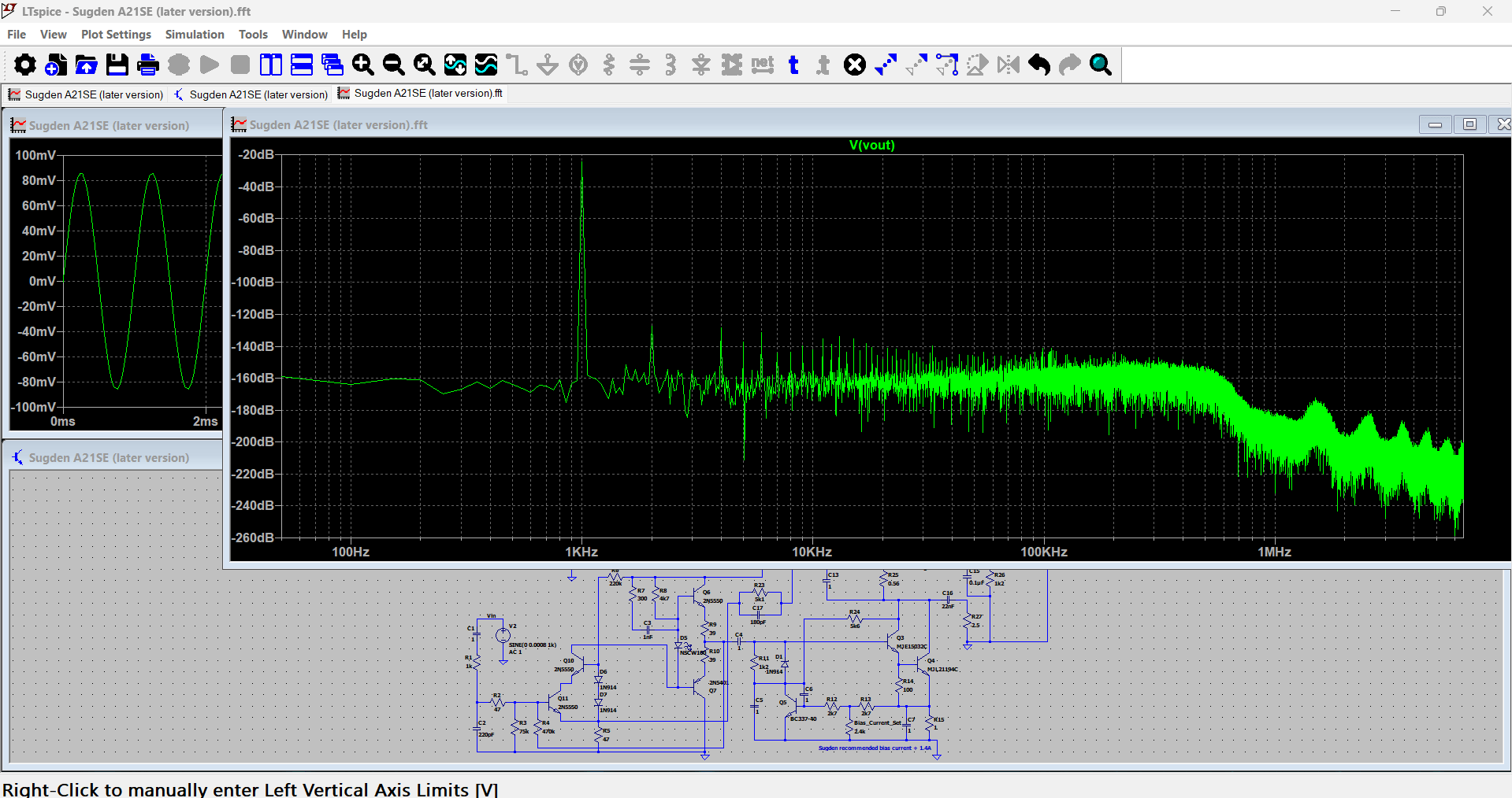

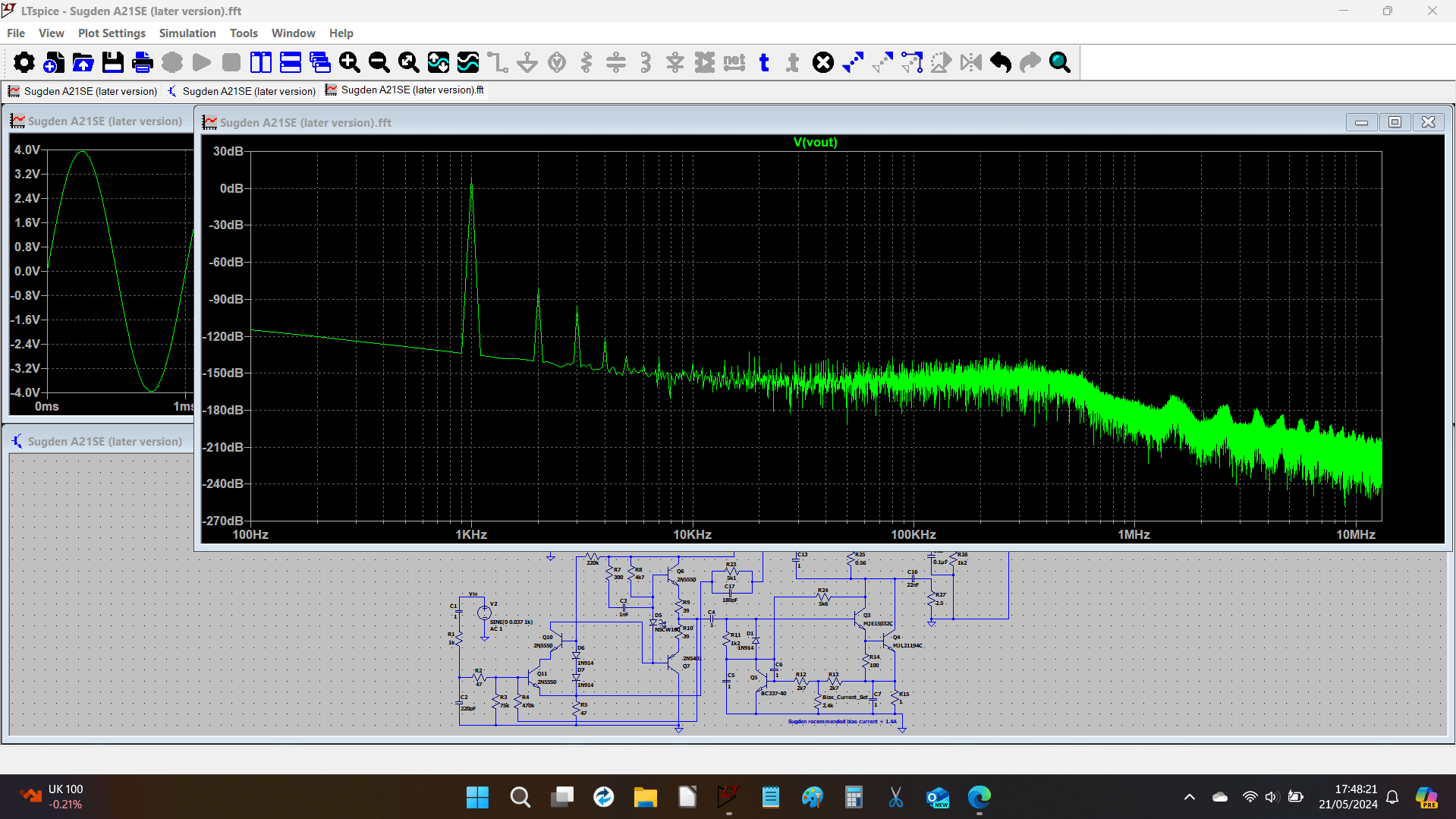

So the Class A section of the 405 and subsequent 909 seemed a good means of avoiding the expense of a Sugden - although I have also bought a 'Headmaster'.
The Quad and the Sugden are poles apart in their design goals... I know someone who used to have a Quad 405 set up and who went over to Sugden. I've had the pleasure of visiting the factory in Heckmondwike some years ago... quite an experience.
Quad 405 vs Sugden A21SE at 1 watt into 8 ohm.

Thanks for the plots Mooly.
That is a graphic expression of the differences. However, unless there is a rather large lottery win coming in my direction, I shall be living with my 909 for some time to come. Having has an early Sugden, I know how good they are. But, second hand prices are ridiculous despite, in some cases, despite their age and the obvious thermal decay. From what I have read, folks have been making ''Improvements'' to the 405 for quite some time now, probably focusing on the ''Feed - forward'' signal, via the Bridge. However, I doubt that Quad have been resting on their laurels. So it would be interesting to compare the 909 under the same conditions.

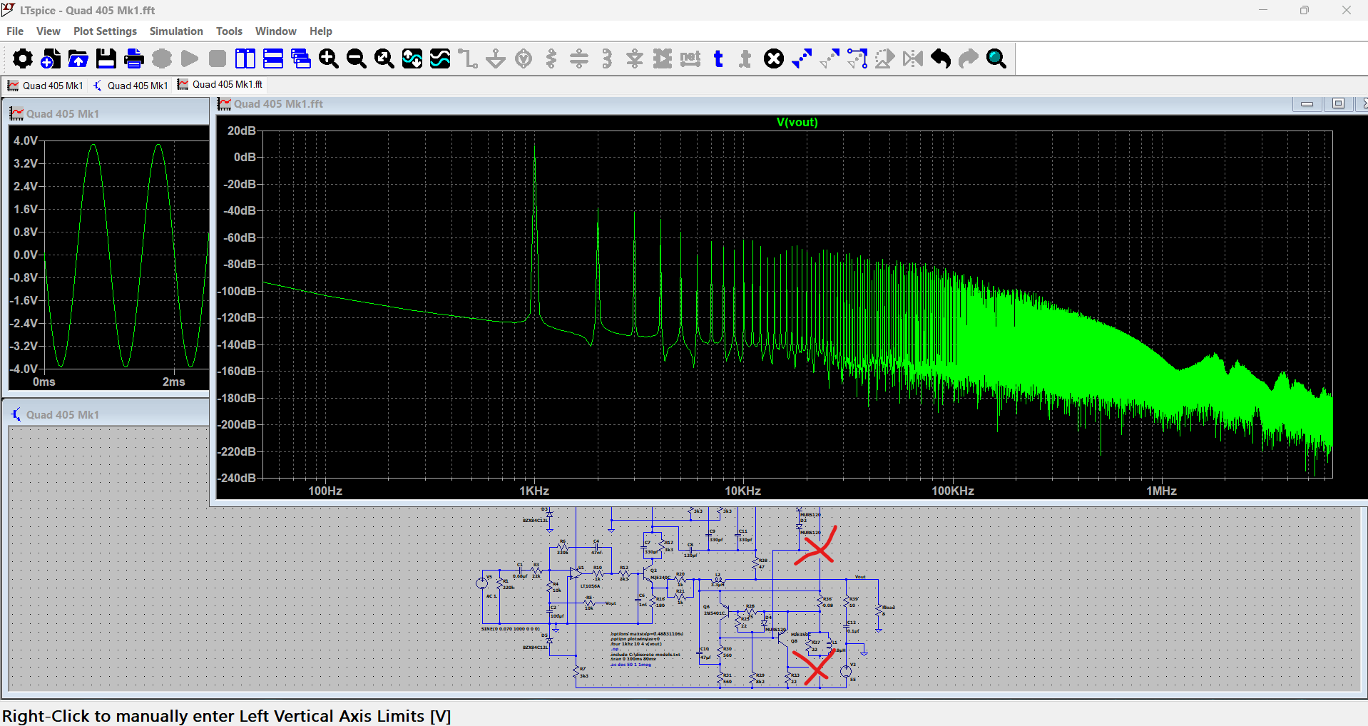

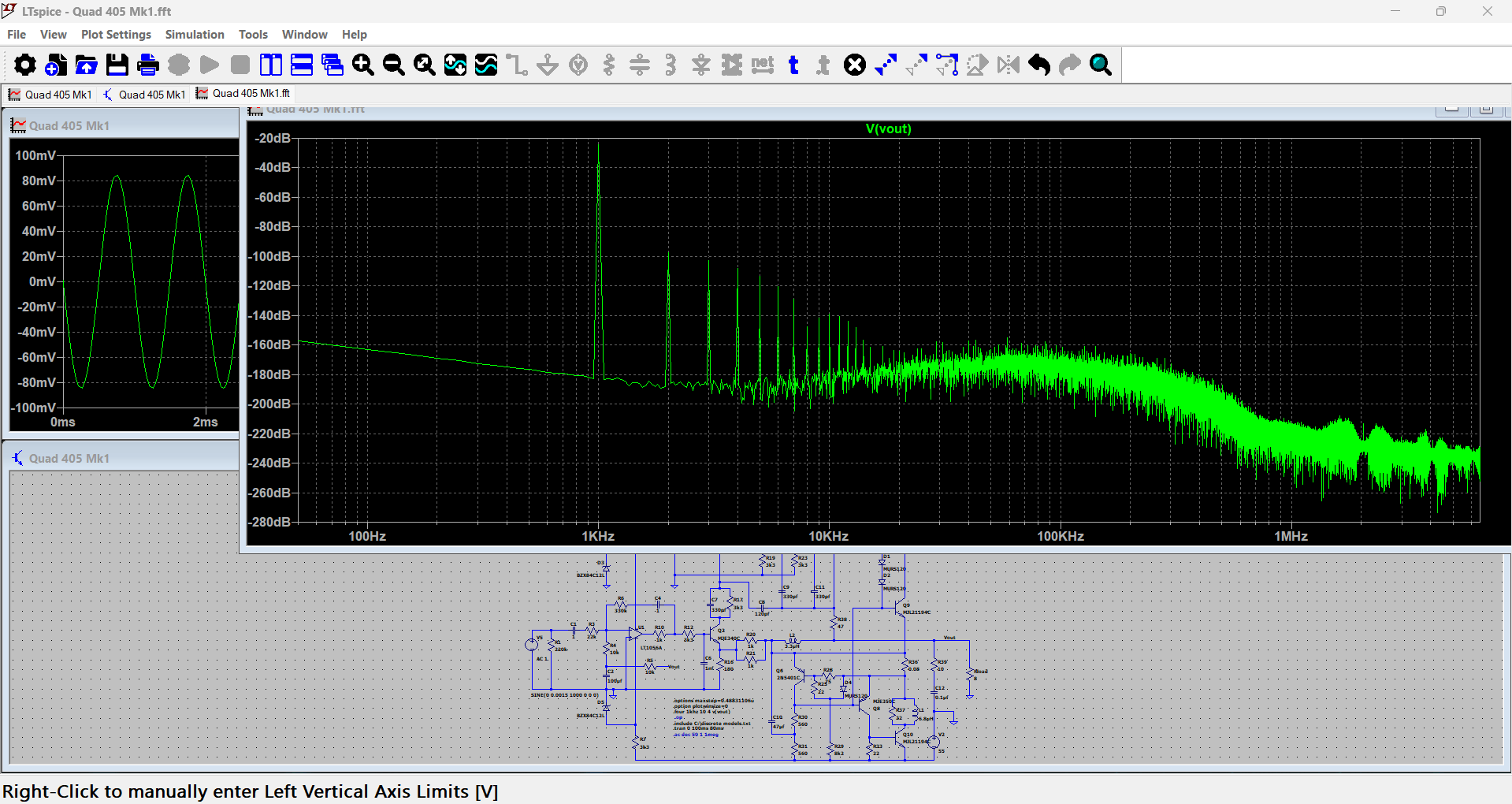

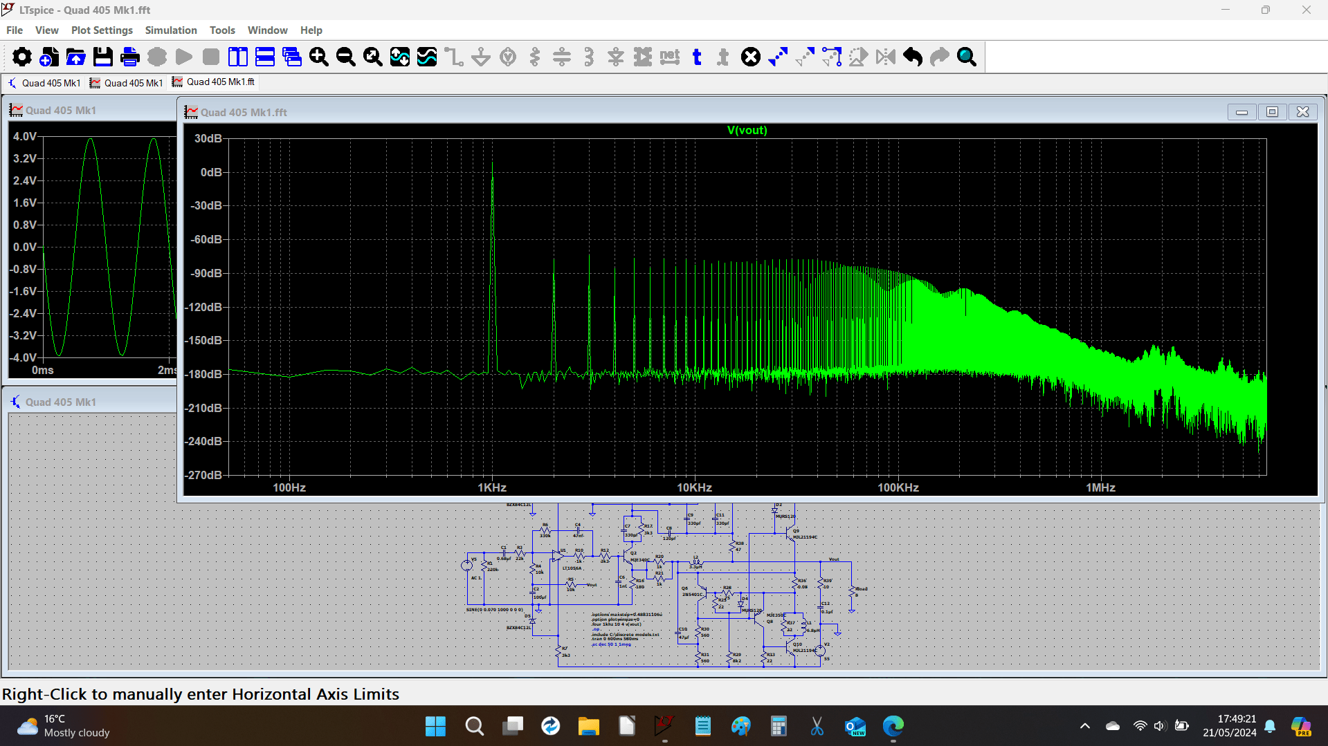

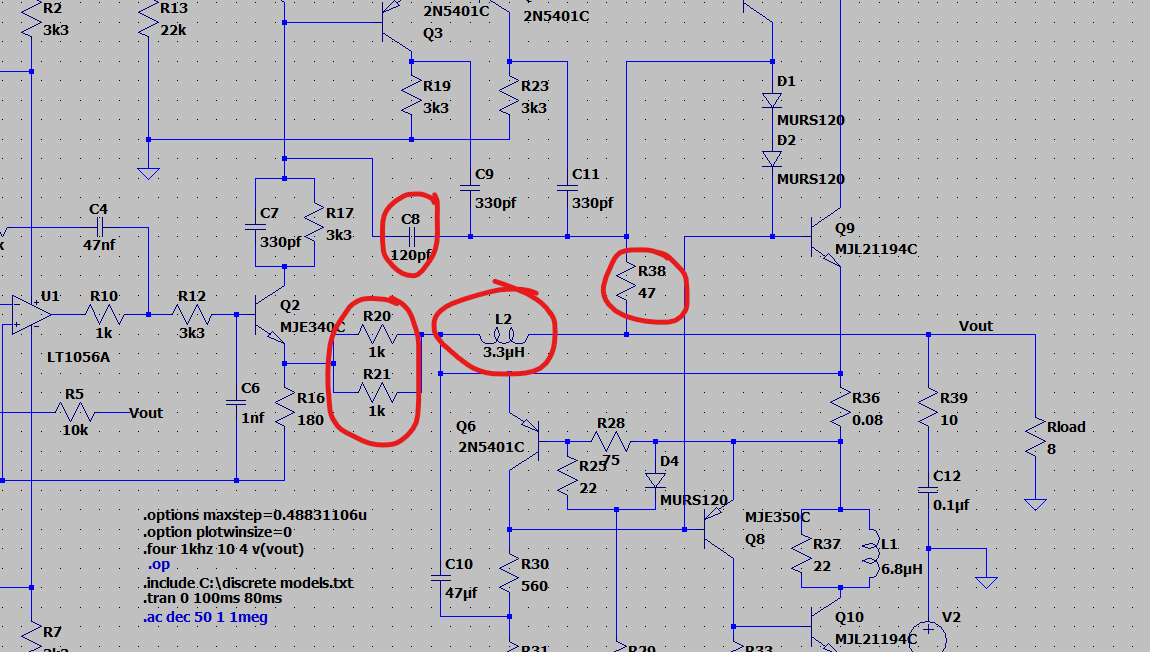

The 405 is not an easy circuit to analyse. 1 watt into 8 ohms is achievable without the dumpers in circuit but the circuit still displays all the distortion artefacts at those levels.
No dumpers fitted:

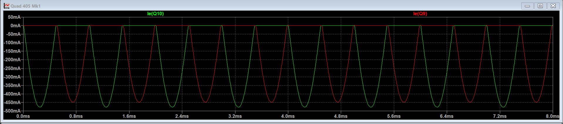

With the dumpers fitted they actually take over at this low level as can be seen by the emitter currents of the dumpers:
Output levels need to be lower than around 200mv peak to peak before the dumpers cut off. At this point the FFT is more Class A like but no match for the Sugden.

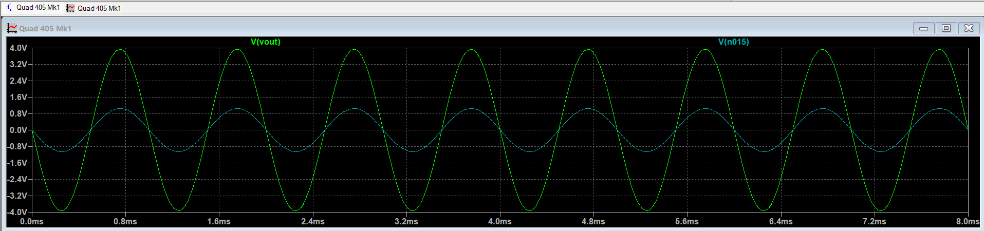

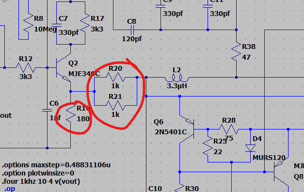

Voltage gain from base of first stage to output node:
Giving a gain of 3.7 or 11.4db (by looking at the rms levels at those points in the sim) which agrees very closely with the expected gain set by the feedback resistors:
500/180 + 1 gives a gain of 3.77

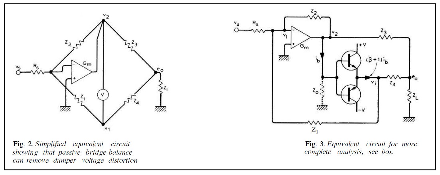

The dumpers are slow slow slow in comparison to the other circuitry.Thus, being amplified by the hypothetical 30db, will switch on the dumpers; and off, in an incredibly short time.
If you understand the operation of the bridge, it is clear that any 'slowness' of the dumpers is not very important.
With the bridge in balance, any voltage difference between the bases (input) of the dumpers and the output voltage (the 'error voltage') will not appear at the output. So the speed at which the dumpers come on or go off is immaterial, as long as the class A stage can keep the bridge balanced.
That's right When I mentioned them being 'slow slow slow' it was in response to the comment about them having to switch on and off very quickly... they don't.

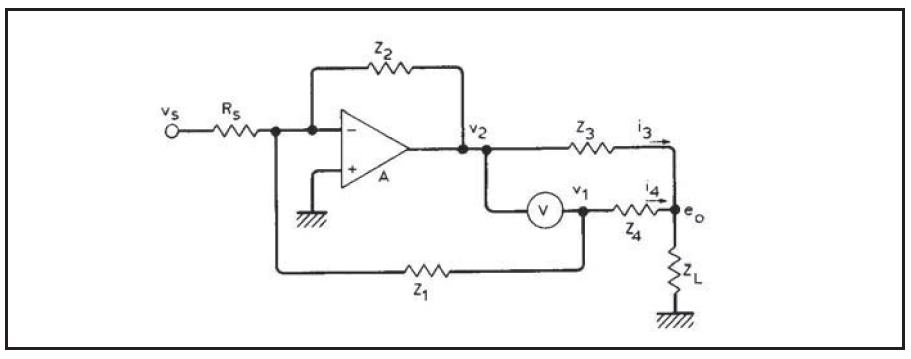

Quite a short but good and readable analysis of the 405 was given by John Linsley Hood in his book "Valve and Transistor Audio Amplifiers".

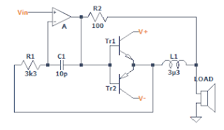

I must be a minority but I believe the whole "bridge" concept in CD amplifiers is rather confusing and hides, rather than explains, how a CD amplifier functions. IMO a CD amp is a normal feedback amp where the load is driven by both the very linear amplifier A and the not-so-linear current dumper Tr1 Tr2:
A little analysis (qualitative or with some algebra) shows that the perfect cancellation of the current dumper distortion happens when the ratio of impedances of R2 and L1 mimics the loop gain of the integrator formed by A-R1-C1. While not contradicting Walker's original results, this opens way for a better real-life CD amplifiers, where e.g. L1 has some DC resistance, and the integrator has a finite DC gain and/or non-6db/octave-single-slope transfer function.
@alexcp, I don't see how your explanation is different from Walker, Vanderkooy et al.
Comparing CD with Sandman's concept also gives insight.
Note that R4 in fig 5b of Linsley Hood makes all the difference - it completes the bridge!

Without a shadow of a doubt. Walker did make the DC loop gain of the Quad high (to obtain a "good virtual ground") and mentions a resistor in parallel with the bridge capacitor, which would compensate for other parts being non-ideal.Peter Walker certainly knew his stuff
Walker's analysis only works, at least precisely, for zero-DC-impedance inductors and infinite-DC-gain, single-pole-compensated amplifiers with the time constant set by the "bridge" capacitance. The insight about the ratio of impedances mimicking the loop gain allows for e.g two-pole-compensated amplifiers, which would not be so easy to incorporate into the "bridge" concept. I will show a (simulated) example, but it will take some time for me to post it.how your explanation is different from Walker
Still, instead of perfecting the distortion compensation, it may be better to just increase the loop gain, which would take a better care of the current dumper's distortion.
