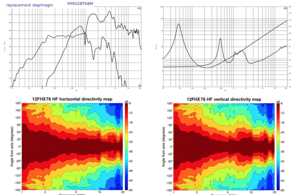

I did not say you "measured it wrong", I wrote "your unfiltered measurement curve deviates at points by more than 8dB from the published response curve, perhaps because it was made too "close up" to the horn.On my B&C drivers, it is taking 9 out of 10 PEQs to "tame" the response. Art (Weltersys) says I measured it wrong (too close), but I don't think changing the measurements will change the result in terms of filtering required.
Your 9 PEQ choices made for that measurement location will not result in the same response at other measurement locations."
The HF section of the B&C 12FHX76 could be brought to reasonably flat on axis response with the crossover LP filter, two peak cuts, and a HF shelf boost.
That said, it's horn's nominal 60 x40 directivity response is poor (typical for a co-ax), going past basic EQ on axis will tend to make response worse off axis, note how the frequency peaks and dips correspond to directivity changes:

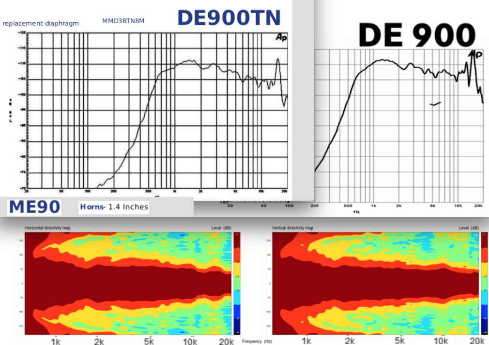

Compare both frequency and polar response to the B&C DE900TN (same diaphragm as the 12FHX76) and the DE900 (mylar surround) on the nominal 80x60 degree ME90 horn:
A single filter could render those drivers reasonably flat on and off axis, other than the HF breakup peak.

As you can see above, the horn has far more influence on response than the driver.Here's a new question. If I am trying to match compression drivers, should I play it safe and pick a B&C CD that uses the same diaphragm, same efficiency, and same power handling? Or would any titanium CD be a close match?

A horn's compromised directivity response can't be fixed by replacing a diaphragm or with EQ.
