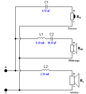

If, for example, I use a 1.6mH inductor for the bass, should I use exactly the same in the midrange filter?
Also, the capacitor I use in the tweeter should I use the same in the midrange filter? the famous LC
You can answer your own question by using a 1st order, 3-way crossover calculator.
https://goodcalculators.com/crossover-calculator/
This is a the result of inputting 8 ohm drivers, an fL of 500 Hz and an fH of 4,000 Hz.
EDIT: It won't suit real world drivers very well though as they do not necessarily measure 8 ohm at the crossover frequencies as Dave Bullet explains below.

The on-line calculators take a too simplistic view. They assume both drivers have the same impedance at the crossover frequency, and are the same sound SPL output (sensitivity) and they have the same frequency response (that is neither driver is already tailing off).
Often the woofer inductor will be larger in any case, as it is used to manage baffle step compensation.
Basically - you need to start with as I said, the acoustic responses of the raw drivers, and what parts are added to the crossover to shape that drivers response to align to the intended acoustic rolloff and crossover points you want. then you add more parts (or change topology) to improve the phase alignment between the drivers, checking overall impedance as you go to make sure you don't cause any nasty minimum impedance issues.

"If, for example, I use a 1.6mH inductor for the bass, should I use exactly the same in the midrange filter?
Also, the capacitor I use in the tweeter should I use the same in the midrange filter?"
I can't think of an example I've looked at, either two or three way, which does that: for example, look at Paul's crossovers for his Tarkus, Pit Vipers and Dayton Classic Revivals. Have a look at the values of the parts: no way would a calculator come up with anything as good.

Do you know where I can find topics or pages that teach me how to make an LC filter for midrange... that talks about values and such.
I need some direction.

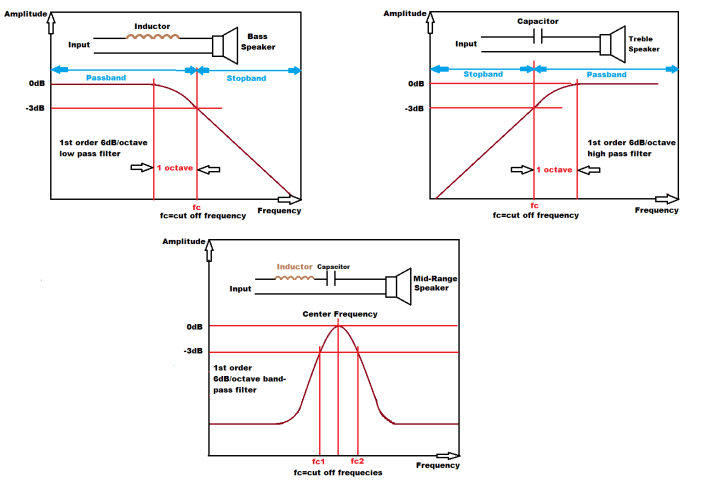

First, you may benefit from looking at the basic operation of a 3-way loudspeaker's band pass filter:
The series LC filter on the midrange is called a 'band pass" filter because it only passes a central band of frequencies.
In the above circuit, L1 opposes high frequencies while C2 opposes low frequencies, allowing only a band of central frequencies to reach the midrange driver.
The effects of the low pass, high pass and band pass filter sections are shown below. Note that the frequency cuts are not sudden, but slope off gradually.
Let me know if information like the above is helpful in aiding your understanding. If it is not, I will cease supplying it.
I read about bandpass, the issue is that I can't reason or find something that teaches me how to find the values for the LC circuit.
In my head, I would remove the treble and bass that went to the other speakers, leaving only the midrange for the midrange, so I would use the same capacitors and inductors that I used in the other speakers and use it in the midrange.

For the tweeter and subwoofer, there are even tables on the internet that show the usual filters for each type of frequency desired.First, you may benefit from looking at the basic operation of a 3-way loudspeaker's band pass filter:
Yes, what you are looking for does not appear to be out there, at least in simple terms.
The mathematics is obviously difficult and that's why people use a computer program to do the calculations.
I can only offer this calculator (shock horror!) for you to play with: https://www.claredot.net/en/sec-Sound/band-pass-cross-over-6dB.php
