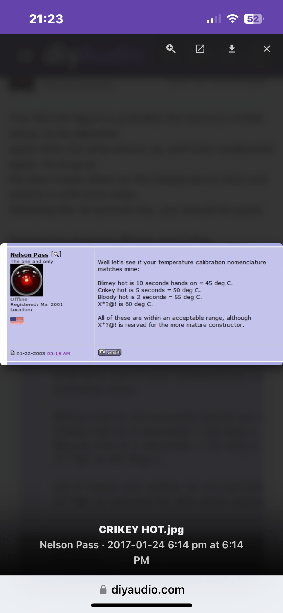

I agree entirely with what Mike has said. On a warm (or hot here in Aus) Summers day, the heatsink temp could easily go way above 50 deg C. Yeh, Jon Soderberg said 46 deg C was max heatsink temp at the factory on test, but he did not state at what ambient.
It would be interesting to know as to what is the ambient temp Nelson Pass works with when referring to his rule of thumb 50 deg C heat sink temp for max bias.
Here in Aus, a house without air conditioning could have a mean Winter temp of something like 15 degC and in Summer that could easily rise to +30 degC. So if one biased the amp in Winter to have a 50 deg C heat sink temp - that is a 35 deg C rise, and in summer with the same bias level the heat sinks would reach 65 deg C - ouch.
So, Mike's 25 deg C rise is about spot on.

Crikey hot I believe is reserved for the constructor that knows not to burn themselves on the amp. Also a constructor who has a power supply capable of handling the load...
Looking at the Zenductor and the suggested chassis for the F5m amplifiers, Mr. Pass is assuming we are smart enough to not get burned.
