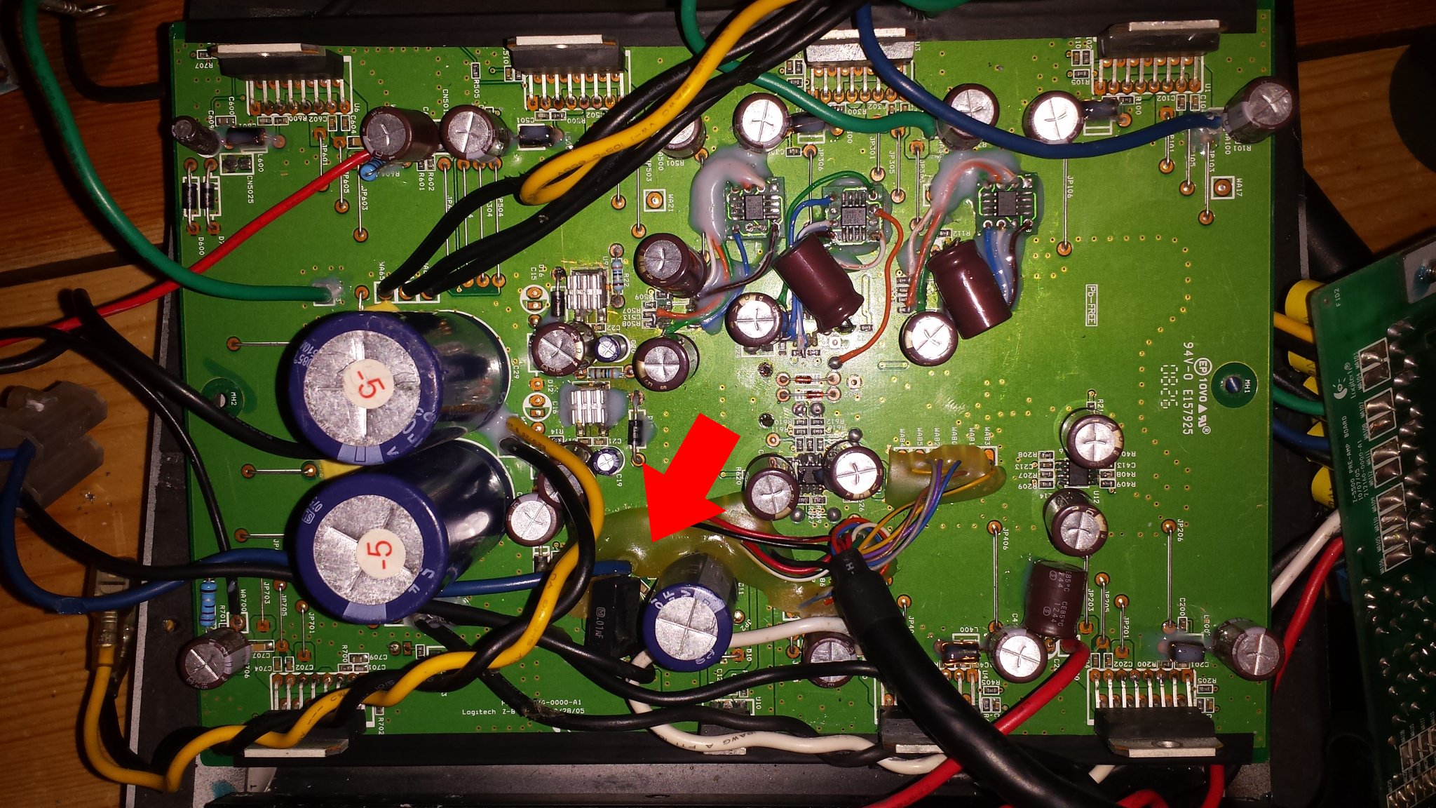

This sounds a little bit like the issue I had a couple years ago. It seems like the issue ended up being something to do with a bad rectifier, or was it a diode? Anyway, there was one fairly simple component that needed to be replaced to fix it. The problem is that is wasn't super easy to get to, and required a fair bit of disassembly to get to, but it was worth it to get my beloved 5500's back up and running. I'm still running these on my desktop. They have served me for over 12 years now, through 4 computers. Best PC sound I've ever had. Too bad there's nothing on the market to replace them if and when it finally does die.
EDIT: If you want to go back and see if it sounds like the problem you're having, my repair saga begins on page 34, post #661.

Well....dang. Here we go again. I just realized this morning that my rear right channel appears to be dead. I think it's probably something on the amp board itself, and I just don't think I have it in me to tear this thing apart again. It's a shame, since this has been, hands down, the best PC sound system I've had over the past 25yrs or so. I've moved it through at least 4 high end CAD/gaming workstations. I upgraded the front left/right speakers to ones I built with help from the kind folks on this forum. It's been a wild ride, but I'm afraid this might be the end. :(

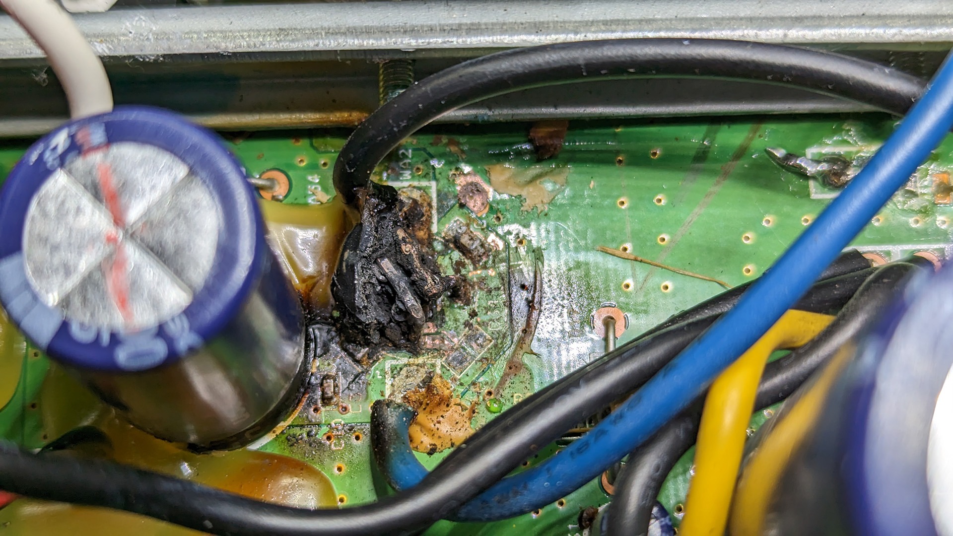

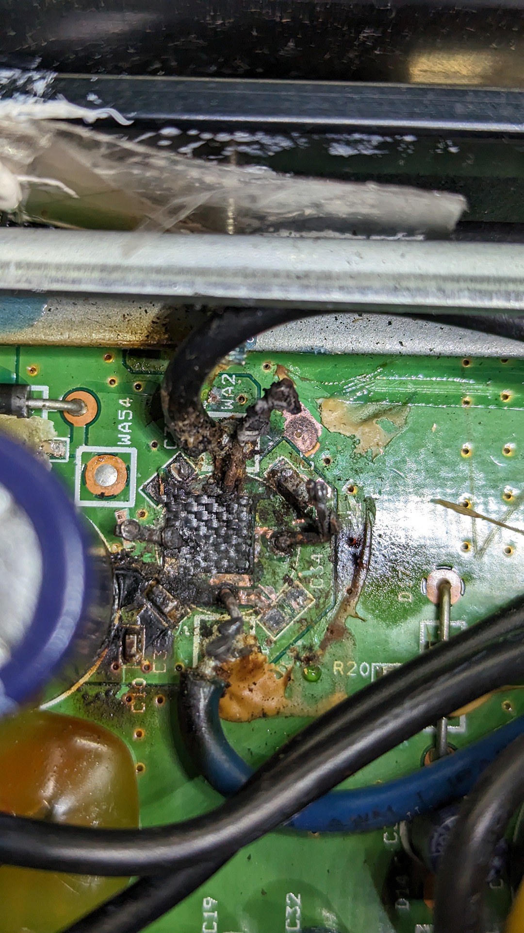

Hello everyone, I'm getting into soldering and PCB repair, so I'm still a newbie. I recently dug out my old Z-5500 that blew up a few years back. It has the same issue as above, but worse...
I spent a couple hours digging through several forums and was able to figure out some of the components that I need to replace. However, I'm struggling to narrow it down, and could use some assistance please!
D18 - Bridge Rectifier (2W02G-E4/51) https://www.mouser.com/ProductDetail/625-2W02G-E4
WA1 & WA2 - Film/Suppression Capacitor (unsure?) https://www.mouser.com/ProductDetail/539-158X104K
C34, C35, C36, C37 - Resistors appear to be 22k?

Are you still looking for answers? I have my z5500 open right know. Im not an expert buI can look. Can you tell me were the components you mention are located? if its on a pcb, can you tell me which pcb and in what corner? do your speakers connect with plugs or clamps?
* C34, C35, C36, C37 ==> c is normally a capacitor.
*D18 ==> My z5500 has the bridge rectifier off board and does not have a ref number like d18. if d18 is your main rectifier, you should choose a part with a higher amp rating

Yeah, I've kinda put this project on hold, because I'm not sure I'm able to fix it. At least not yet with my experience level. Looking at the pictures again i'm sure the PCB is probably fried/destroyed... I did order a few components from Mouser, i'm not sure they're the right components, and afraid to attempt the repair.

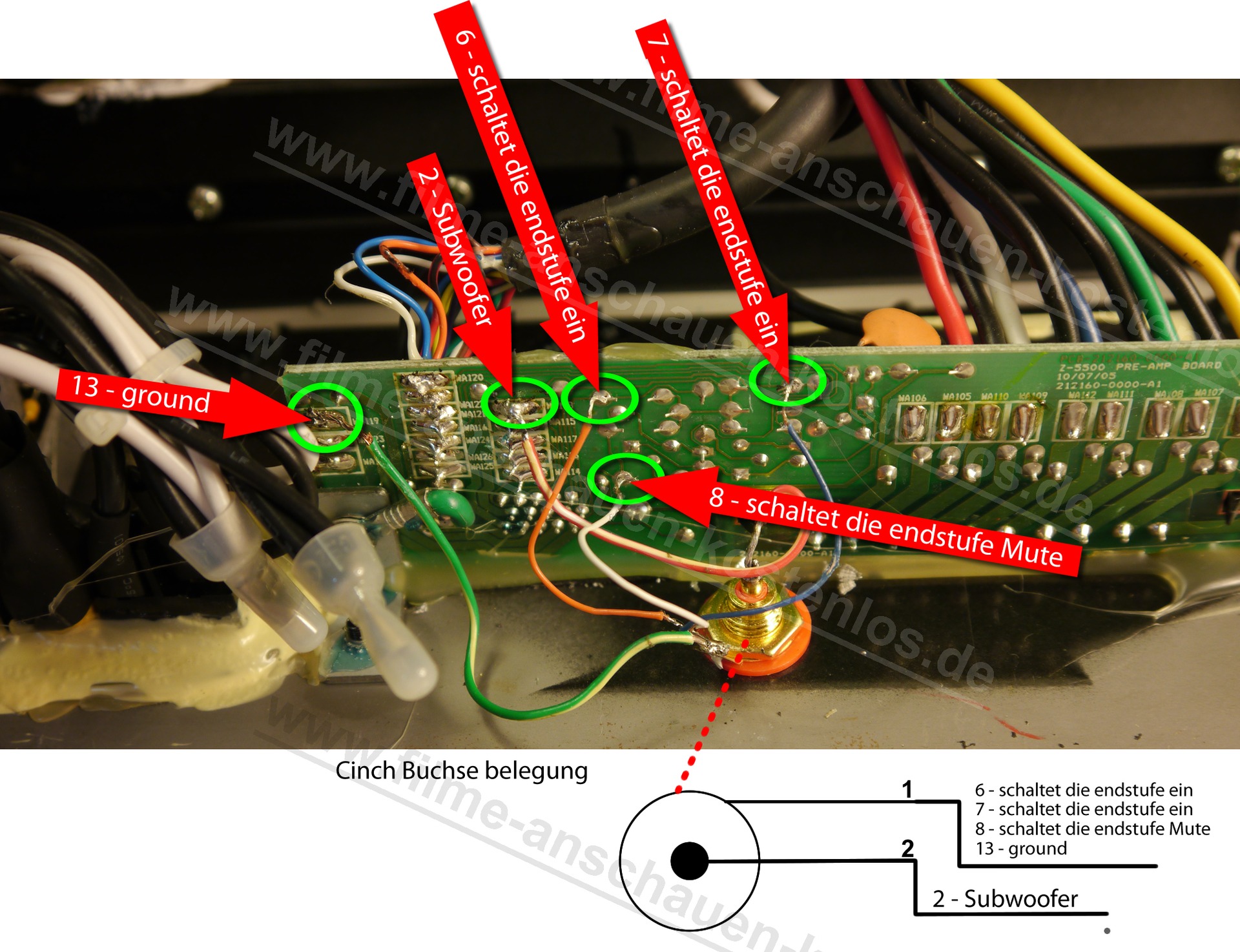

I have a new plan, it's not a repair, but I'm going to connect the Z-5500 speakers to a 5.1 receiver. I'm going to pick up a free receiver. The only mod I have to do is to rewire the subwoofer, nothing fancy, just connecting two wires to the actual speaker in the subwoofer, bypassing the original amplifiers. There 's one thing that can go wrong: I'm not sure if the receiver I'm getting has a subwoofer output.
Hey I have been following this thread trying to hack my Z-5500 to work as a standalone subwoofer with my receiver. I have the spring clip version and I have made the connections as seen in the attached image. 6,7,8, 13 and sleeve of RCA cable connected to GND. Center pin of RCA cable is connected to 2 SUB in. The subwoofer is working but the audio level is very low. I have tried to feed the subwoofer with audio signal from my receiver's sub out and I have tried to feed it with the audio output from my phone directly. In both cases the subwoofers audio output is very low. Have any of you experienced similar issues or know how I could manage to resolve it. Any specific components on the amplifier board that might cause the low audio output or something else. I hope someone with a little more knowledge than me could point me in the right direction.
