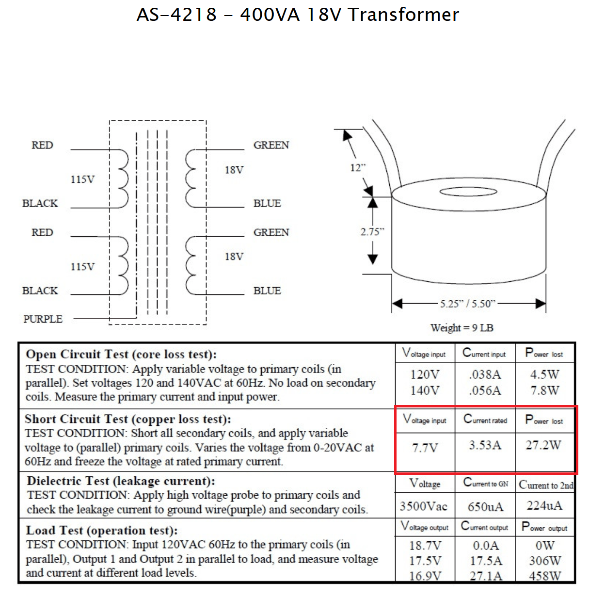

The inrush current can reach several hundred ampere, which
Not in a typical F5m with a typical F5m transformer. More like half-of-one-hundred amperes. It's easy arithmetic.
A typical transformer for the F5m might be "Antek AS-4218" which is 400VA and 2 x 18VAC secondaries. As its datasheet shows, the resistance of the copper wire in its primary windings is (7.7V / 3.53A) = 2.18 ohms. So the absolute maximum primary current it can possibly conduct is 120V / 2R18 = 55 amperes. The copper resistance doesn't change when you attach rectifiers and capacitors to the secondary, nor does the copper resistance change as the magnetic field builds within the transformer core.
However, if you move up to 600VA in the Antek transformer line, the AN-6450 has a primary copper resistance of (5.2V / 5.44A) = 0.96 ohms, so the absolute maximum primary current it can possibly conduct is 120V / 0R96 = 126 amperes. Assuming the mains fuse's resistance is zero milliohms, and the on/off switch's resistance is zero milliohms, and the chassis internal mains wiring including connectors is zero milliohms.
Thanks MJ, always useful to have additional math and science for corroboration.
I was also going by Tom C's measured data. In example, he stated that an AS-3222, measured 82.5A peak current and the AS-4225 measured 110A. And a 1kvA Plitron measured 200A peak.
