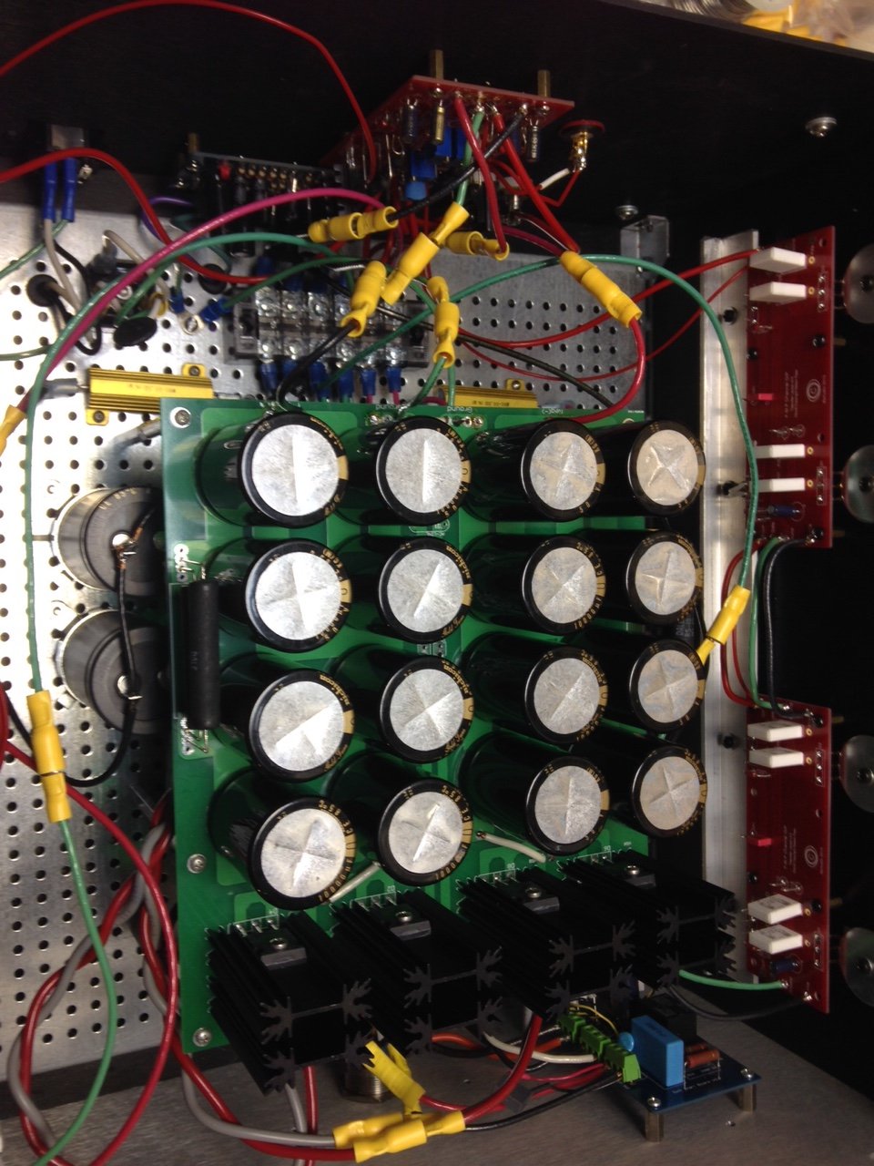

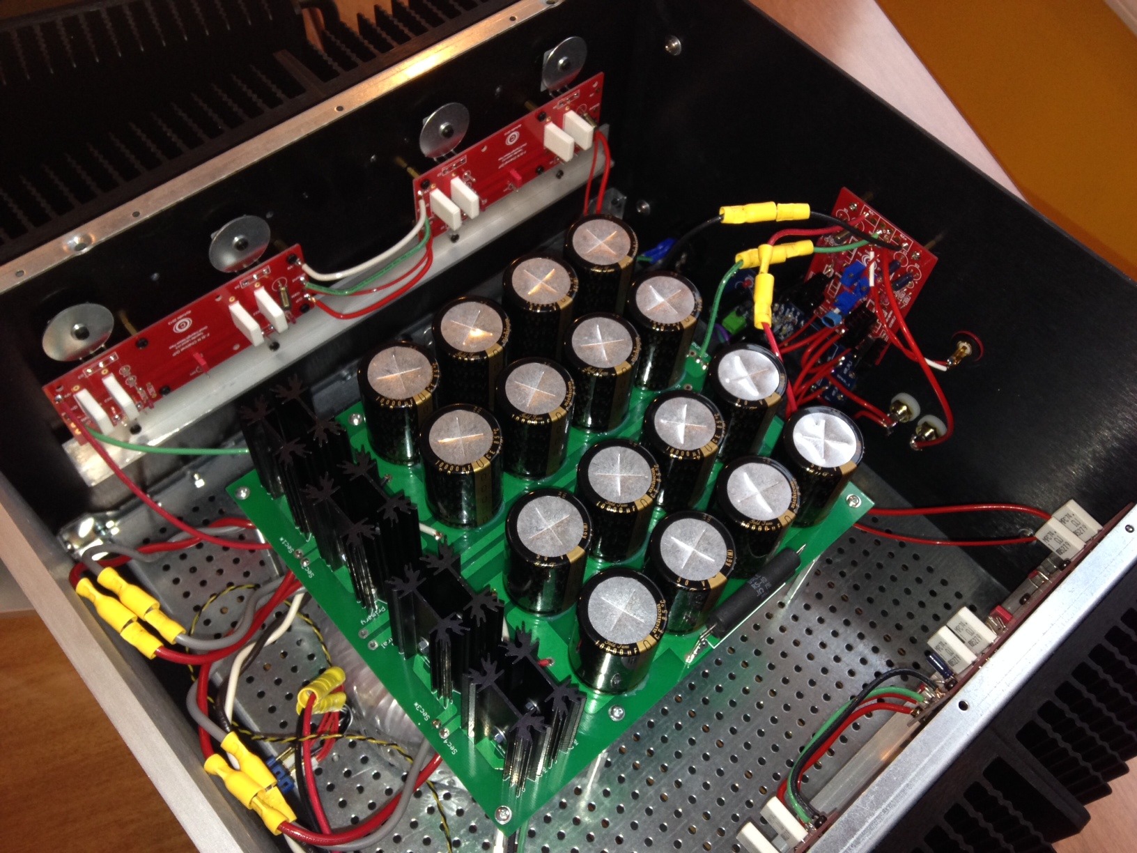

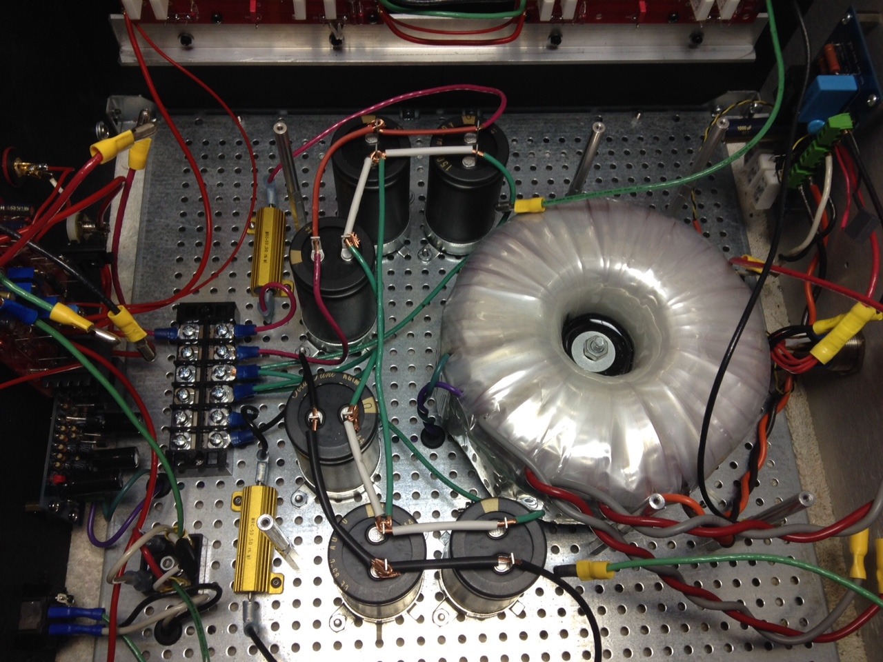

Here are a couple of photos showing the third power supply stage (i.e., an RC stage) with and without the CRC power supply board designed by and sourced from buzzforb, a (former?) diyAudio member who hosted an F5 Turbo components group buy about a decade ago. The capacitors are all Nichicon KG (15,000 uF on the baseplate and 10,000 uF on the ps pcb).
Scott
