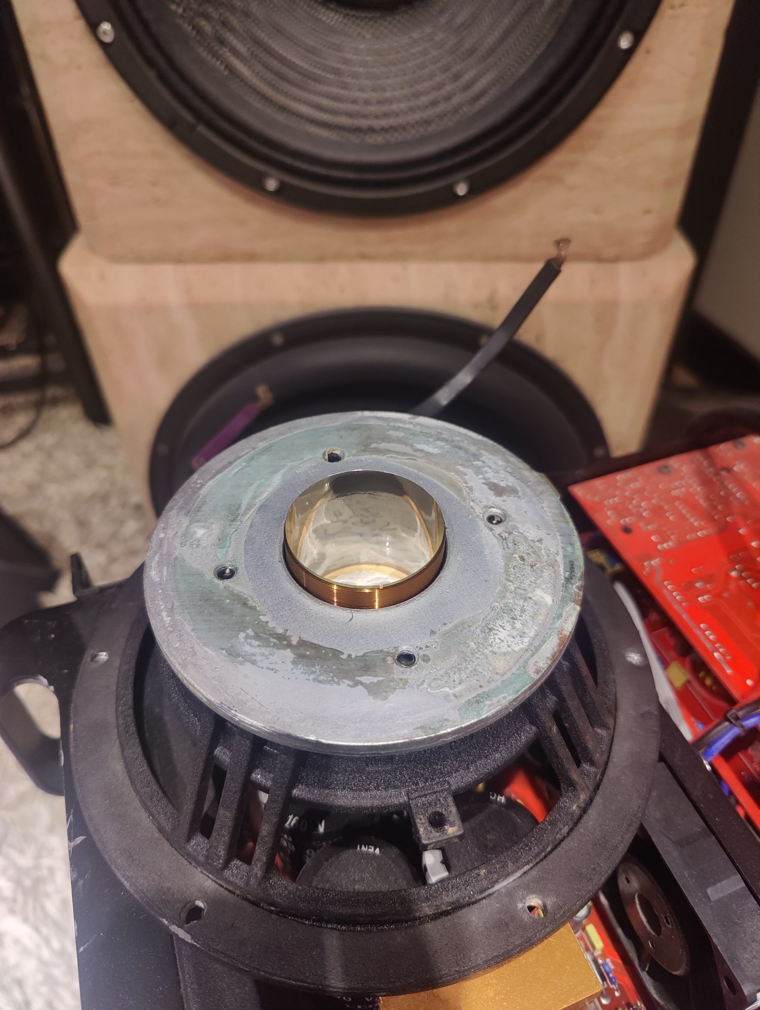

I had some Accuton C173-6-191 drivers with broken ceramics. from a few years ago at home, I have disassembled them and I plan to replace the ferrite with neodymium of the same height 20 mm and place a 6.5" carbon cone with a fairly large suspension. The coil is 38 mm titanium, the The truth is that disassembling everything was easier than I thought; all the pieces were disassembled without much effort.
Ahh, so you want to take the "home brew" made driver route, that's fine as long you have realistic expectations.
One thing to note is that changing the magnets will alter the parameters of the driver specially BL, do You have a way to measure the TS parameters once you finish your franken driver?
That will help to get a ballpark projection on what to expect freq wise from your planned setup.
