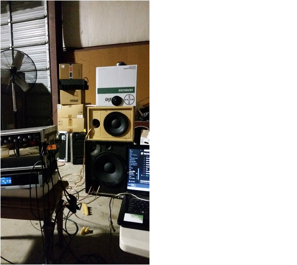

This is a serious dome.
I come from a prosound background so I'm used to high output compression drivers that would leave many direct radiating domes fried in a matter of seconds. For my latest project, a prosound based live instrument monitor, I was set on a compression driver mounted directly on the baffle for extra wide dispersion. When I saw the review of the T34 I knew I had give it a try.
I recently received a Faital Pro HF146R. A 1.4" exit driver with a 2.5" dome. This model was specifically designed to sound less harsh at high levels. Initial tests were positive with a LR24 highpass at 2khz. Still got that bright icepick sound at high volumes but not as bad as other drivers I've heard.
The T34 was substituted, level matched, and eq'd to the same level as the HF146R. The Faital is about 9db's more senitive with impedance taken into account. To my surprise the Bliesma is able to achieve a subjectively cleaner sound at levels that would have me reaching for the volume control with most compression drivers.
How loud are we talking? With my live bright tone bass guitar (Marcus Miller to Les Claypool) I was clipping a 4 ohm 10PR300 with one channel of a PLD4.5 (2000w peaks) bandpassed between 330-2khz. Hard to hear yourself yell.
The top octave is obviously cleaner and more extended than the HF146R. I haven't had the pleasure of a hearing a Beryllium domed compression driver. The T34 should hold up very well in any domestic setting with its massive output capabilities and clean performance.
Test area shown below. Yes...the setup is far from optimized but that's part of the fun! Building is 60x40x16 feet. An 18 Sound 10NDA610 is on the way to join the party. Should make for a potent 3-way box with a pair of BMS 15N850's.
