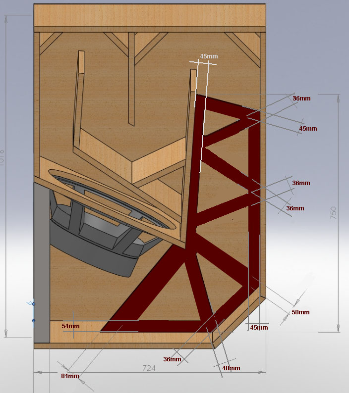

I have a question about this design, what happens if i scale it up?
In a regular horn it's possible, but TH's are usually just being wider.
I have a birch ply box measuring 70cm/28" X 90cm/36" X 60cm/24"
The ss15 has scalable size 60cm/24" X 75cm/30" and driver 15"
Scaling up everything makes:
60x70/60=70 cm
75x70/60=87,5 cm
15"x70/60= 17,5"
Very close to the box i have with an 18" driver
This would be easy.
Perhaps I'm better of modelling it all over in hornresp?

Xoc1's TH-18 is 70.2 x 101.6 x 57.15.I have a birch ply box measuring 70cm/28" X 90cm/36" X 60cm/24"
Relatively minor changes would be required to fit that design into your box, and it is already designed for an 18".
hm, that might be a good idea! But the system volume is a bit bigger in th-18 Actually i thought it was possible just to change between speaker sizes only by changing the with, like "tda-audio" have done with his 12" subs.

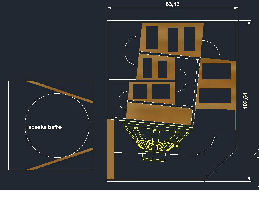

Scaling up the SS15 takes a bit of patience.Loos like we have to sim it for ourselves. If i can get the right hornresp sim-screen for ss15 it should be quite easy to scale up all measurements including driver to get a sim for a 18" 60x70x90 version.
But I'm a bit confused about this tapped horn simulation, can anyone point me to the right input screen for jbell ss15?
The SS15 and the TH18 have the same internal width 533 / 535 mm, no problem there! It could be wider depending on construction and timber cutting reqirements.
The 18 version would probably require 18mm Ply.
There are scaling issues as the SS15 is carefully 'compromised' to allow it to be cut from one 8' x 4' sheet, and you don't need to with the bigger cabinet.
I had some time on my hands and came up with this version.
Note the S2 dimension does not completely follow the model, Its an idea I am working on at the moment. The dip in the sim at 100Hz will probably be smaller due to inductance and the smaller throat size. Width is 533 internal at the moment.
The dimensions could be varied a bit to suit. but are all related to each other in differing ways...
Current Driver is the B&C TBX100. What driver do you have?
Regards Xoc1
