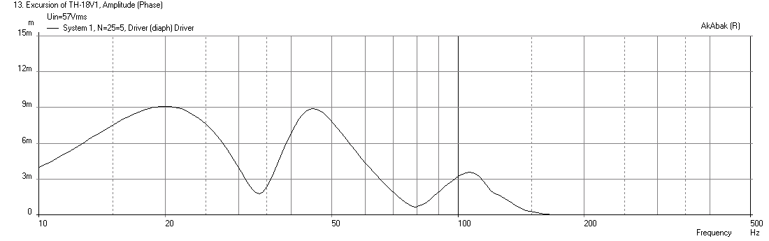

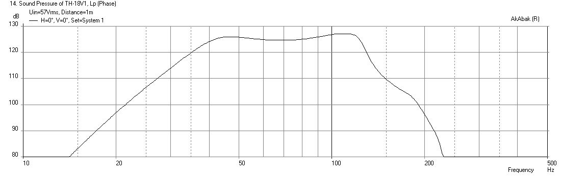

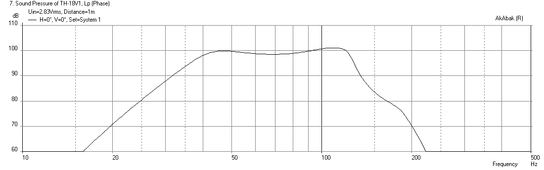

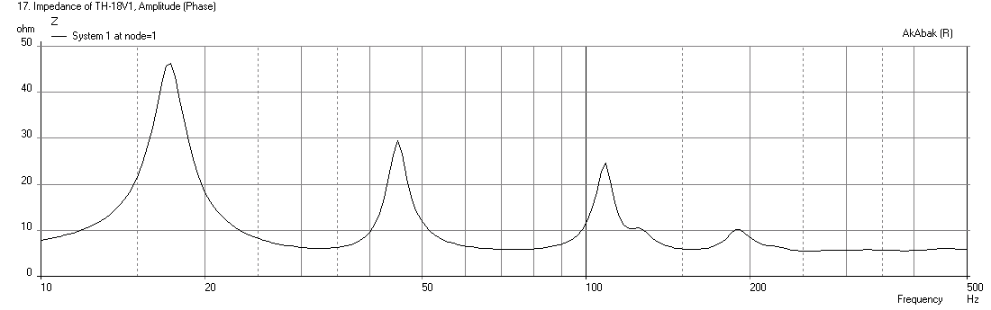

Using TundraLTD's Akabak model, the Beyma G550 looks pretty good in a sim with a 30Hz -12dB/oct high pass filter and 120Hz -48dB/oct low pass filter applied.
Here is the SPL vs freq at 2.83V for reference
Here is the SPL at xmax which requires 57 volts or 406 watts rms
Here is the cone excursion at 57 volts
Here is the impedance
Looks like a good performer with good efficiency.

Is the ~126dB output at 100Hz far off what the quoted drivers achieve? As the beyma is rated to 900w (I think) with close to 9mm xMax), 406 watts is a little conservative...?
I'm not sure how distorted the sound will get in this setup running the driver closer to it's xMech.
More compression inside the horn to limit excursion, or will peak output be vastly greater than the sim?

126 dB at 406 watts is close to the efficiency that the Beymas are capable of - that is why I show the response at 1 watt, it is about 98 dB. You cannot put more power into it as the TH design doesn't control excursion enough - this is common for TH's. 126 dB is no slouch though and will get cops called to your party in a blink if they were used at home. You could high pass at a higher cutoff and limit bass to say 55 to 60 Hz and that will boost max SPL. You could play with tweaking the channel gaps to change compression ratio but that will go off plan and the nice box design provided in this thread will no longer be valid. I will leave tweaking the design up to the OP.
The 406 watts is a theoretical figure it does not include any power compression losses. The Beyma spec sheet for the G550 has a graph for power compression.
http://profesional.beyma.com/pdf/18G550E.pdf
At 406W the power compression is already 2.2dB
At 900W the power compression is 4dB. A 4dB reduction from 900W calculates to a theoretical 358W.
This indicates that the driver will actually require 900W plus to reach X-max.
