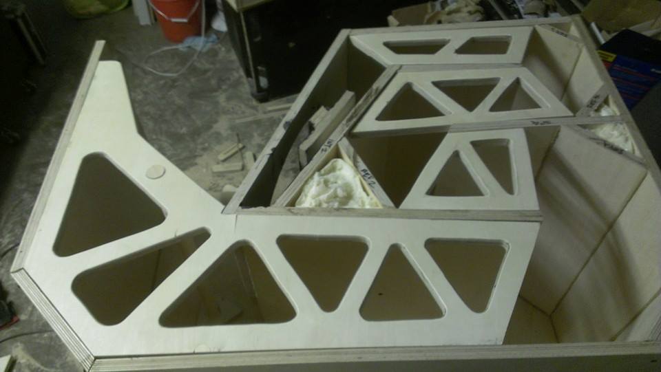

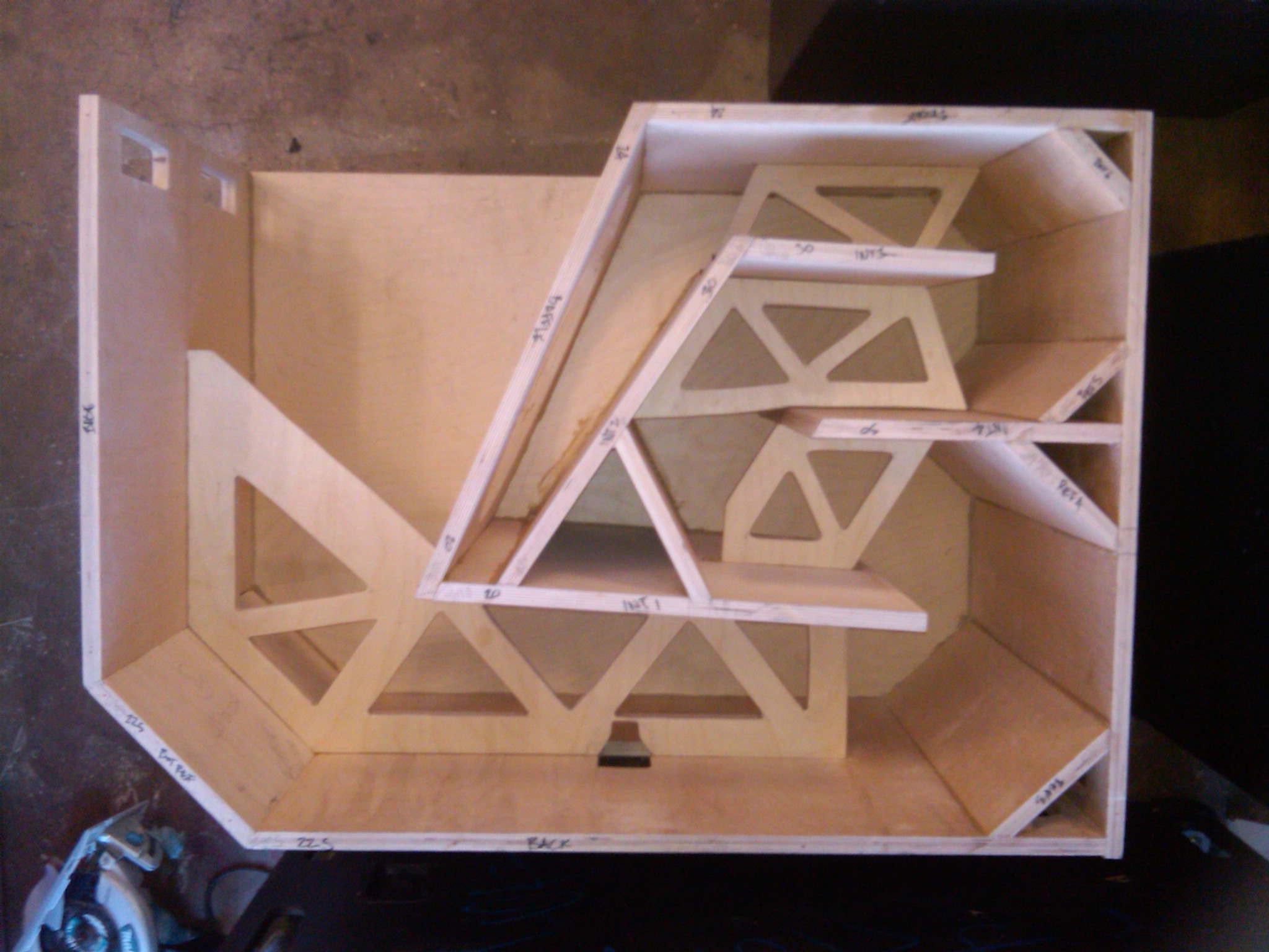

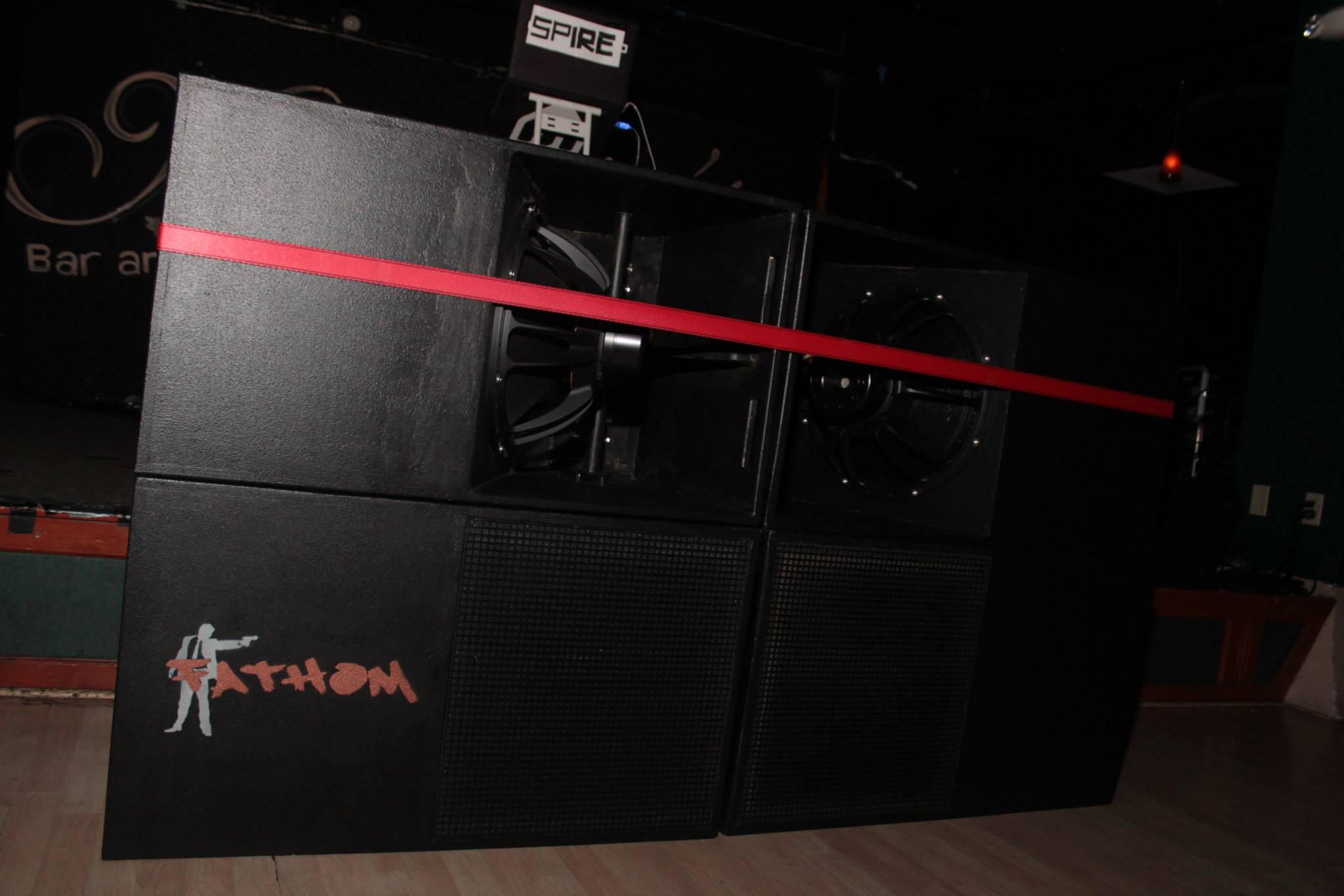

I went with Xoc1's suggested bracing idea (in addition to the broomstick brace) and might end up doubling up those braces down the centerline, evenly spaced (with 1/2" baltic instead) for future builds. Running 2 pair of 18SW100-loaded TH18s off 2 bridged PLX3402s creates a bit of vibration (and awesomeness), even when ratchet-strapped in a group of 4 around their circumference (unlike pictured below) while vibrating glasses/bottles off of shelves/counters in ~400 capacity bars/clubs.
(1st attachment shows first round of cabs. 2nd attachment shows second round of cabs w/bracing at edge, purely for photo capture)

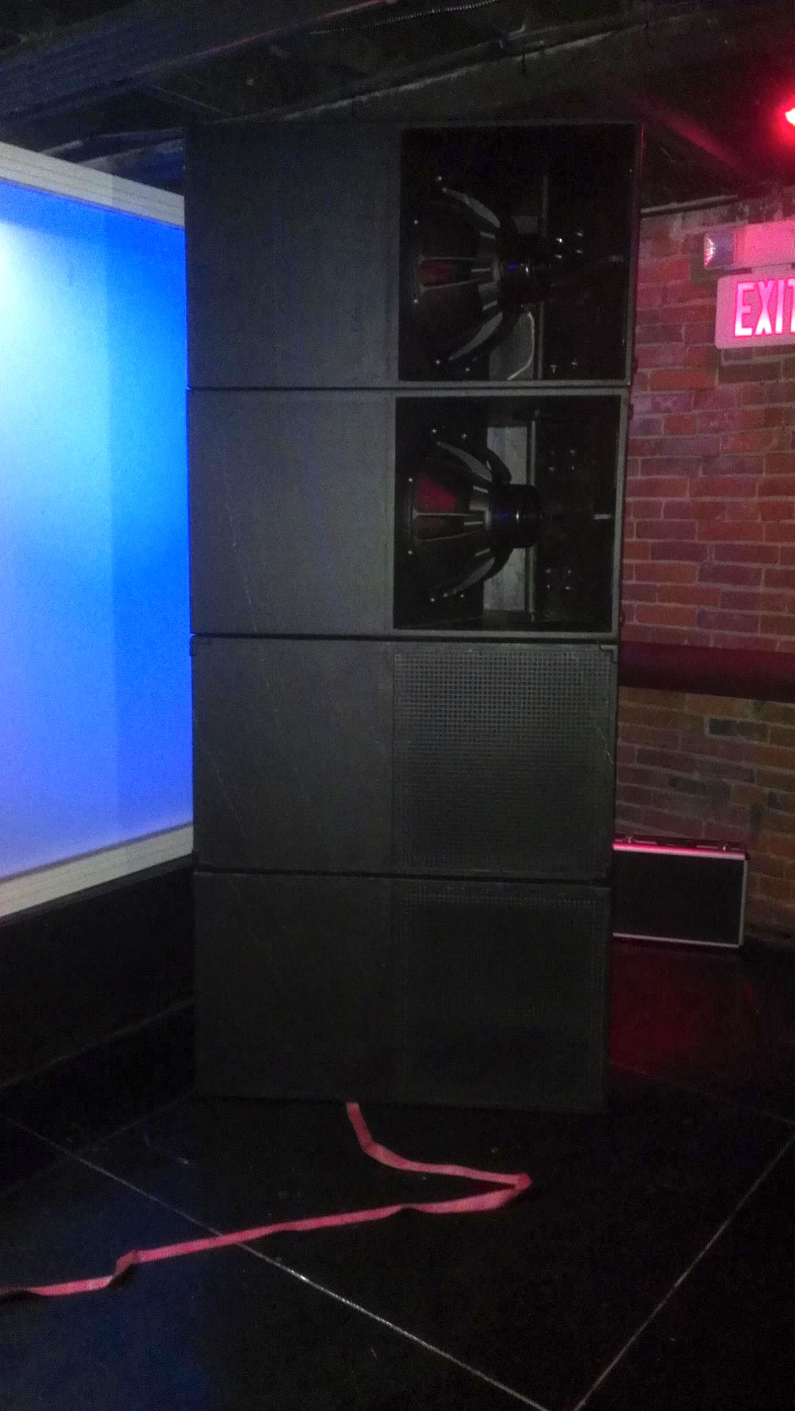

How do you like them stacked up verse side by side? This is how I usually run my Danley's View attachment 379481
How many amps are you using to power those 4 cabinets? Because one different driver probably wouldn't respond exactly the same as the other three.....
Also what ferrite driver is that? I thought the TH-118 was only ever offered with the b&c 18sw115 or the 18 sound 9600.... Which are both neo drivers.
I'm using Crown xti2000 on each of the 3 TH115's and a Crown xti 4002 on the TH118 bridged. I'm running the Crown xti 2000's with the sub synth in and the xti 4002 without the combo is amazing in fact Ivan Beaver had recommended the combo of the TH115 and Th118 he also said that when doing demos most all the people like the sound of the combo better.
Thanks man. The real differences are bracing, corner reflectors and different throat shape. So the Danley TH-118 is similar to mine but not the same. Yet response isn't drastically different.
TD's indicated that corner reflectors aren't really needed for bass horns, and can actually adversely affect the performance. I'm in the process of building a similar TH (around a 12" driver) without corner reflectors, and one of the things I'll be looking for is any significant difference between the sim'd and actual response curves.
I think that correctly-placed bracing should result in an appreciable and measurable performance difference, hence my question above about which panels are most prone to vibration. The same pieces of wood used for corner reflectors can be used to add bracing to the panels that mostly need it.
