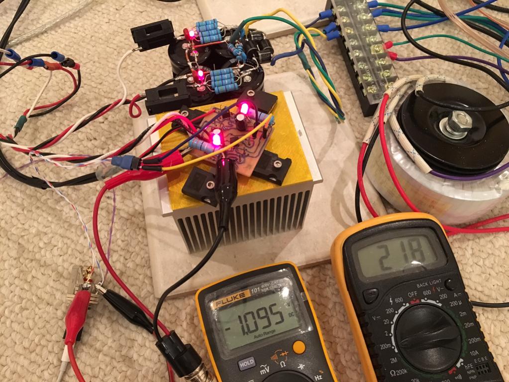

I also have a new head amp I just got working: a zero feedback MOSFET class A source follower that uses a LU1014D power JFET and IRFP240. Sounds fantastic but is a real house heater with 13 watts of thermal out for 330mA bias current.
http://www.diyaudio.com/forums/head...lower-headphone-amplifier-14.html#post4906102
It is a superb amp - absolutely noiseless, no hiss, no hum, nothing audible when music is not playing. Very direct and deep deep bass when using low impedance headphones.

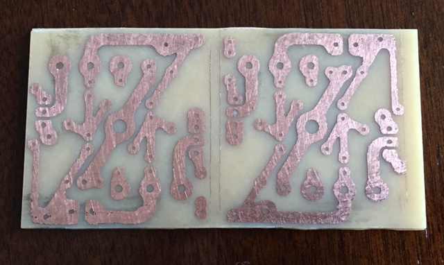

Real PCB should be on the way:

New head amp looks good and heater effect is useful into wintertime 🙂, when time comes have fun building VSSA kits.

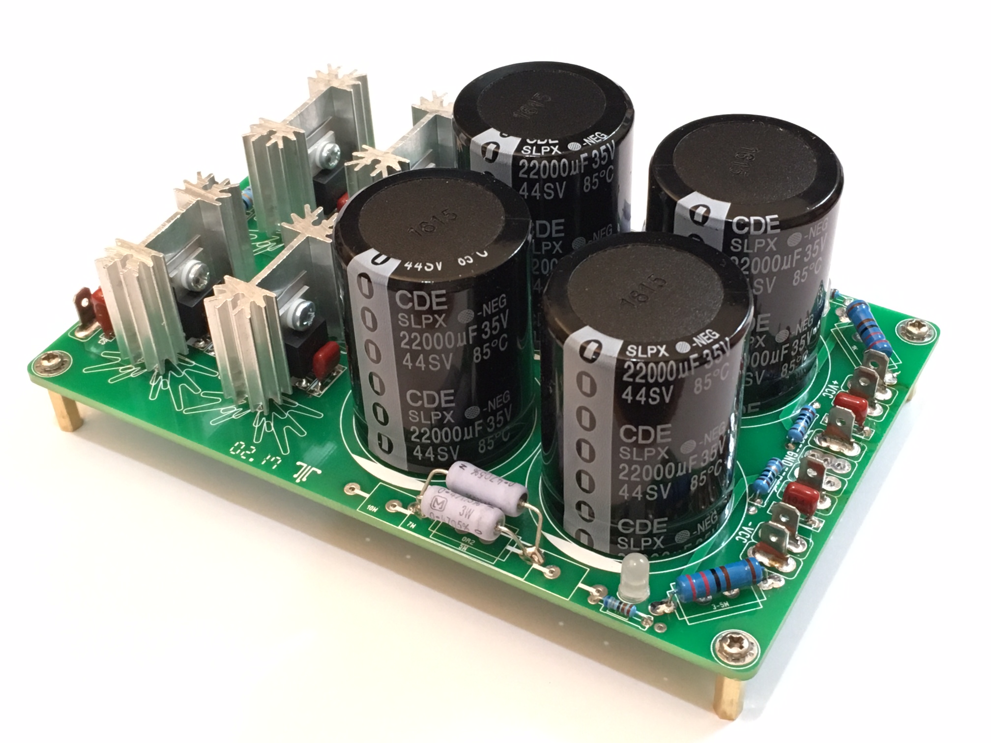

The PSU for the M2 is a whole topic in itself. I was using a 400VA 18VAC toroidal transformer from Antek with dual 4x33mF CRC's. But I had some noise issues. They are somewhat resolved, but still can't beat dual 24v 5A SMPS bricks in series for clean power. It may be that my transformer is saturated with local line voltage at 120vac. It's still on 400VA Antek but with improved grounding scheme and I am using the Project16/Prasi Class CRC PSU now. I am also using proper ground loop breaker and star grounding topology.
http://www.diyaudio.com/forums/power-supplies/306411-strange-forest-noise-linear-psu.html
Current PSU is:
http://www.diyaudio.com/forums/group-buys/301682-crc-power-supply-class-amplifier.html
Current PSU is:
