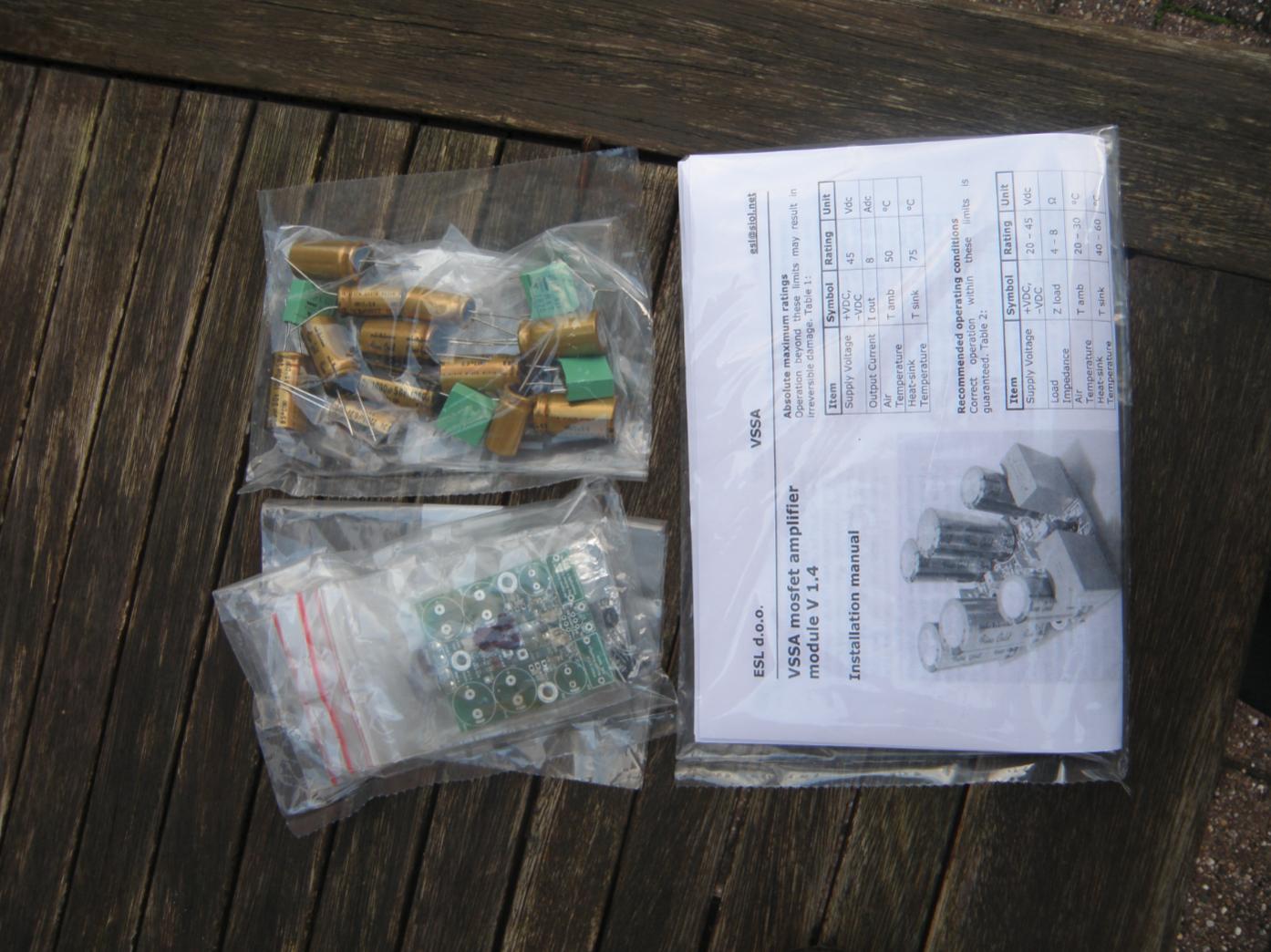

Had a couple of VSSA kits as seen below that was handed over to X so his amp build into 2016 and shared sound clips will probably soon grow by one more (Was so happy meet xrk971 and member wesayso in person couple of days ago when X was at a business trip to Netherlands http://www.diyaudio.com/forums/full...er-full-range-line-array-275.html#post4904679).

All this started just last March and has been a blast learning from all of the experts here. A big thanks to Prasi, Sonal Kunal, Idefixes, Dacz, Kees52, and Jkeutermann for providing me with such great Gerbers that made this possible. Also, a huge thanks to the great designers of the circuits that I built with Apex Audio and Nelson Pass as probably the leading sources of inspiration that got me to start building amps.
Not shown below are CFH9 (currently in the hot seat), VHEX+ (in a case), F5HA with IRF610/9610 (in case), and ACA deadbug (at office). My journey was (as best as I can remember) as follows: Dx, ACA P2P, Inv JFET Circlophone BJT OPS, DOS TDA7297 w shunt reg, FX8 50mm - Sonal layout, FX8 Bimo - Prasi layout, VHEX+, FH9, FH9HV, VSSA JK thru-hole, Inv JFET Circlophone MOSFET OPS, Ranchu/Aksa Quasi - Prasi layout, Apex AX11 - Prasi layout, M2 - Teabag layout, Kees52 allFET Circlotron, CFH7 - Idefixes layout, Ranchu/Aksa Quasi - Dacz layout, Juma F5 2SK2013/2SJ313 - P2P, F5HA - P2P, CFH9 - Idefixes layout, F5HA - Prasi layout, F5HA 2SK2013/2SJ313 w Juma shunt reg - Prasi layout.
