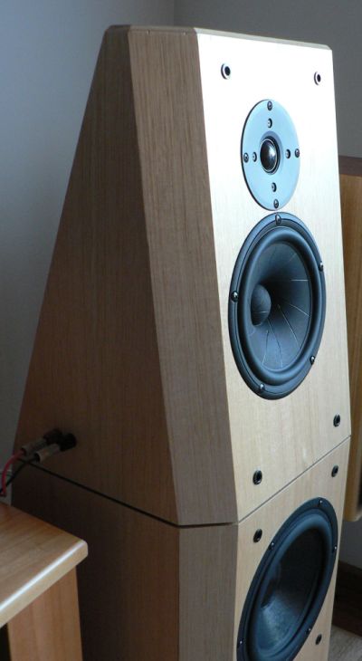

The main offending speaker that I use with the AKSA is one using 810921 + 18W8531G00 + M22WR-09-08.

Rabbitz - nice looking speaker, is this something you have posted details about somewhere else on the forum ?
Thanks. No details on the forum, just a few pics. Design details were on my website but that's now closed.
Started as an OB for the 18W8531G00 (hence the odd shape) but now is a sealed enclosure. Had a Scan Speak tweeter originally but changed to the 810921. It's a 2.5 way electrically with an AR series crossover and the bottom woofer is vented.
