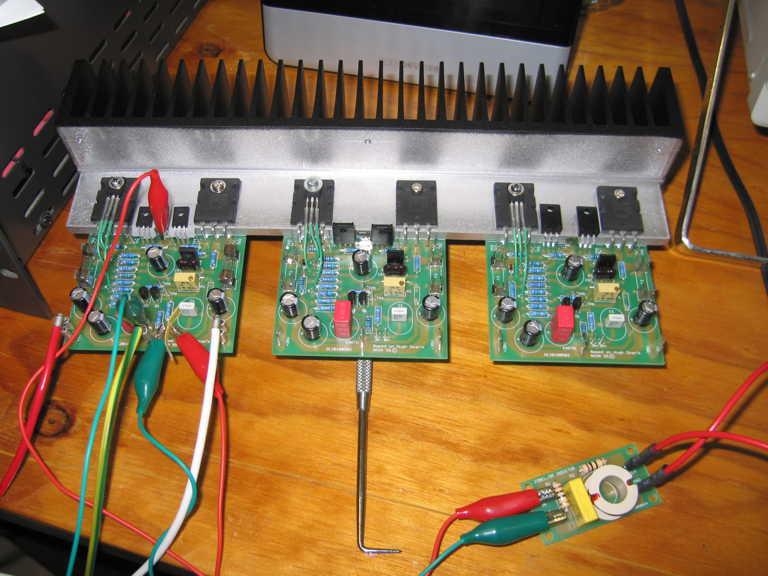

Here is picture of my test amps
I really like this basic design and believe it is a good starting point for anyone wanting to get into DIY audio. I intent to publish enough information for anyone with a little DIY experience to build these amplifiers.

Some say, keeping things simple is a bless, tell me Greg, how does it sound? I am dying to know. Are you going to tweak the values to obtain the best performance?
I like this Zobel module, very attractive indeed. Output terminal is in the perfect location, placement of Q4 is also perfect to me. The row of resistors gives it a nice touch. Well done Greg.

To early to comment on the sound, it is only working on my work bench. I plan to test various tweaks to experience them for myself. So far, the amp on the left has BD139/BD140 for drivers and a BD139 for the VAS while the other 2 have the recommended drivers and a KSC3503 for the VAS.

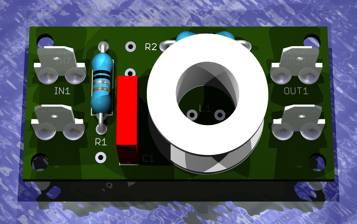

I got sick of trying to squeeze the zobel and output inductor on the amp PCBs. This way I can built a half dozen of them suitable for testing the amps. This amp PCB has room for the zobel, but I am not using it. Thanks for the compliment.
I plan to build 2 mono blocks with 3 amps per heat sink. This way I can quickly compare 3 options in quick succession. I might automate the switching between them one day.
