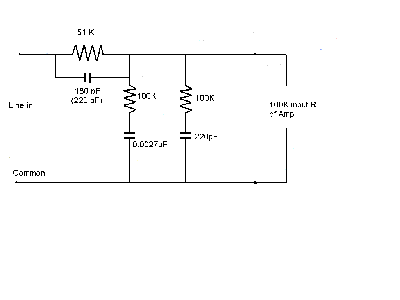

Hi all. Joe has had a few issues with his B200s. None of the published solutions worked for him. He has given the attached line level passive network a try, and he has left the ribbons off.
No attempt has been made to correct the bass roll-off on his OBs, the bass helper does that. This circuit could be used on other baffle arrangements.

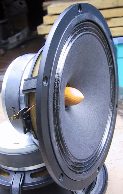

BTW, Dave I picked up a used pair of 167's that have your phase plugs. Will those fit a B200, since it has the same VC diameter?
I like my phase plugs from Dave for the B200. The sure help the beaming. The rising response can be help with toeing in or out, a notch filter, or hopefully the new toy John is showing.

Geoff, can you please post again the PLL circuit, a bit bigger? I have troubles reading the component values.

Dave's phase plugs are a very good idea, but I am still a bit reluctant to cut through the speakers.
Somewhere I read that treating the dustcap with dammar could improve things... Maybe I'll try that. If it doesn't work, I'll cut it altogether and install plugs...

Hi Vix, see what you mean. from left to right, 150pF (or 220pF sot)
0.0027uF, 220 pF. 2 x 100K res. from memory. I'll post another pic when I'm back home. Also an explanation of values.

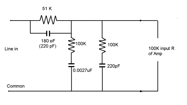

Pay no attention to my feebal attempt @ a thrown together schematic, when posted, it all went every which way,,it is NOT correct..just use what Geoff post's if you try it....damn!!!!!!!!!!
This diagram should be better. Silly me. Rule 768, don't post pics without previewing them.
The circuit is designed to run into a 100K load, and should be fed from a low z source. There is nothing special or magic about it.
The 51K in conjunction with the two 100K sets the attenuation at higher fs. Going up in freq, the 0.0027uF sets the first knee at 600Hz, where the output of the B200 starts to rise. The 220pF sets another knee at 7Khz, where there is a peak. The 180pf levels the response at 16Khz. The design value was 194. Going to 220pF will brighten the top end a little. Also, this cap will correct, to a degree, the phase shift at high freqs.
