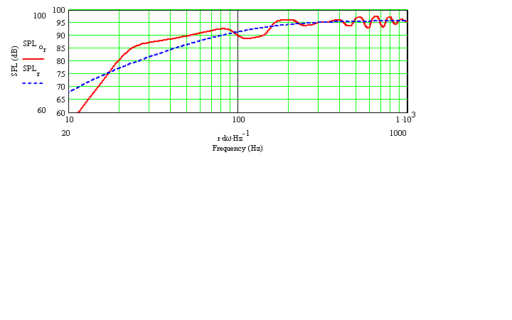

That calculator is useless. It is based on obselete classical TL methodology.
1st off Sd has nothing to do with a TL (unfortunately Martin chose it as a variable unit of area which confuses things). The parameter that is important -- just like in every other kind of box -- is the Vas.And as soon as you taper the line it has to get shorter.

MJL21193 said:ou are refering to the MHSOFT link in post#1? Not Martin King's mathcad models?
Yes. Martin's models (seconded by Augspurger's) have clearly shown the pitfalls associated with using classical TL design methodology (as in the link in the 1st post). If you look at the most successful classic TLs, it is clear they trial & erred themselves to designs somewhat similar to what we would generate today using MJK. There are also a lot of less successful examples of TLs that are really little more than overly complex aperiodic boxes (not to diss aperiodic boxes which can be VERY good)

You can get fairly acceptable results out of a 100in line, 3:1 taper, So=3Sd, Sl=1Sd, centre-point between the drivers 10.5in down from the internal top. Graph attached. It doesn't look pretty, but this is a 1/2 space graph. The LF roll-off should actually match room-gain quite well well & end up being fairly flat to the mid 20Hz regions. XO to your main units at ~80Hz or so and you should be in business (I wouldn't try crossing over higher up -over 80Hz, sound becomes increasingly directional, so you'd need two subs to preserve stereo imaging).

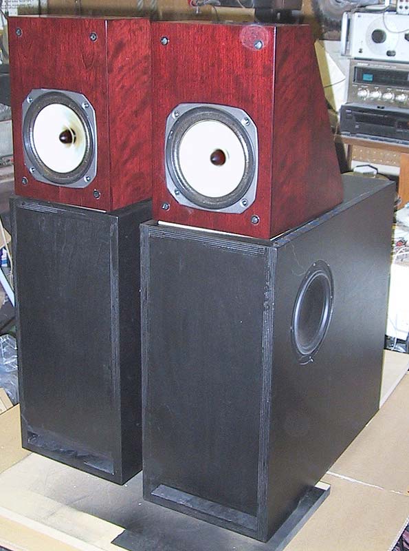

The arrangment (in a over the top implementation) is like this.

Each has 2 Adire Extremis 6,8. Actively XOed at 106 hz to the sealed FE167. Woofers driven with Bryston 4B, sats with a Red Light District. Sealed FE167 centre & 3 FE127 diyRef monopoles built into the walls & ceiling for surround. Centre + surrounds use another 4 channels of RLD. All Fostex are modified. FE167 phase plugs match the veneer & the bases on the RLD.
XO is not yet published but is a gyrator based tube XO.

MJL21193 said:ow does MDF degrade the box performance? Acoustically? Mechanically? Aesthetically?
Acoustically, because it is not as stiff as plywood, has higher energy storage, and panel resonances have lower Q so -- coupled with lower panel resonance frequency -- are more likely to be excited. The biggest thing in a sub would be energy storage issues. It also won't be as mechanically strong. 12mm ply will outperform 19mm MDF. For a sub 15 mm is probably the most practical.
On top of that push-push with its active newtonian motion cancellation will transfer far less energy to the box (which is why you could make it with 12 or 15mm ply.
