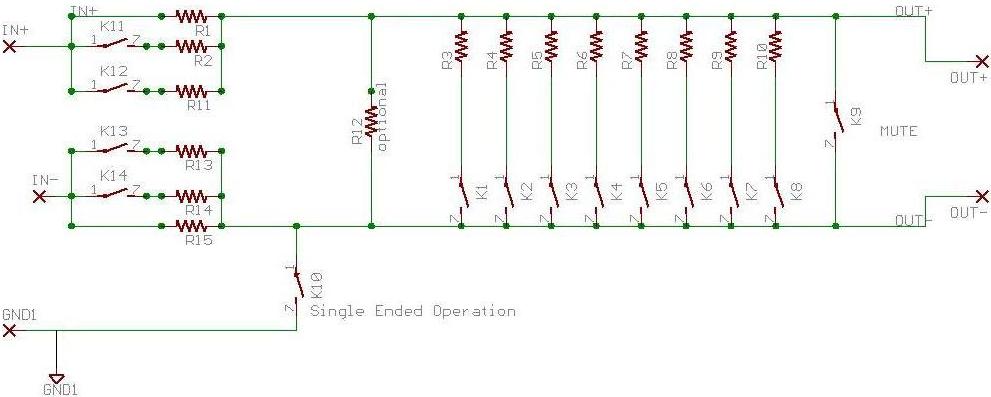

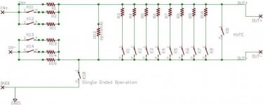

H Type Balanced Attenuator.
I am currently constructing and Aleph P1.7 preamplifier, and I have been investigating the most appropriate type of volume / attenuator control for balanced operation.
In discussion with a friend, he suggested that the most appropriate system is the H attenuator, as shown in the attached sketch.
Looking at it, I can understand that the additional resistor on the wiper of the pot will result in a linear pot behaving as a logarithmic type.
However I do not understand what the 330R resistors are for. To my way of thinking, I suspect that it is to keep the 2 sides balanced, regardless of attenuator position.
I would appreciate any comments regarding this arrangement.
Thanking you in advance.
George.

330 Ohm resistors are there to prevent shortcircuiting the outputs of the preamp and they can be bigger (1K - 2K2) in order to avoid overloading the preamp.
The other pair of 330R that connects to the input of the amp is not needed, there are always resistors in the input sections of amplifiers.
you need the two resistors connected to the preamp to make the attenuator work.
Together with the pot they form a voltage devider, without them the output voltage would stay more or less the same (when the preamp has a low output impedance) until you short it.
The two output resistors are not really needed and do raise the output impedance of the preamp.
I´m using something like this on my X-BOSOZ with two 1k2 resistors and a 24 step switch. Works very nice.
I tried it with a pot and here the difficulty is that for the lower volume settings the resistors are like 1 to 10 ohms and most pots don´t have the neccessary precision (left/right tracking). I tried a quite expensive laser trimmed one but couldn´t get it working on low volume settings.
Here´s a table with the values for the shunt resistor with 1k2 output resistors:
First Rshunt, then attenuation in dB, then output impedance:

as you can see the lower values are not that far apart.
William

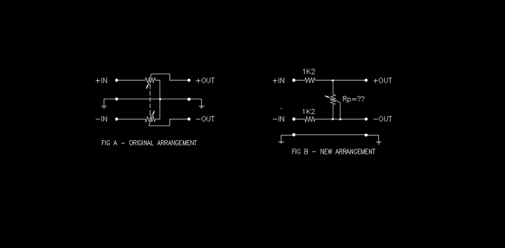

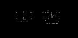

Hi again all.
The very first sketch that I posted here, was based on my understanding from a friend as to how a H type balanced attenuator / volume control should be configured.
Since this original post, the various contributors to this thread have improved my understanding. (well at least I think so!!)
I have attached another schematic, which shows two variations.
Fig A depicts my original thoughts as to how a balanced volume control should function. You will note that each signal rail, i.e. the + and – lines have a pot / attenuator configured in a manner that one would adopt for a typical unbalanced set up.
To my way of thinking, I simply mirrored the requirements for the – line. The pot / attenuator was to be a dual ganged type.
Now, as a result of the posts from this thread, I have come up with the arrangement as shown in Fig.B.
Am I on the right track, as I have omitted the shunt resistor, and the two resistors on the output side?
Just as side note, this volume control is to be used for an Aleph P.1.7 preamp, coupled to an Aleph 1.2 power amp, both of which are currently under construction.
Assistance will be greatly appreciated.
PS: Sorry about the picture quality, my DWG / PDF exchange has decided not to work. Had to convert using less desirable means.
Hope is readable. If not I will repost.

yes this will work but probably not with a pot. I tried various Alps and some laser trimmed super balanced pot but in everyone the channel balance was not good and it started at a quite high level.
This is because they are use the other way round. Normaly at 1 or 2 Ohms the attanuation is minimal and in this case it´s the maximum attenuation.
I think a stepped attenuator (or relais) is the way to go.
William
P.S. it is also not possible to use a stepped relais attenuator with 6 relais for 1,2,4,8,16,32 dB attenuation.

If you look at what I proposed as option B in the second pic that I posted, I have put the pot (or series attenuator or whatever other type of resistive control) across the inverting and non inverting lines, with the wiper tied to the inverting line.
The sake of discussion, the 2 resistors on the input or LHS can be ignored.
This was based on my understanding from a friend, who advised that this was the standard way in pro audio / broadcast circles.
However, after 3 nights of reasearching, I must be wrong.
The most common approach that I seem to be finding is simillar to my "option A", with and without a tie to ground or a single resistor that can be swiched to different values in series with each of the legs.
Now this is where it gets even more interesting.
Lets say that I switched in a 2k resistor in each of the legs (in series), unless these resistors were EXACT, would'nt there be a difference in signal amplitude across the inverting and non inverting line?
