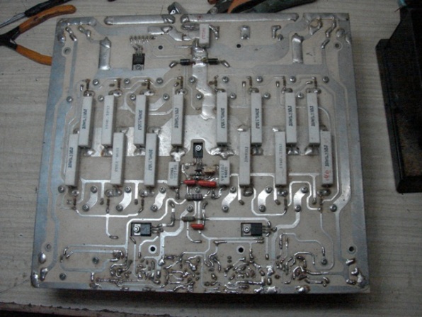

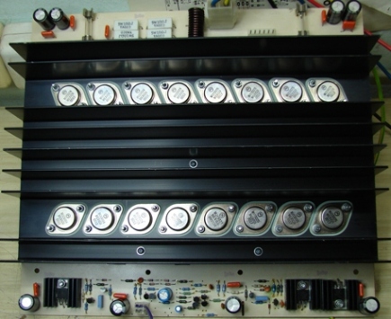

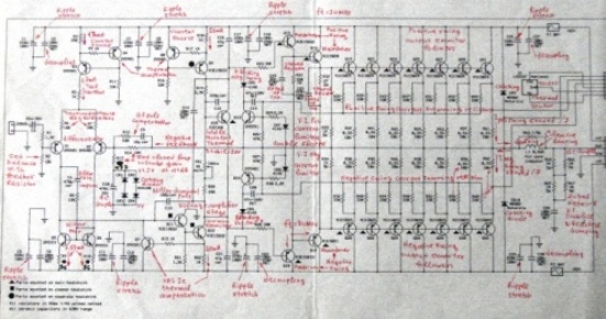

Because the big size of the schematic, yet i have not achived to convert this in jpeg to upload. I enclose a photo of this power amplifier module, a photo of the plan, and finally a zip fille with the drawing. May pointed out, that this module has presented already in my previous thread "wow!a beautifull preamplifier module" but for a different reason. Anyhow in this, you can see some oscillograms of his performance.

It seems to be interesting...very interesting.... as you already know, the schematic is unreadable, even using digital processing.
Having in PDF, standard adobe files, please, upload it to me:

fotios if you can save as PNG or GIF that will be much better readable than JPG which corrupts line drawings.
Just a thought - are the fuses visible in the photo for the output stage or just the input, VAS and driver stage?
The PDF document.
Dirty Harry PDFSorry for the confusion, but because I have made this drawing before 5 years, I forgot certain important changes. These are:
R3 = 220R and no 390R consequently tail current from 1,7mA becomes 3,18mA
R4, R17, R15 = 2K2 and no 1K
R11, R16 = 22K and no 33K
R9, R10 = 33R and no 56R consequently each emitter of current mirror has 0,87mA
PR1 = 500R and no 2K because MJE340
R20 = 680R and no 390R
R21 = 470R and no 1K5
Output inductor: 15 turns of copper wire d=2mm/core d=10mm
This moment I search for layout. I will make little time to find it.
Also the PCB is double sided and her back photo is attached.
I remind that in my thread “wow! a wonderful preamplifier module” there are the oscilograms. If you want inform me to transport those in this thread.
For this amplifier, I have also drawn and constructed the following:
Power Supply, Output protection, and finally a dynamic limiter of the input signal. I forgot also to mark the Resistor of input; this is a Log potentiometer of 50KÙ.
Thus the input impedance is about 50KÙ.
To be continued
Fotios
The fuses are 8A and for whole the circuit. The supply is +/-82V.

This is a blatant rip of a Douglas Self design, even some of the component values on the input stage are the same
