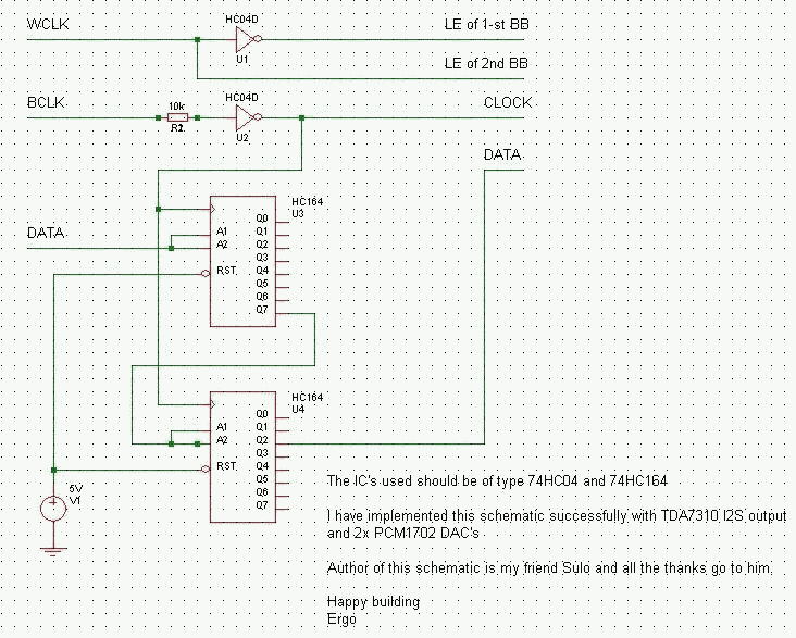

Want to try to connect PCM56 dacs on I2S because of a comment of Bernard, he stated PCM56 is better sounding dac in NONOS compared to TDA1541, so i wanted to figure out it is.
I tried before a TDA1541A in nonos, connected it right on SAA7210. For Tent's XO or Kwak clock 7. For I/V tried Rbroertjes simple I/V, posted long time ago here.
My findings on 1541 nonos: sounding very direct, sometimes "a bit harsch" and treble had some roll-off. Music perceiving is as sitting direct with your behinds on the dac itself, the "curtain" over the speakers is gone. But with long time listening it fatigues me.
Yesterday i had some succes, connected the PCM56 with this glue logic illustrated below, its designed for I2S to 20bit PCM1702. I/V is Pedja Rogic's AD844 stage and 6.8 AudynCap MKP's to RCA. I/V is without the fet circuit because the PCM has no offset as 1541 has. I asked Pedja on this.
But i heard digital noise with the music. When Data line is connected on Q6 instead of Q2, the noise is gone, only slight noise on one channel. For PCM data has te be delayed 15 clockcycles.
I figured out why and try a solution (delaying LE line of upper dac with some logic)
This what i concluded first on sound of it:
Very Nonos-like, mids are slightly distorted, think when i listen to it for 2 hours will get fatigued of it (as single 1541 nonos btw) Have to adjust MSB @ -80 dB, but don't think will help much.
And later on the evening:
After listening to it the whole evening i discovered this PCM56 sounds in Nonos better then a TDA1541, so you are right Bernard! The "curtain" is gone but then clearer sound, roll-off of treble is more obvious as with 1541.
Why not another glue logic scheme Rfbrw? :
This I2S scheme is simple which i like, only 3 logic chips used. Only disadvantage is the time delay between R-L, stopped clock schematics like on AN207's scheme doesn't have.
CDP is then as simple as can be: (Modded) CDM2 - HFgain - SAA7210 - I2S - glue logic - PCM56 - AD844 - MKP cap - RCA out.

Btw i suspect the lower dac Latches just one bit to early (gets LE direct, no delay of logic) and cuts in this way 1 bit subcode data in 16 bit audio data. Will add 2 cascaded inverters in that line and see what happens. Also could try faster 74/164's, is now 74LS164

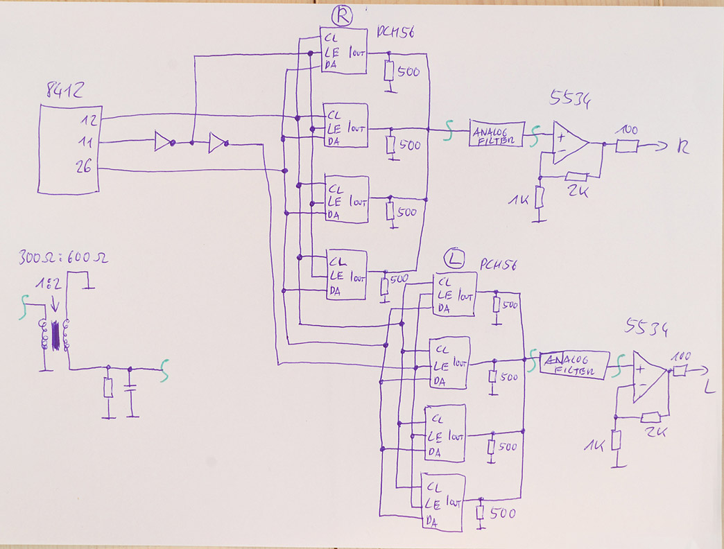

Hi Zoran,
I have no diagram as it always changes.
You can use this one and disconnect 9 from 10 and 11 from 13.
Below is my setup.
For 8412 and supply connections see upper schematic.
You can substitute analog filter with audio transformer.
Instead of n x 500 ohm parallel you can use 1 x 500/n ohm. for n DACs.
The MKP cap blocks 5mV, a value my tubed pre amp can handle imo, will try without cap.
There is no subcode in the audio datastream.
Hi Rfbrw.
Data from SAA7210 is 64 bit serial, 2 X 16 bit audio words and 2 X 16 bit subcode. As long as WS or LE signal latches dac's input register at the right moment, they will read & process the 16 bit audiodata.

I am at loss as to how you can possibly draw this conclusion . The datasheet clearly shows on page 9, 16 bit data with the LSB extended. There is nowhere for the subcode to go. Moreover, subcode data, SDAB, appears on pin 34 and subcode burst clock, SCAB, appears on pin 35. Lego make toys that are more complicated.

Still LE has to be at the right moment for PCM56: Latch must have a falling edge at the moment LSB has been put in dac's register. Thats imo the problem with 1 channel in my current setup, a small timing error.
A simple glue logic schematic is easy to alter, i am not waiting for a no-funtional logic schematic with a lot of chips for first experiments.

Did some research and indeed the data is audio from SAA7210, and subcode is available on other pin. Sorry for wrong comments here.
Tomorrow will try to solve some on the logic.
