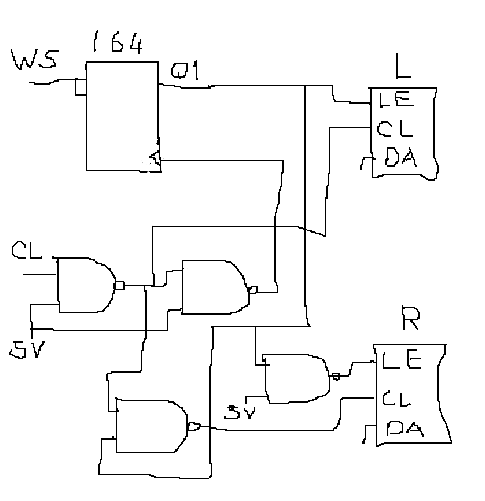

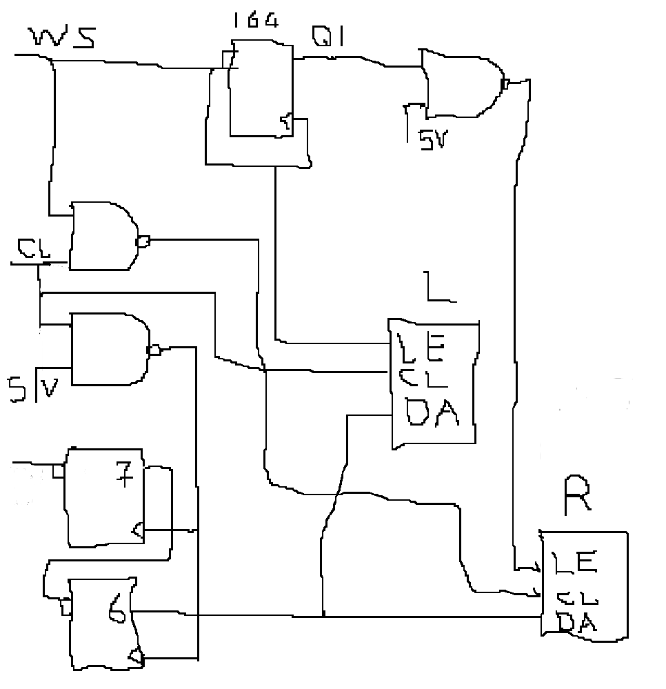

I2S to PCM 16 bit + stopped clock
Have figured it out with 1 NAND and 3 Shift registers
Correct me if i'm wrong, pneumatic schematic designing (in fact the same) was a very long time ago for me.
Cannot draw it, so will explain:
WS goes to AB from shiftreg. & shiftregisters clk input, from Q1 to A of 1st NAND, B on +5V, output to LE PCM56 Right.
WS goes also into A of 2nd NAND, CLK in B, output is stopped clock to Clock PCM56 Left.
WS also to LE PCM56 Left
CLK goes direct to CLK PCM56 Left.
CLK also goes into A from 3rd NAND, B +5V, output is inverted clock for 2 DATA Shift registers.
DATA to AB 2nd shiftregister Q7 to AB 3rd shiftregister, Q6 is 15 bits shifted DATA to both PCM's
Will post a gif soon(no drawing program)

Do they work ?
Big question for me too.
Have to buy a NAND first. All parts shops near me have discontinued.
Can't spice it anymore either. Had Pads, the learning curve of getting used to it is problably a lot longer then self drawing and edging of PCB's
But what do you think of them Rfbrw?
The 2nd simple I2S schematic doesn't work. Realised it when i was bicycling. LE has to be simultane, now it isn't
They are more than a little difficult to understand. I can't make out what you are trying to do. I can definitely see no trace of AN207 or any other working schematic I can think of.
