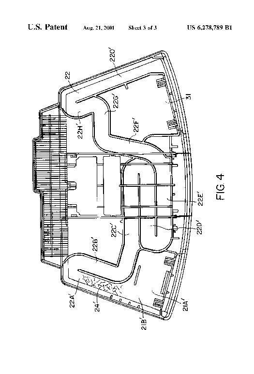

Couple of Bose patents. First, what looks like his latest version of his radio.
Note the patent number if you want details at the US Patent Office website. Don't forget to download one of their image viewers. IE 5 will drive you nuts trying to download one of them.
21A is where the speaker goes. 24 is the polyester stuffing the Line is stuffed with. I think 31 is where the other speaker is mounted, and the same thing is repeated beneath this drawing-two levels, as it were.

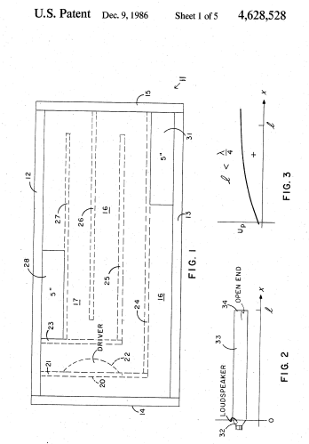

Now this might be for the thing you might think is the "Cannon". From the patent itself:
"United States Patent 4,628,528
Bose , et al. December 9, 1986
Pressure wave transducing
Abstract
A loudspeaker driver has its front surface adjacent one end of a low loss acoustic waveguide and its rear surface adjacent to one end of a second acoustic waveguide that is one third the length of the first. The other openings of the waveguides face air and couple acoustical energy substantially uniformly over a relatively broad range of frequencies extenting into the bass frequency region. An equalizer includes a notch filter so that the frequency response of the equalizer below a bass cutoff frequency is sufficiently low to prevent audible distortion."
I think the long tube is between 1/4 and 1/2 the wavelength of the F3 frequency aimed for, and the short tube behind is 1/3 the length of the long tube. It might not be clear from ther illustration, but both ends are open to the air.

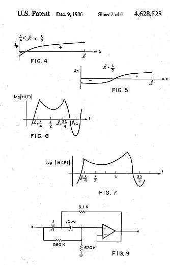

Here is another page from the patent. Again, note the patent number. There does indeed seem to be an equalizer involved, which schematic is included below.

Re eq, it looks like it's only a bandpass cct to stop really low end from overdriving the unit and a lowpass to tailor it into a system. Pretty much the same as any sub amp I've ever seen. Nothing new there.
Personally I think the long straight pipe is better than the labyrinthine version and the wave radio may well be stretching the physics to near breaking point. IMO Bose have always been pretty heavy on the EQ to try and get the response that is quoted. (Look at the output from a 901 equaliser) (Eeeuurrkk!)
A driver with pipes on either side with one that's 3 times longer than the other corresponds with my call of earlier that you put the driver 1/4 of the way along the 6m tube. Just a different way of saying the same thing. 3/4 is 3 times as long as 1/4.

The filter shown is of course a very ordinary Sallen-Key 2nd order highpass filter ( i.e. for subsonic protection).

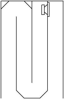

This is what I meant when I was talking about more elegant foldings. The length ratio is also 1:3 (i.e. driver moved in by 1/4 of the total line-lenght) as with the straight wave cannon.
It needs less space than a straight wave cannon but has less bends than the labyrinth proposed in the B@£& patent.
I have never tried it myself though I was interested in this woofer principle some years ago. This was the folding i wanted to use back then.
Although I think a straight cannon would work better if you have the space for it.

Remember the graph of response in the Bose patent? I'm thinking that a 12 foot pipe will place the lower of the 2 peaks at just below 50Hz (possibly 45). If that's the case then your 80hz xo is likely missing the upper of the 2 peaks.

Perhaps that line from the patent, "The free air resonant frequency of the loudspeaker driver may be chosen to be that at which the length of the longer of the tubes is a half wavelength" might mean that it should be at least twice the wavelength of the longer tube, in which case the speaker with the Fs = 19 Hz might be fine.
The diameter of the tube also affects frequency response. I mentioned the ratio of the area of the tube to tarea of the cone as being perhaps 2/3 to 1/2. This is from the patent:
"For a given ratio of (B1).sup.2 /R.sub.e the ratio of tube to cone areas (ATCR) typically controls the size of the system response peaks at the frequencies where the tube length is an odd multiple of a quarter wavelength for a single tube. For some typical speakers and an ATCR of 1 these peaks are relatively large. For ATCR of 0.5, the system response is relatively smooth. For ATCR less than one half, system response decreases because the tube provides increased load on the loudspeaker cone."
A 12" louspeaker typically has a cone area of 86 sq. inches. An 8" tube has an area of 50 sq inches. That is 58% of the 12 incher's cone area. Perhaps putting an 8" tube sown each 12" tube, held in place by 2 12 inch round brackets, would smooth the response.
