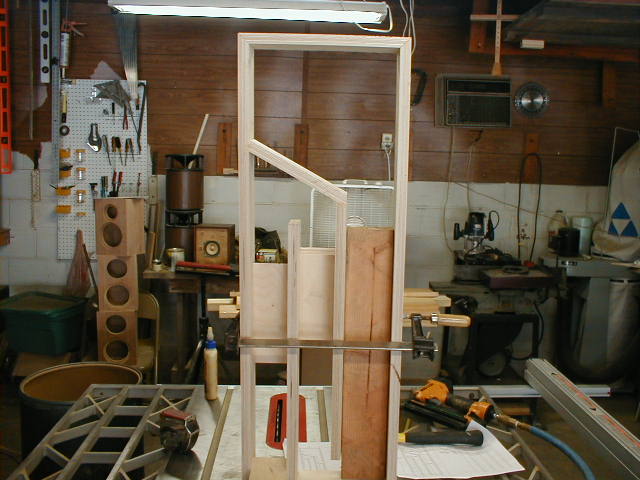

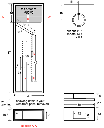

I am planning on building a pair of the Jordan JX92S TL speakers based off the reference design on the Jordan website:
http://www.ejjordan.co.uk/enclosures.html
It has the same exact external dimensions as the Konus Essence, but I have heard that the internals are different. Here is the picture of the internals of the Jordan V/TL reference design. The V/TL designation implies that if you make the dashed lines solid, it is a TL speaker design, and if you don't, then it is a vented speaker design. I am going to build a pair in a month or so, after I finish up some other projects. I got my drivers in the mail today. They are good looking.

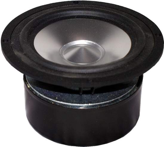

nice picture of the Jordan JX92S driver used in the Konus Essence:
specs:
http://www.ejjordan.co.uk/JX92.html

The JX92 is getting many, many accolades.
For a TL for these, i'd run some models using Martin King's software. The Jordan design (very similar to a Jordan-Watts design i did in 1976) seems a bit shy on box volume to get the most out of the driver.

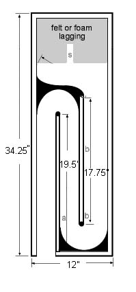

I to am planning on building a pair of the Jordan JX92S TL speakers based off the reference design on the Jordan website at some point.
One thing that can be done to improve the TL is to remove the sharp bands from the line. I have drawn a picture of the type of change I’m talking about. A very small compensation in volume may or may not be needed.
If as BrianGT says “the Essence is far, far superior” then I should very much like to know a little more about it. Perhaps someone who owns an Essence could with the aid of a mirror look up the transition line of the Essence to see if at least the last 1/3 of the tl is the same and report back on what they see.
