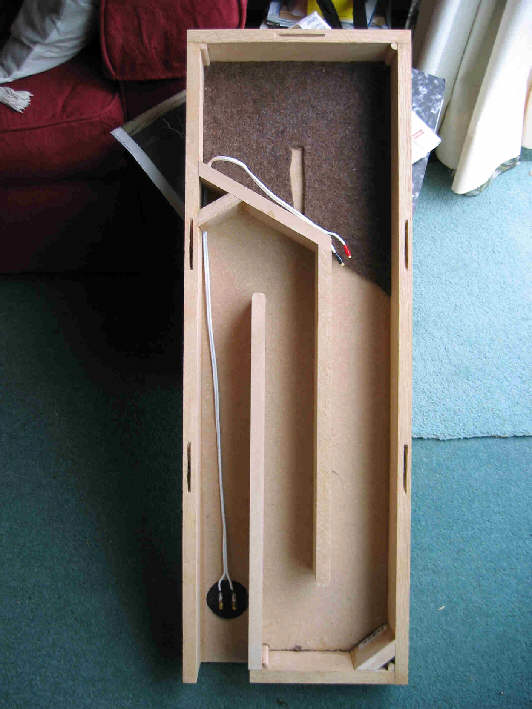

I hae built one set of Jordan TL speakers out of 18mm MDF with an additional 18mm pine front. The only thing that I changed on these speakers was the rounding off of all the transmission line corners including the exit. It was asked whether 18mm MDF was enough thickness. To me with the bracing of the tranmission line itself and the pine front, the speaker was extremely sturdy. I also used a little stuffing in the vent to remove the booming in the lower bass. About 100 hours of braking in the Jordan's and you have a wonderful full range speaker. They are very strong, especially in voice and jazz, blues, but not on heavy orchestra or heavy rock. I hope this will give you some info on the speakers.
Joe
Also built a pair of these exactly as JVA is describing, I also agree with him on the strong and weak points of the speaker. The only thing I would like to add is that they are a bit picky regarding placement. With a 30° toe in they sound absolutely marvelous.

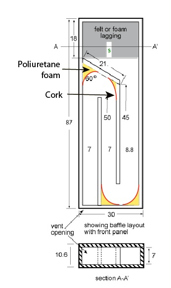

About rounding of the corners,did you make this as suggested in the picture (page 2,bottom) ?
How did you do it.
I was thinking of bending a thin MDF to make the shape and then fill the space behind with something.Should I use hard (polyester and sand mix) or absorbant material as rockwool to do this?
What do you think about rounding the corners with perforated sheet-metal or MDF and then filling them with something absorbant ? This way it may not be necessary to add stuffing to the pipe later.

I read one review of the DIY Konus essence and there was mentioned that maybe some stuffing added to the corners of the transmission line would help to the booming bass.That's where I got the idea.

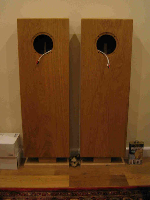

I built two Jordan transmission line speakers. I used MDF for the back and internals but used oak for the top, sides, front and base. I also put fillets at the bends of the line. I think the sound is excellent and is better than my small BBC monitors.

Hi James, thanks for your comment and pictures about your Jordan Transmission line design. It`s a great help for me and it confirm my idea to round the bends on the inside. It`s a good idea to use mdf in combination with oak. The oak looks very nice and solid. I will probably go for baltic birch or so. According to the hole size you used the jx92s on this. Maybe there are people who used other drivers for this design? Thanks James and as soon as i got results on my project i will place the pictures here.
I used the JX92S which I purchased directly from Mrs Jordan in Wales. http://www.ejjordan.co.uk/systems/jx92_system.html
The wood was roughly sawn timber 2.5mm thick which I planed down to thickness after roughly cutting to shape with an hand held circular saw. I then cut it to shape on the table saw at a woodwork club I attend for 4 hours a week.
My biggest difficulty was making the hole for the driver. I used a router with an home made wooden trammel and practised on a piece of pine before cutting the oak. I then made the recess with a recess bit in the router. I made the fronts slightly oversize and then planed them after the glue was set. I bought the terminals on ebay from the USA. My wood cost £90. You can buy complete kits from http://www.decibelhifi.com.au/prod146.htm at great expense,
